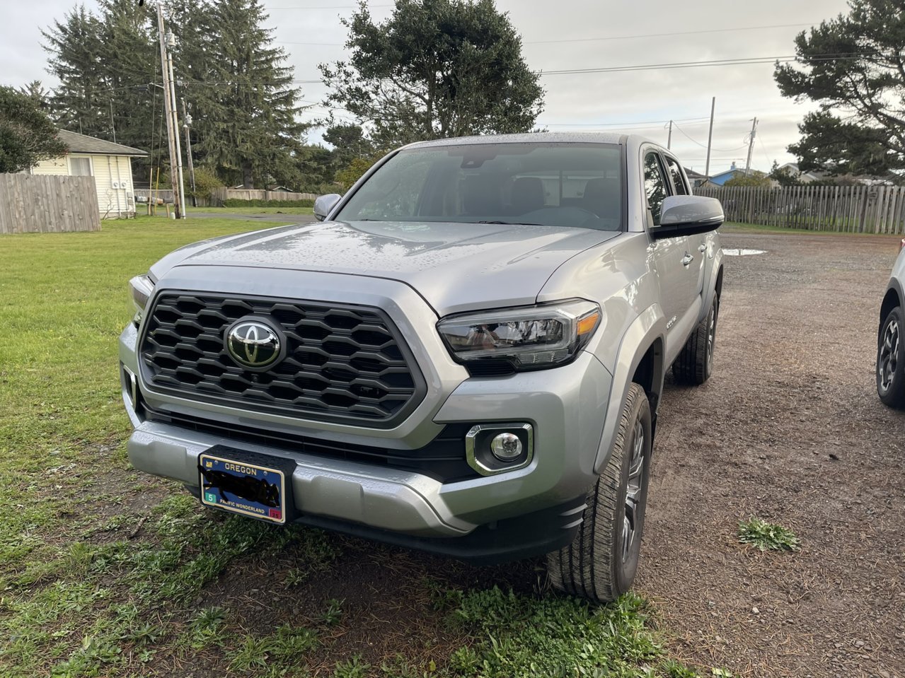

    Does anyone else have an issue with the wireless charging cooking their phone?
    And thanks Toyota for putting the ugliest grill on your most expensive truck, and making sure we can’t swap it out, oh dynamic cruise control radar sh*t

    According to dealers it will not be comparable with limited edition dynamic cruise radar, called more then one and spoke to techs. It is something they get calls on a lot, cause they put the ugliest grill they could find on it
    Tried the TRD pro grille, not workin with this truck, and can’t order nightshade grille yet. Breaking out the rattle can

    You 100% can swap grilles. There are multiple trims with radar cruise control. Pro Grill, SR grille, SR5 grille, TRD grille (not to mention compatible aftermarket grilles)... they are all compatible, as long as it came off of a +2020 truck. The dealer is wrong...

    It'll be fine. You can swap grills; just make sure the grill is from a truck that has radar cruise. The cruise control is the same between the models with radar cruise. I have a 20 OR grill on my 19. You unbolt your stock radar sensor and bolt it to the new grill. Real quick and easy to do.

    Dealer is wrong, Source; I worked at a dealer and we put a Pro grill on a limited for a customer.

    So the powers that be, were correct
    Put a 2021 sport grill on my limited
    When buying or swapping grill, make sure your grill comes with front camera mount since you can’t buy individually
    Also changed to color matching mirror covers
    Sport grill looks nice on the silver
