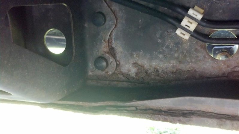

    I'm finding it near my cat and muffler the most. The area near the muffler being the worst.

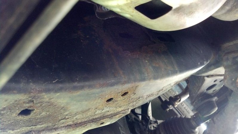

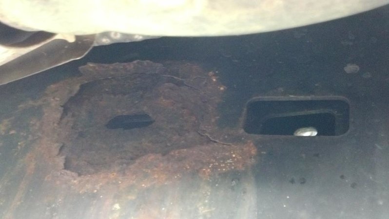

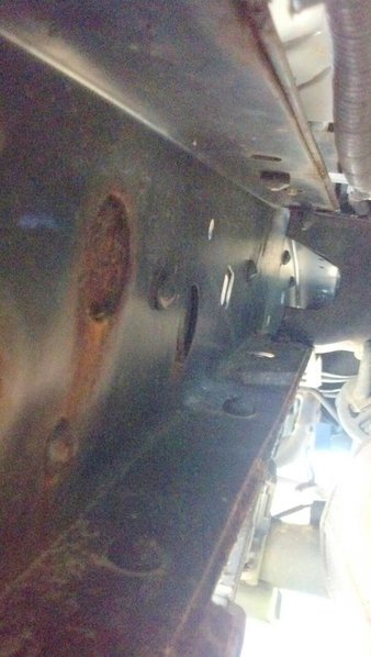

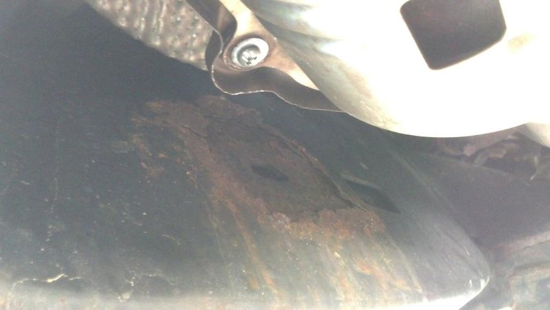

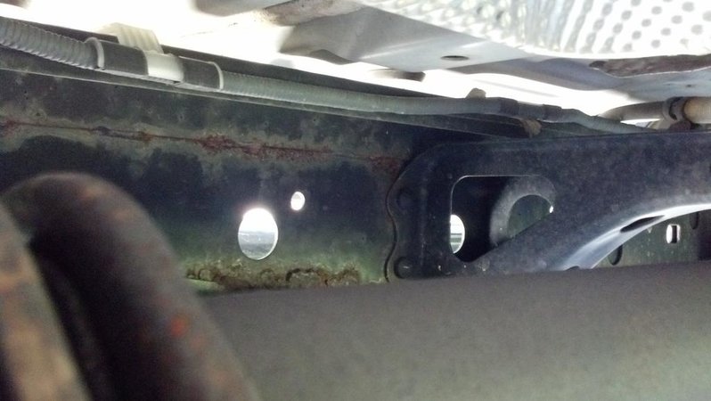

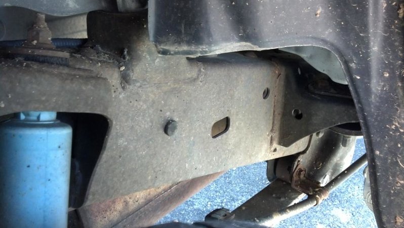

    What do you guys think? New Frame or coating... 05 DC off road, pa/nj truck. Glad i found this, just about to try and slow it down with some por15

    At first looking at your pictures, I would think you would just get the under coat. But the later pictures showed a hole that is not supposed to be there. :eek: So you should get a new frame.

    It looks like a hole in the second to last picture. It's my understanding any perforation means a new frame.

    yeah i thought for an 05 the frame was in ok condition other than that one spot. Wouldn't hurt my feelings if Toyota put a new frame in.
