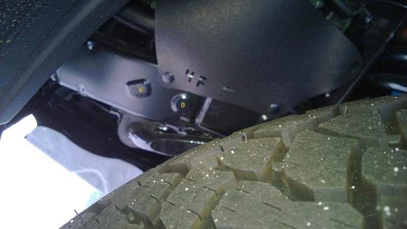

  18. Jun 24, 2014 at 2:27 PM
    #258
    vram74
    vram74 Well-Known Member
    May 18, 2014
    #130059
    407
    05 Prerunner SR5
    Stopped by dealership today and looked in the wheel wells of a couple of 2014's. Each front wheel well use 3x #4 plugs, 1x #6 plug and 1x #0 plug. The rear wells had no plugs in either truck. Those plug numbers are what is stamped on each plug. Unfortunately, those numbers do not correspond to anything on the PDF part order list I posted. You just have to measure the hole and hope you ordered the correct ones. All of this info is assuming they didn't change anything from 05 to 14.
    @tacoma4
    Plug part ending in 1992 isn't one of the front well plugs, sorry.
