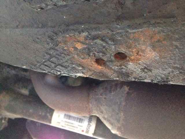

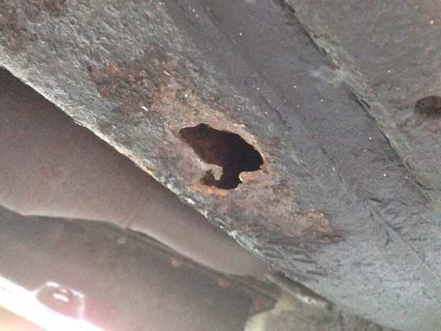

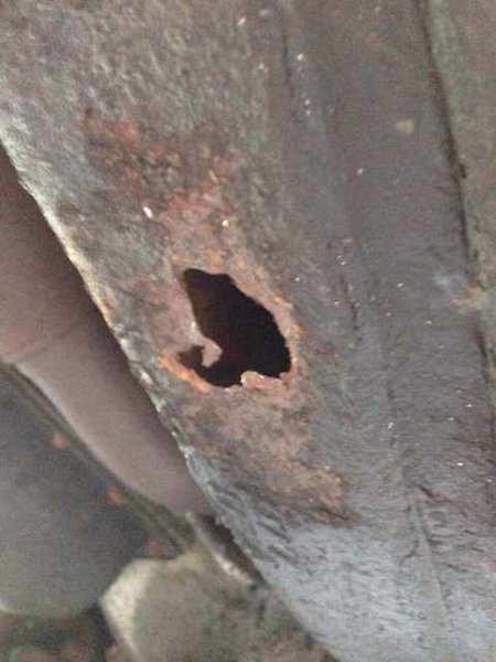

    O boy tacoma brothers! Went to put a set of steps on my truck that I bought from another TW member, and thought something look fishy, two taps with a hammer and this is what I'm left with. I'm in NJ how F@&ked am I

    Driver side
    Passenger

    NJ should be on the list for the LSC. From that size hole, you would get a new frame.

    Spoke with someone from toyota corporate for about an hour, they are having someone who deals with the frame replacements call me tomorrow. They also said to bring it to my dealer and ask for a loaner. We will see what the dealer says in the AM. NJ is on the list just not in that first batch, I hope with this I will be pushed up.

    Update: just got back from the dealership. They inspected my frame said that it should be covered under E0D replacement, but it is not in my area so it is now up to Toyota corporate. I will have to wait for the phone call from corporate later today or tomorrow.
    Not happy with what they wrote on the form it says that it appears to of been hit several times to check for perforation. That is not the case I put a screwdriver in the hole because something was hanging out of it, and the whole center between the two holes fell out. I hit it after the fact to see how bad it spread. I don't think it matters cause you should be able to tap your frame with a hammer without pieces falling off.

    I agree because they hit mine with a hammer when they inspected it for this! Regardless, there's a hole and you need it whole so they need to replace it regardless of a hammer hit or two.
