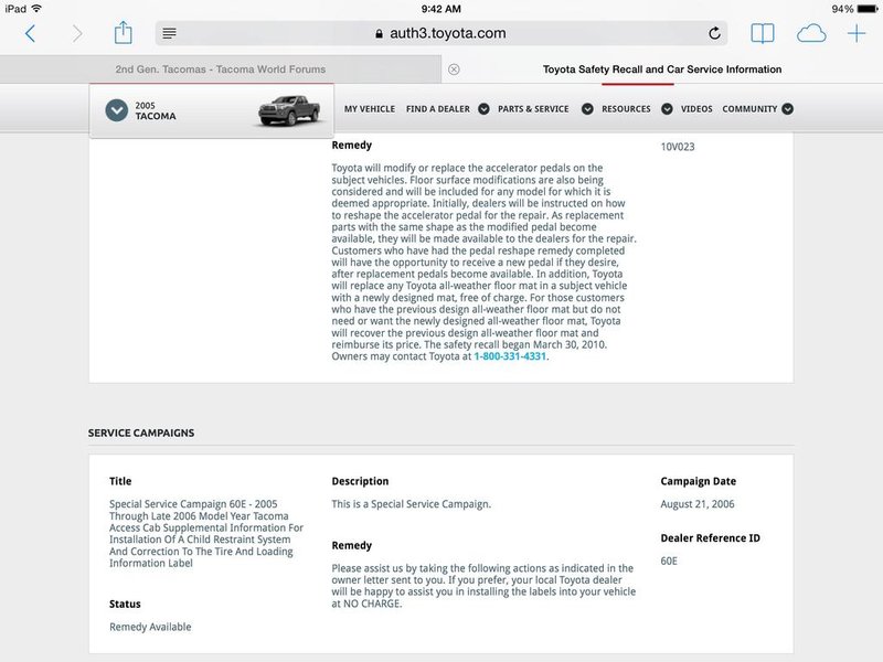

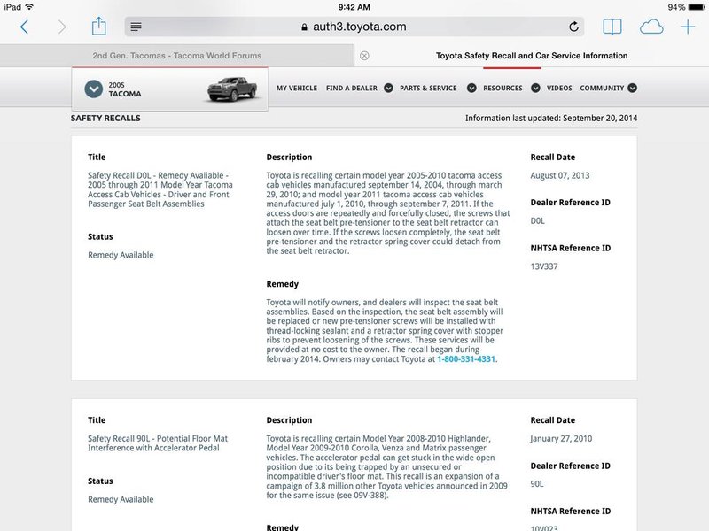

    Nothing for VA yet, checked this morning. Although I could be wrong, given that I called toyota and bitched about it, they probably excluded my VIN...

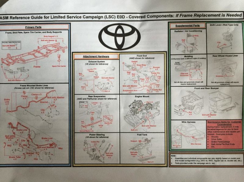

    So, my truck failed the frame inspection today. I was told I'll hear from corporate by Tuesday to approve the new frame. I was also told that the E0D didn't include new lca's or leaf springs. But, I think he is misinformed....he gave me this nice printout that shows they are to be replaced.
    So, here it is for everyone to print out & take with them if necessary.
  15. Sep 20, 2014 at 11:20 AM

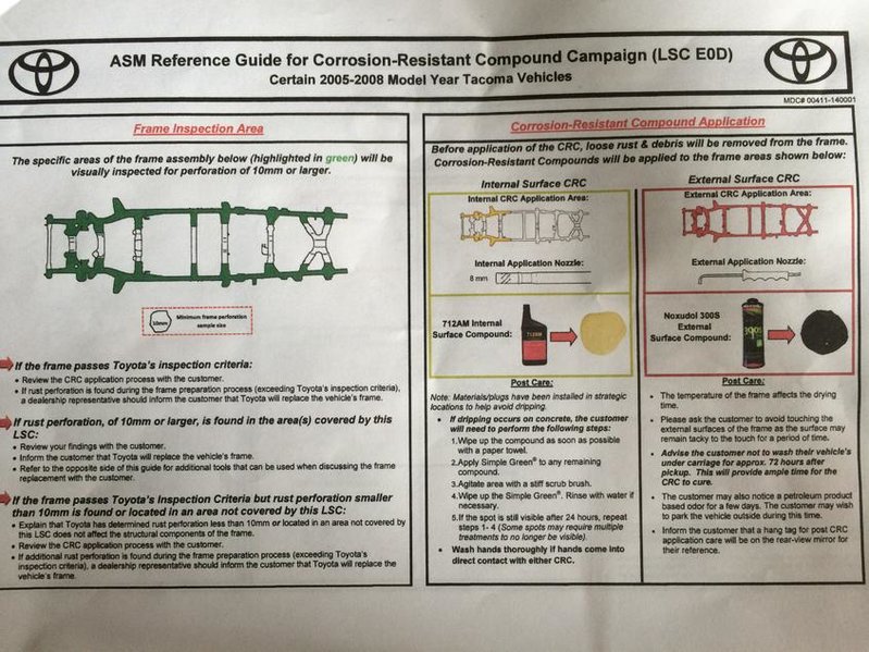

    Another pic. This one is about the CRC & application areas/methods
