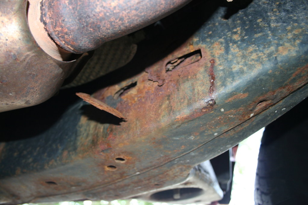

    I'd take it I'm getting a new frame based on this? Thought I only saw surface rust until I looked up next to the cat on the drivers side. I can pick pieces of the frame away from this spot.

    That is pretty close to what mine looked like (check pictures here), and they are replacing my frame. In fact, I think your frame looks a little worse than mine!
    I pretty sure the forward hole (the one on the right in the picture) it supposed to be there, but the rear one (left in picture) is not. If you look on the passenger's side, you may see similar deterioration. I don't quite have a hole on that side, but it is developing.
    Good luck!

    Ccarlson, I saw your pictures on the previous page and that's what got me to go look in that particular spot. Here I thought my frame was OK!
    I'm also going to get my 5100s and AAL installed while they have it ripped apart.
