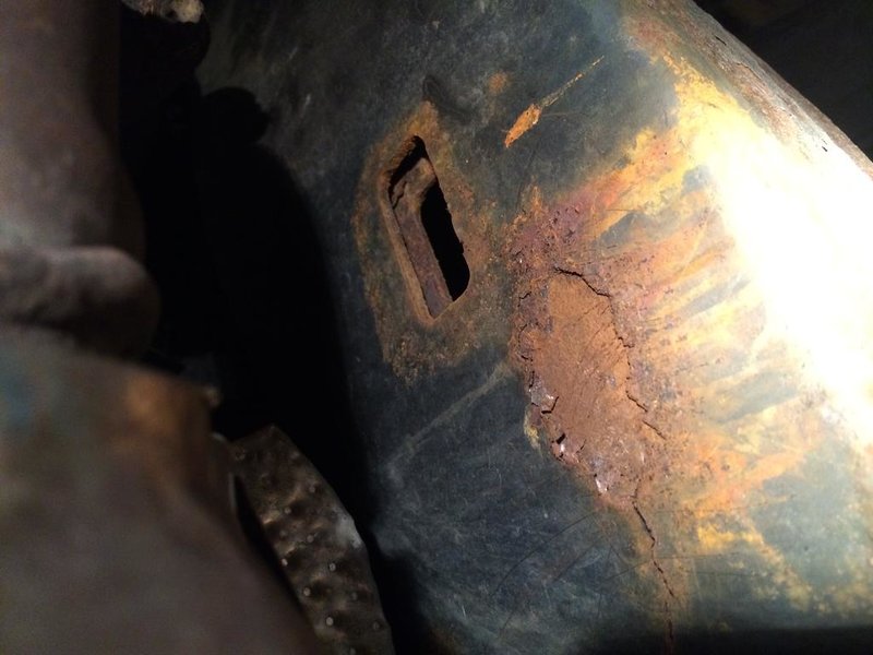

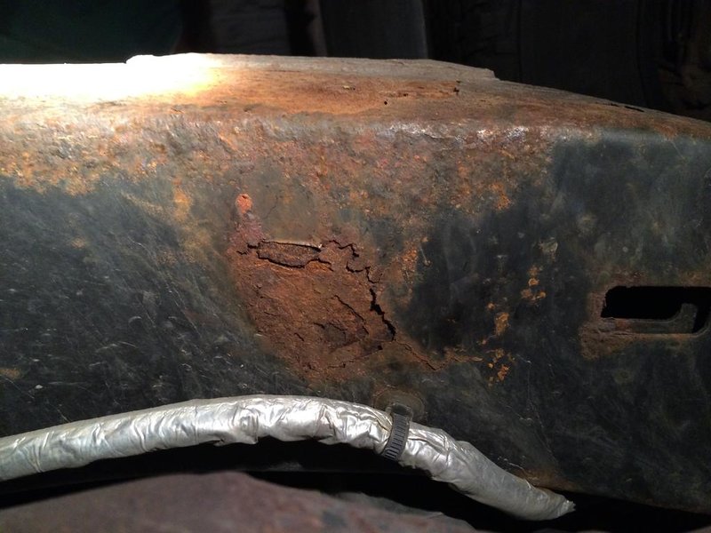

    sorry to hi-jack but its on topic so does anyone know/think if this would constitute a new frame? Took these last night after receiving my letter in the mail. Both areas by right and left cats.

    nad mmmm tacos!
    May 18, 2009
    #17388
    3,070
    Jordan
    Canada
    2014 Sierra All Terrain
    ya I would say so

    I will say yes, if I were you, before I would take it in for inspection I would take a hammer and bust thru the rust to make a visible hole. Your frame looks to be about to cave at the one rust point, if that is fact the rusted steel should just about fall out.

    I have only seen worse with full holes were mine is through the first layer and not through the second yet....and thats a big yet! It is def. soft when pushing my finger on it. 05' with 80,000

    This is EXACTLY what mine looks like right now, I hit it with a hammer, and it just isn't all the way through yet. I am going to hold off on taking it in for inspection since we have until 2016 for the replacement.

    New frame for sure.... I saw frames with a lot less in the pile.. Don't take no for an answer..
