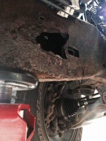

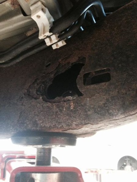

    So I got the "Limited Service Campaign" letter from Toyota last week and decided to inspect my Tacoma myself. Sure and behold 2 holes in my frame and it was deemed unsafe to drive. I dropped off my Tacoma and asked one of the techs in the back of the shop roughly how long it would take. He said he ordered a frame for one 4 months ago and still has not received it. I Then talked to my service adviser and he said once Toyota corporate gives the ok he will get the frame in 4-6 days and I should have the truck back in 2 weeks????? I then took it upon my self to go to the parts department in the same dealership and was told I would be lucky to get it in 2-4 months. I called about 20 dealerships around my area and they all said the same. After numerous searches on line I found out the there is a class action lawsuit about this very problem. I called Toyota corporate and the corporate service manager agreed that they have a problem and that there is no buy back program and to call there legal department and file a complaint. So in conclusion Toyota is going to put a $14,000 frame into a truck that is worth $15,000 and have me in a rental for 2-4 months and when I get my truck back I cannot trade it in because it has been flagged as a rust bucket. I AM DISGUSTED and going to take the advice of the Corporate service adviser.

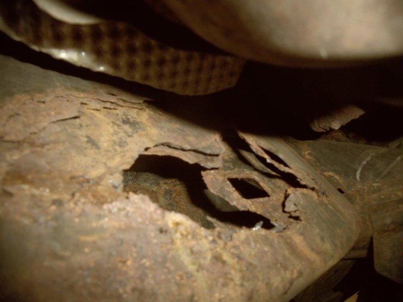

    photo 2.jpg I will be driving a 2014 corolla for the next couple months

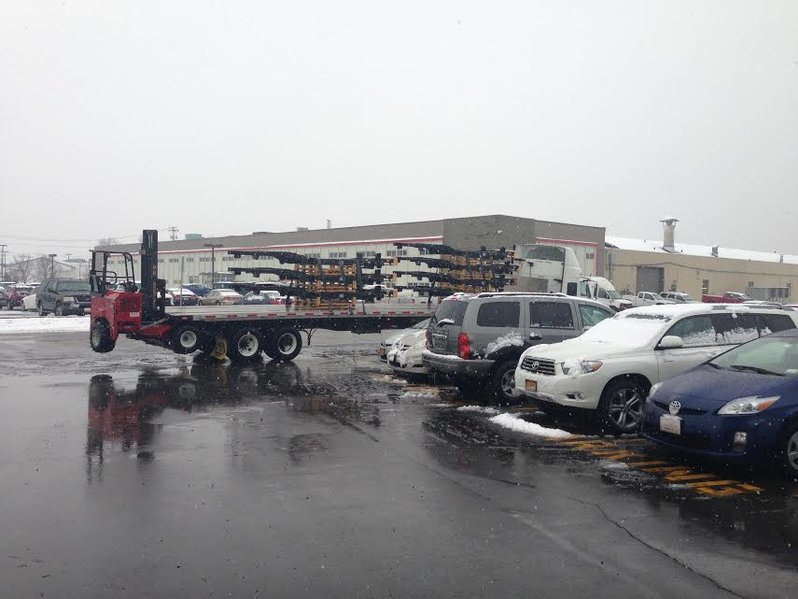

    Ok guys I stopped at the dealership last night to get a few things out of my truck that I did not want to wait the additional 10-12 weeks they had told me it was going to be.
    I feel a little better after talking with the service manager. He said the service advisor that had been giving me the run around wasn't working there anymore and they were still on schedule for the 8 weeks. Im on week 7 at this point and he said there was 3 frames that had showed up that day and there was a good chance one of them was mine, but he didn't know because they had not been received in yet.
    I got told most peoples frames are showing up in the 7-8 week time frame and its only 3-4 days for a few techs to do the work after they get it.
    Hopefully I will have my truck back in the next week or 2 !
    They had my truck at a offsite storage lot while they are waiting for the parts. It had over 50 tacomas in it! I wanted to take a picture but it was dark. They said they had another lot that was full that probably had another 100 trucks in it all waiting for frames/parts ! Crazy
