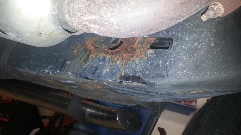

    Crawled underneath the truck yesterday to notice two new holes in my frame and the hole by the driver's side cat had grown to nearly 7.5 inches long. Have an appoint to get frame inspected Wednesday needless to say it needs a new frame

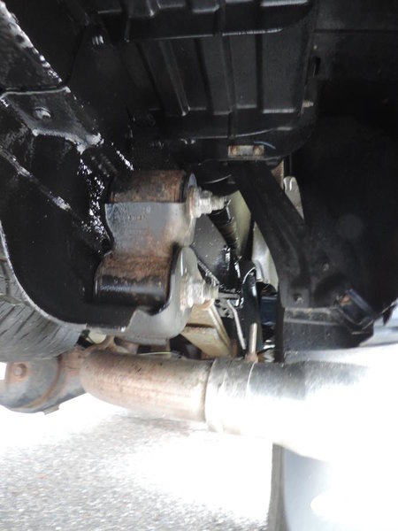

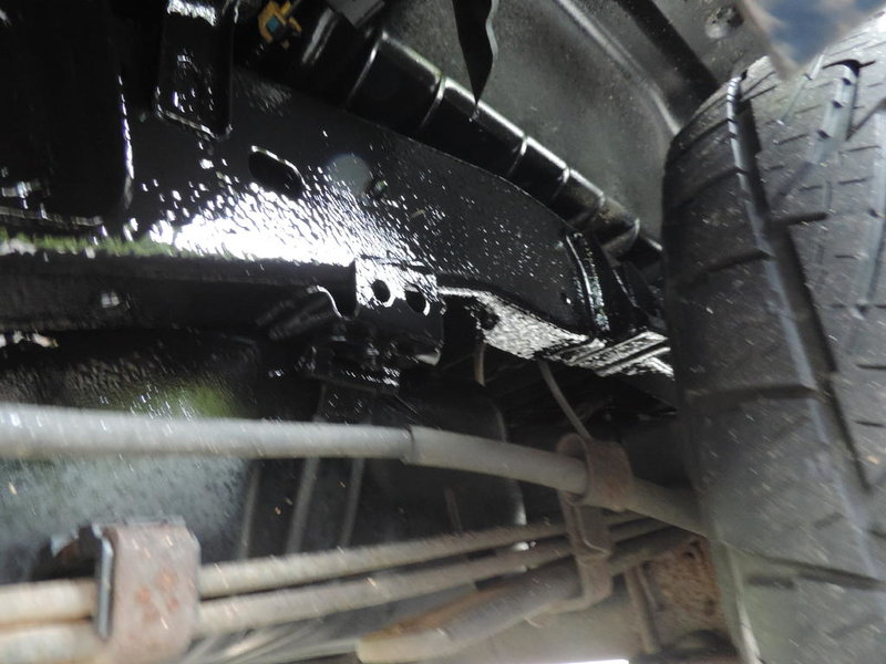

    just had mine coated, will pick it up later today. dealer told me they did find a minor rust spot and they would like to have me bring my truck back in 6months or so to check it. should the frame end up rusting they would replace it. didn't say if for as long as i own the vehicle or if just for the length of the recall notice, will ask today about that.

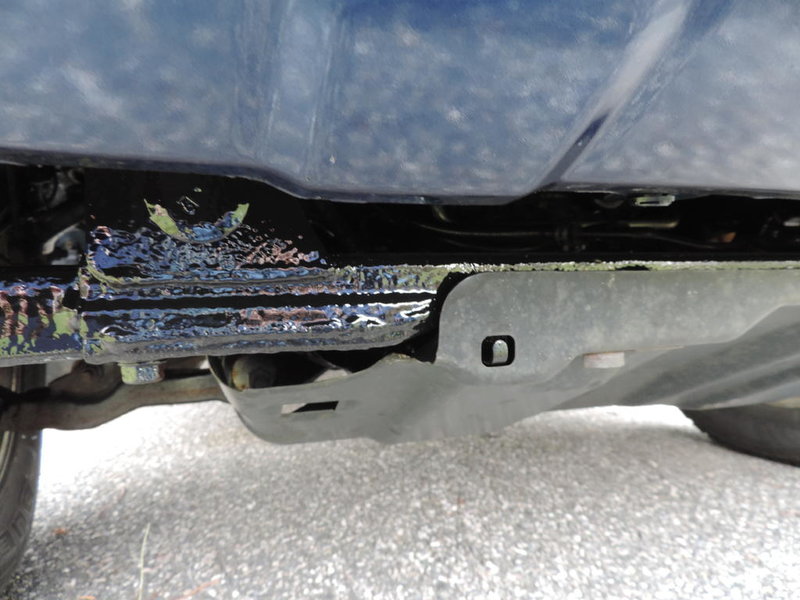

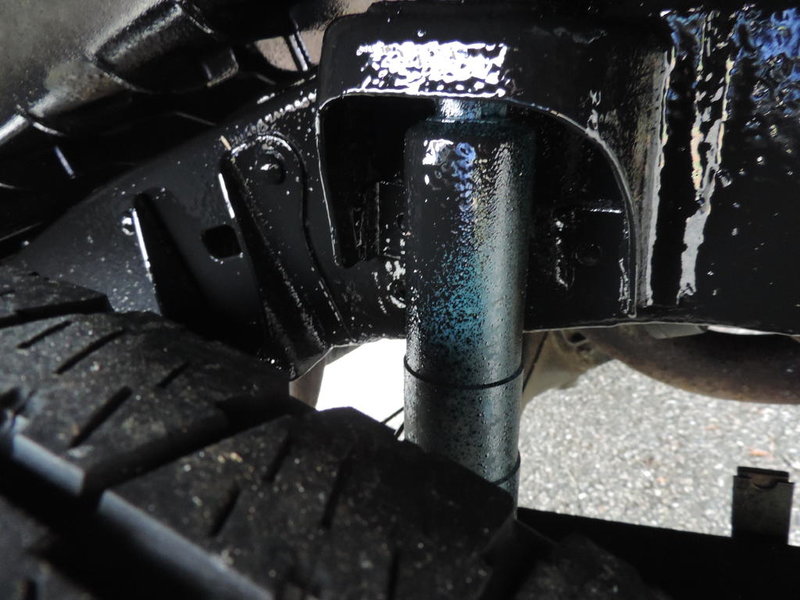

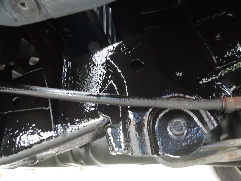

    Tried to take some pictures of the CRC coating, coating is still wet even after 24hrs. Think this is something that might be better done in the spring.
    UPDATED - BEWARE OF OVER SPRAY IT WAS RAINING SO TURN ON WINDSHIELD WIPERS ONLY TO SEE SOME BLACK STREAKS ON THE WINDSHIELD, IF ON THE WINDSHIELD THEN ON THE REST OF THE TRUCK:mad:
