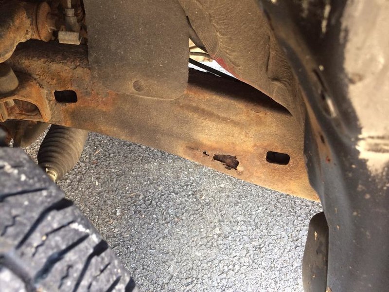

    I agree with BlueT. That's what is happening to my frame. The expanding rust is distorting the frame and reinforcement that is riveted to it.

    The issue is our frames rust from the inside out. No amount of prep or coating we apply will stop this.
    After seeing this thread, I just logged into my Owner page at Toyota and yes, I have the LSC posted under my truck. I'm going to make an appointment and get it looked at. I've been under my 2007 many times and my frame, so far, doesn't look bad at all. Some expected surface rust but... I cannot see between the layers. ;) FWIW, I don't wash mine often enough and I only use it when I cannot ride my FZ1 to work.... basically I'm a T.I.T.S. driver. Ha!

    I wonder when they will do this in WV. I looked under my truck today and she is rusting out right beside the catalytic converter on the driver side. So if the frame is rusted out badly enough that they can not repaint it they are going to replace the frame?

    They already replace 05+ frames at least in the northeast . :)

    Not this service campaign but a member of the last. Traded in my '03 last weekend after I stuck my finger thru the frame. It was coated by Toyota in '10 as part of the earlier rust campaign. You can see how well it worked. >roll eyes<
    Good news it they offered to replace the frame.

    Just rolled all around under it on the creeper and snapped a load of photos. Officially, the truck will be 8 yrs old in Sept. All miles put on in New England and mostly in winter. Outside of some expected surface rust, I can't find anything wrong with mine. Most of the finish is still on the frame and the surface rust is primarily at the welds. I'm betting they simply apply the chemicals and send me on my way. But I know if I DON'T get this done, then when trouble does appear later, they will do nothing because I didn't respond to this LSC. I think I'm luckier than most because it really looks good for its age.
