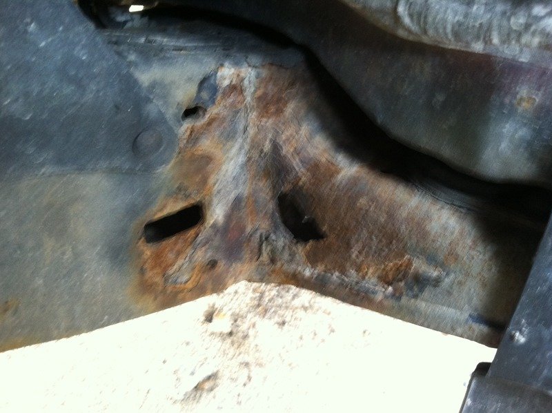

    i guess i should probably call the dealer now...

    its ok, i'm actually a little relieved to find the hole. my frame was looking so rough, i was worried they wouldnt find a hole when i took it in for inspection and i would just get the coating applied. a new frame might make me keep my truck for a little longer lol
