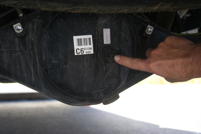

    You should have a sticker like this one:

    Or just jack the rear wheels up, put it in neutral and take the parking break off. Spin one side. If the other side spins the same direction you have mechanical LSD.

    Not an accurate way to tell. Ive had open diffs spin both sides the same direction.

    how is this easier than looking for the red/white sticker? ok, you may need to slide under with a rag to wipe off mud.
