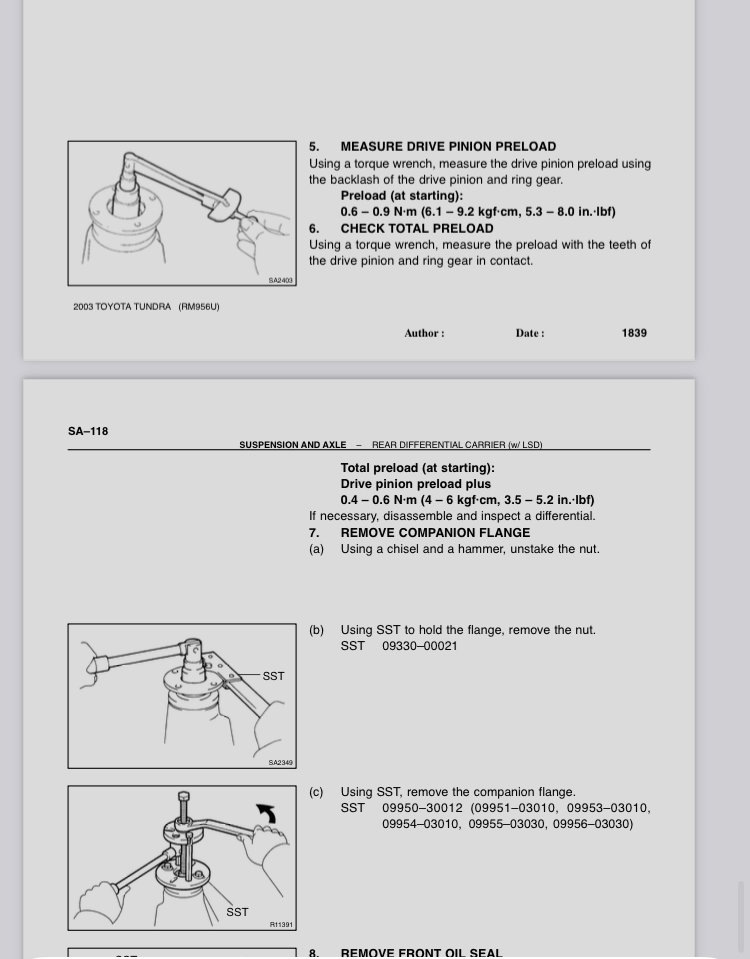

    No progress yet. I think I want to have a differential shop give the 3.73 a quick check before going through with putting it on. I did check the preload with an inch pound torque wrench, the starting (breakaway) torque was around 10 inch pounds, which seemed fine but maybe a bit high for a used diff? but yea I still feel like there is something up with it. It still feels like there is something a bit too notchy/bindy about how it turns. I’ll let y’all know if it works out.
    I also have a 4.08 open diff as a second option, it spins super smooth. It’s breakaway torque was only 2 inch pounds. Do the LSD units need/create a significantly higher preload?
    On another note, has anyone swapped the mechanical LSD into a (previously) open 8.4 diff? I feel like the 4.08 ratio open diff (49/12) is in good shape and might be a better ratio but I love the idea of having a mechanical LSD. I was curious about the possibility of swapping the mechanical LSD into that? I know the mechanical LSD only ever came with 3.73 and 3.91 ratios which both have smaller ring gears (41 and 43). So maybe there is would be an issue fitting it onto the 49 tooth ring gear? Not saying that would be easy or worth it, just curious.

    Keep in mind that the pre-load torque is usually specified as a rotational torque, not breakaway so you have to read it live.

    the only FSM I could find for the 8.4 diff with LSD was from a Tundra with the 3.91 LSD but I imagine it should be the same, the service manual shows “Preload at Starting” which I imagine is the breakaway torque?
