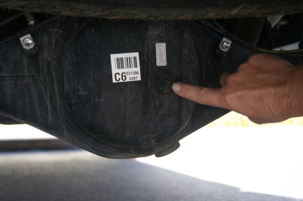

    If you go to the dealer to buy fluid be careful about what they recommend as some parts guys aren’t the best. I have a 2012 and he tried telling me I need the LSD fluid because the computer said I have an electronic lsd differential, which is different then a true lsd. Electronic lsd is controlled through the computer by using the brakes, and does not require the special lsd fluid, which from Toyota is twice as expensive as normal diff fluid. If you have this sticker above your fill plug then you have a lsd. Anything can happen, but I think the odds of the sticker coming off are slim. It looks like one of those aluminum sticker tabs.upload_2018-12-5_12-40-14.jpg

    Mobil 1 synthetic gear oil is rated for all differentials, including limited slip ones (which were ONLY in Sport TRDs fro 2005-2008).
