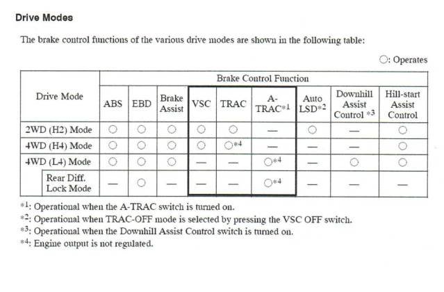

    4WD High TRAC in our 2010 is the same as AUTO LSD in 2WD, except on all 4 tires.
    It is how it is explained in the 2009 tech bulletins. Note the bottom chart in H4: *4 (Engine Output is not regulated)

    There is no throttle cut in H4 from 2009-2011 models... as it says in the chart, TRAC in H4 has no engine regulation. I have a 2010 Off Road, and it is amazing in H4 compared to my previous two Tacomas without the traction control. I feel no throttle control in H4 Trac, only in H2 Trac.
