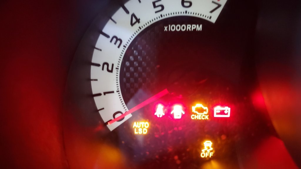

    2010 does not have a traditional limited slip diff, it has an ABS based limited slip (Auto LSD) that applies the brake to the slipping wheel. It is selected by pressing the VSC Off button once, the Auto LSD and Stability Control Off lights will come on.
