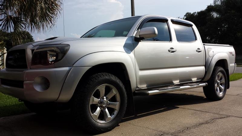

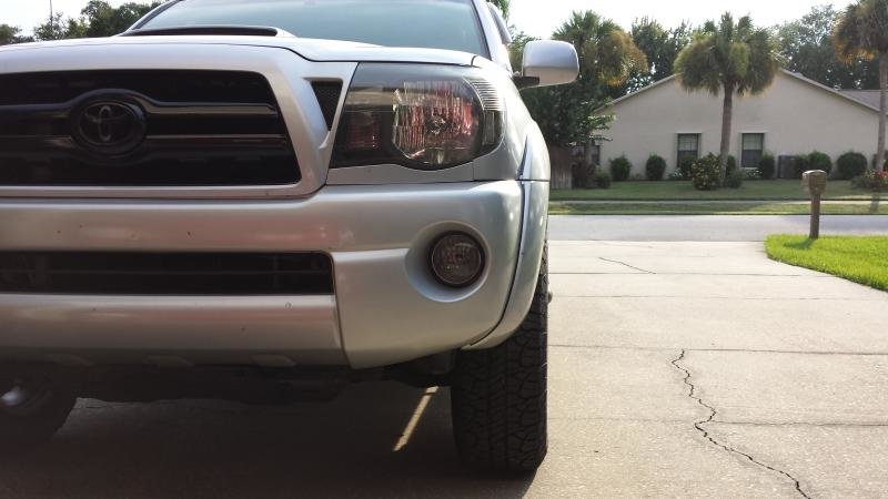

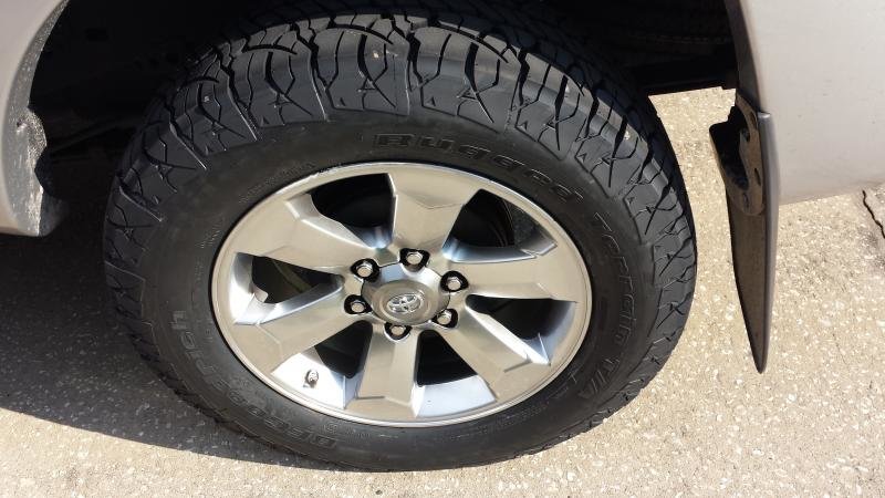

    I just did this two weeks ago. The 18's fit perfect and have just the right amount of poke compared to the stock wheels. I went with 265/60/18 BGF Rugged Terrain tires and love'em.

    SRT Nate: Thanks for the pics. Looks great. What is the best option for finding similar wheels and tires. Tampa Bay FL area would be an option as well as Detroit MI or Niagara Falls NY areas.
