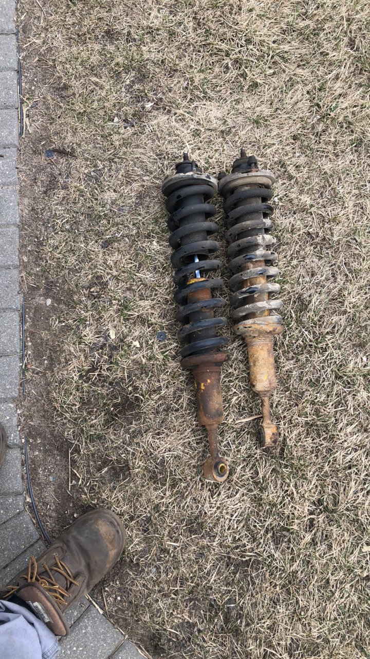

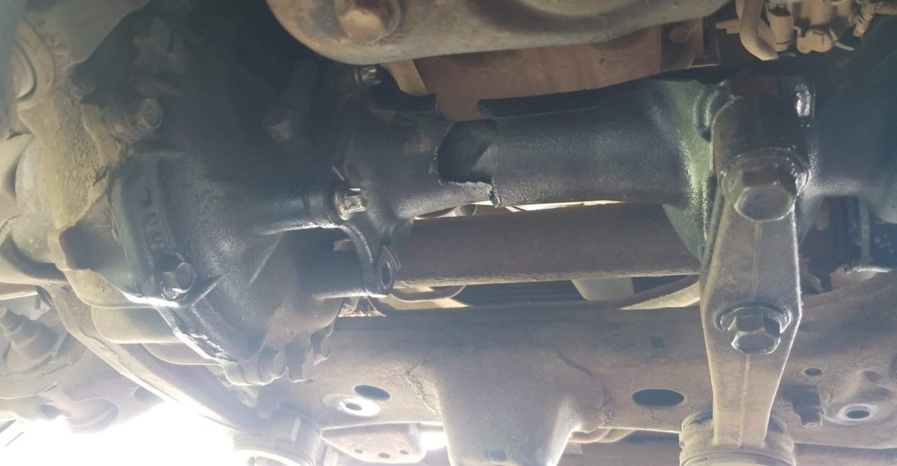

    So, big thread revival but here it is.

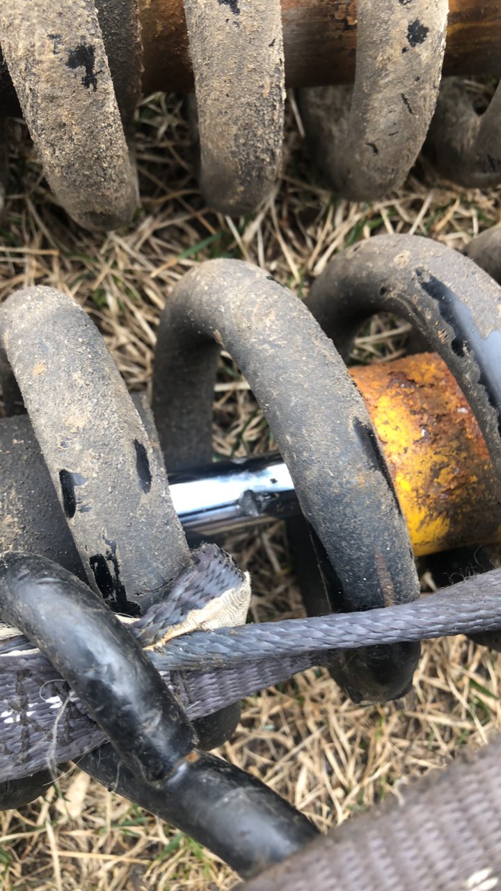

    I just had OME with 886’s and recently had a shock failure that lead to some expensive damage (could have been prevented with shock inspection and stuff but principal still stands)
    So the issue. In the picture you can see that one shock is close to 1.5” longer. To get these out the lca was almost straight up and down.
    This is the shaft where the internal limit portion broke.
    Now, yes I realize these shocks are old (100k kms) however I don’t believe this would have happened with limit straps. I don’t do any go fast stuff. All slow trails.
    If you aren’t running the sway bar, I think limit straps would be a good option to ensure you don’t droop too much and cause a cv to pop. Unfortunately I had my cv pop while climbing an obstacle and it torque loaded the diff tube.

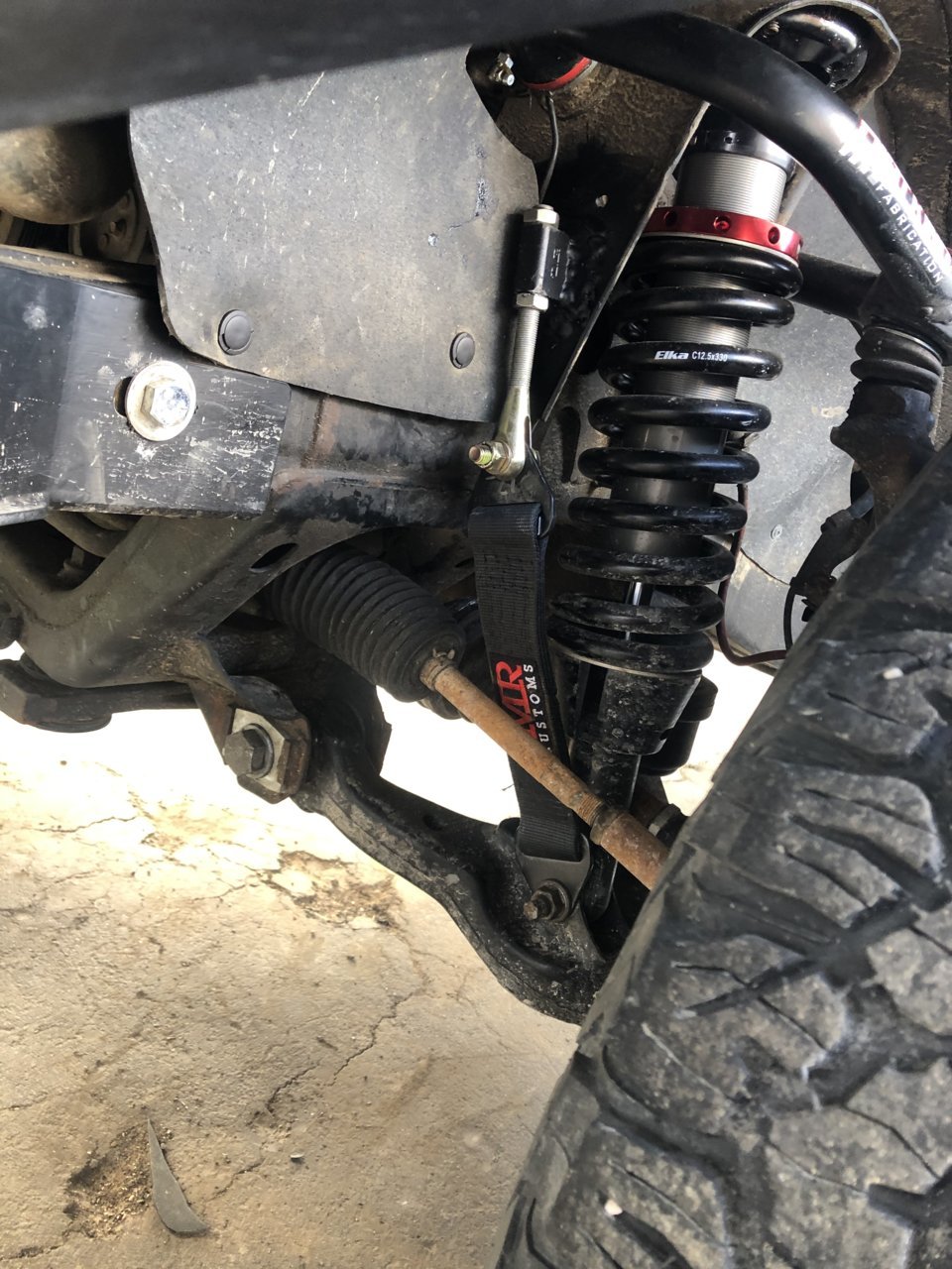

    I’ll be installing these with my new setup.
    Have 12” strap with the adjustable clevis. Will be going to the lower shock mount. Think 10” would have been better but it will work. Will weld the clevis to the shock tower.

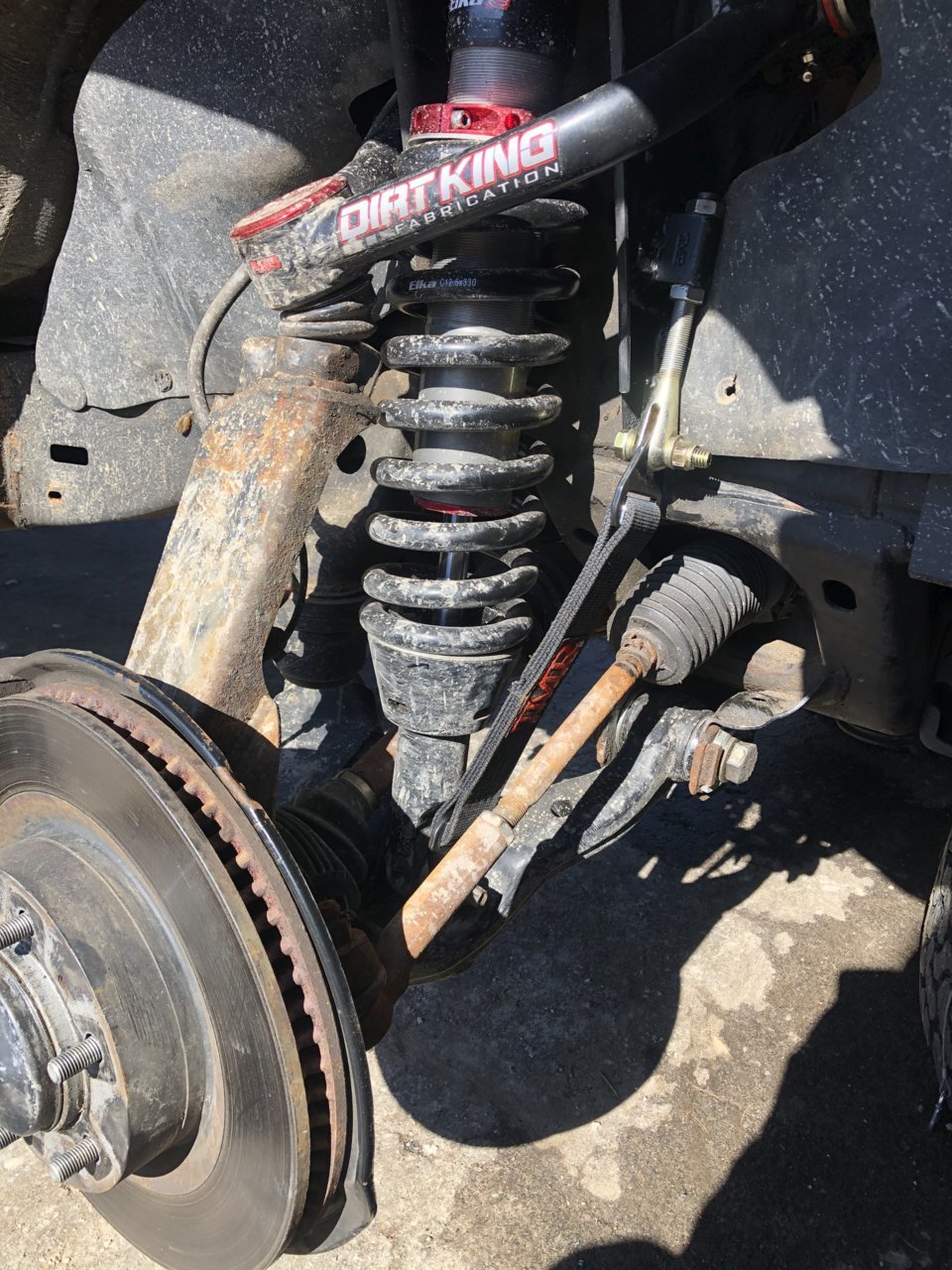

    And to add to this.
    677589D7-14AD-4C25-8912-BF918403ADB0.jpg 8285304A-9295-4404-A905-84EF7DA05951.jpg
    Will need to adjust the straps as these will stretch to 13”. Have plenty of room on the adjustable clevis to adjust for this.

    All of them.
    The angle on that upper mount might tug itself strait.

    Yeah it’s not ideal. Checked out some other ways people had there’s and a bit of an angle happens. Time will tell.

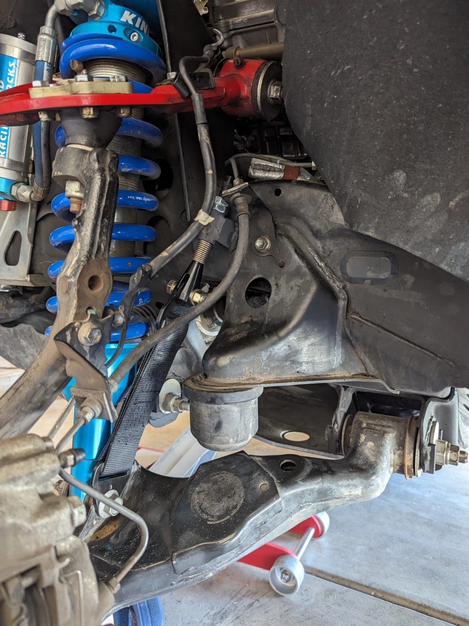

    Added driver side strap today then ran out of time. Will do passenger next week. Need an 8" strap instead of 9" to make it perfect. I used the stuff from Kartek, and cut down the clevis hardware to hold 1 strap instead of 3 so it's smaller and couldn't turn to hit the coil. The goal here is to get rid of the BANG sound/harshness/potential damage of the kings topping out when they do. One trick I did was use all thread to get the mount lined up perfectly for welding (see pic).
