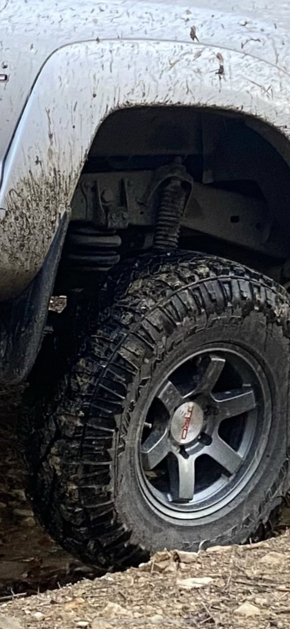

    You can see how the bag isn’t stretched when the suspension is flexed.

    No. The bag is bolted to the frame and the axle both. And if you don’t have a way to limit travel, the bag becomes the limiter.
