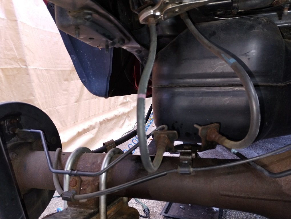

    I have a 2015 Tacoma TRD, I busted the rubber line on the right rear brake drum, it runs up to something under almost the center of the truck where the same rubber hose from the left brake drum also goes to. Will some one tell me what that line is please so I can order. I can’t seem to find a diagram that I can read that has it on there.
    Thanks in advance

    Does that rubber line run like the one on the right in the photo below?Rear Lines Before.jpg

    That sounds like the rear parking brake cable. Look through here and pick the cable that matches your config (AT/MT, double cab long bed vs short bed...) https://www.rockauto.com/en/catalog...44,brake+&+wheel+hub,parking+brake+cable,1696

    Everything works fine, the rubber coating is ripped open. ABS, Brake, and traction control (truck with squiggly lines behind it) lights are on.

    Now we're getting somewhere. Sounds like you ripped an ABS sensor wire
