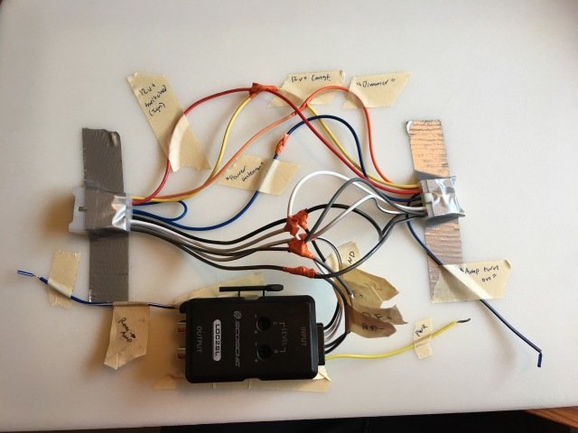

    Alright, I got my Metras, my LOC, and everything ready to splice up to get output to a sub amp as far as I can tell
    The final question: Where do I splice the LOC power in?
    "Amp turn on" seems to scream availability, but that wire is also free in the rear speaker part too???
    So 12v constant is always tempting (gotta love that yellow-yellow coding) buuuutt.....
    any pointers??

    For my LOC, I used a distribution block for power because I have 2 amps - so I have 1 power wire going to each amp and a power wire going to my LOC

    For LOC "power in" you can hook it to the trucks "accessory wire" (white w/green strip under the dash, left of the steering wheel, above and in front of the fuse box). I have the JBL system and wasn't able to locate a remote wire so I hooked the blue remote wire to the "accessory wire" also and added a switch (just in case i'm driving with the stereo off).
