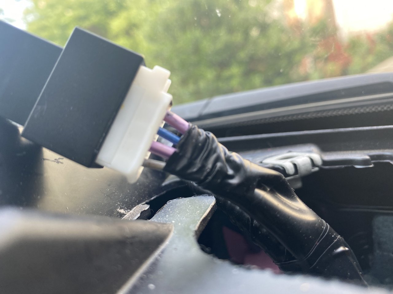

    I think I have the rear, fronts are killing me. How do I know which are negative and which are positive? I re-wired all the speakers (kickers) 16 gauge. The fronts are run parallel. I had sound from all at one point, but as I finished up it did not stay on. It is going to LC7i.
    Here is the right side front OEM…..

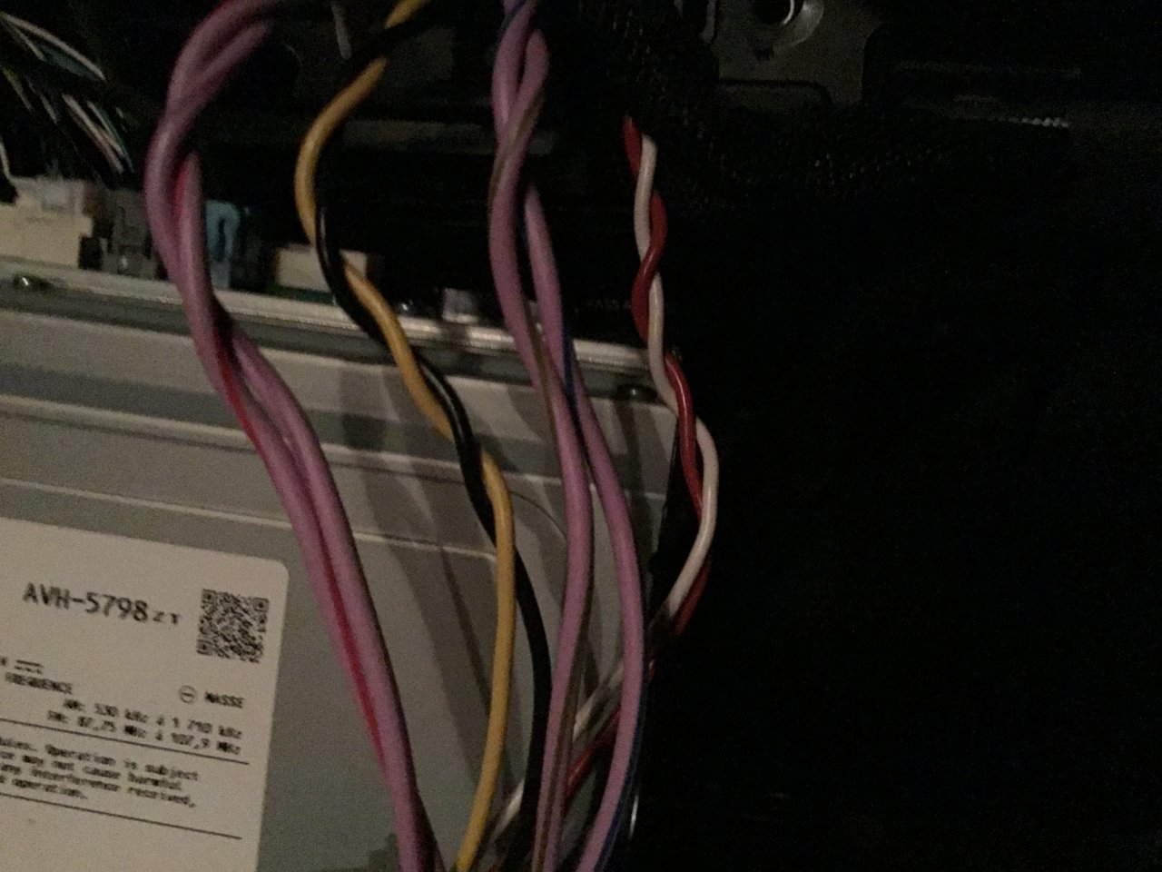

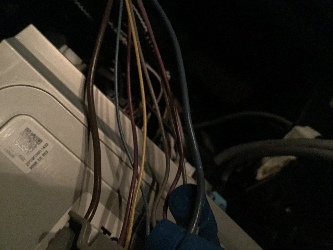

    Sorry the phot is a bit dark, my phot skills suck. The very right is blue, very left brown.
    I used the red as my remote, and also along with the white it pushes my right rear speaker. The yellow and black is my left rear. I thought the other 2 were the front but it is not working that way.

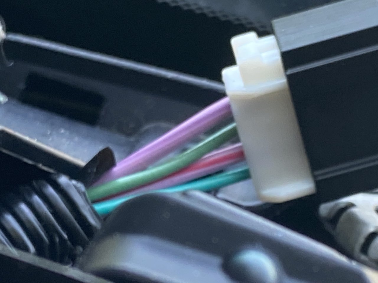

    Here is left front.

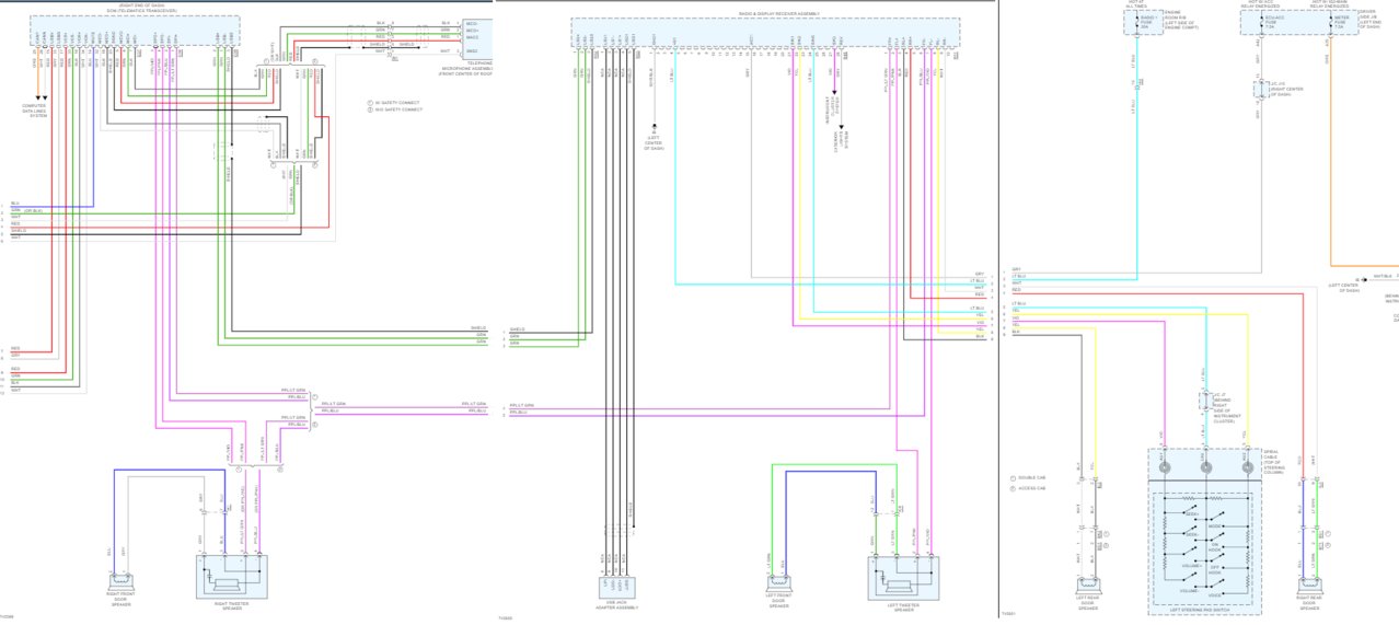

    To help all Gen 3 non-JBL I scored this from crutchfield.
    I am still having problems, so it may be in my speaker wiring to right front. My amp also keeps overheating, not sure why. Gains are turned down.
