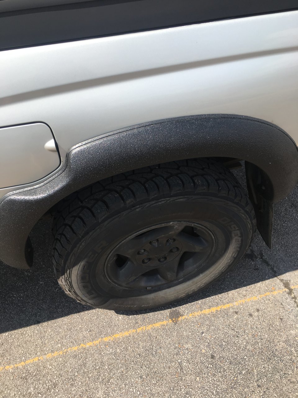

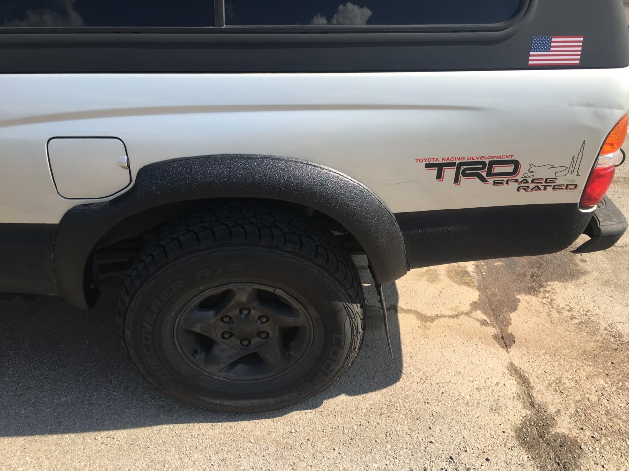

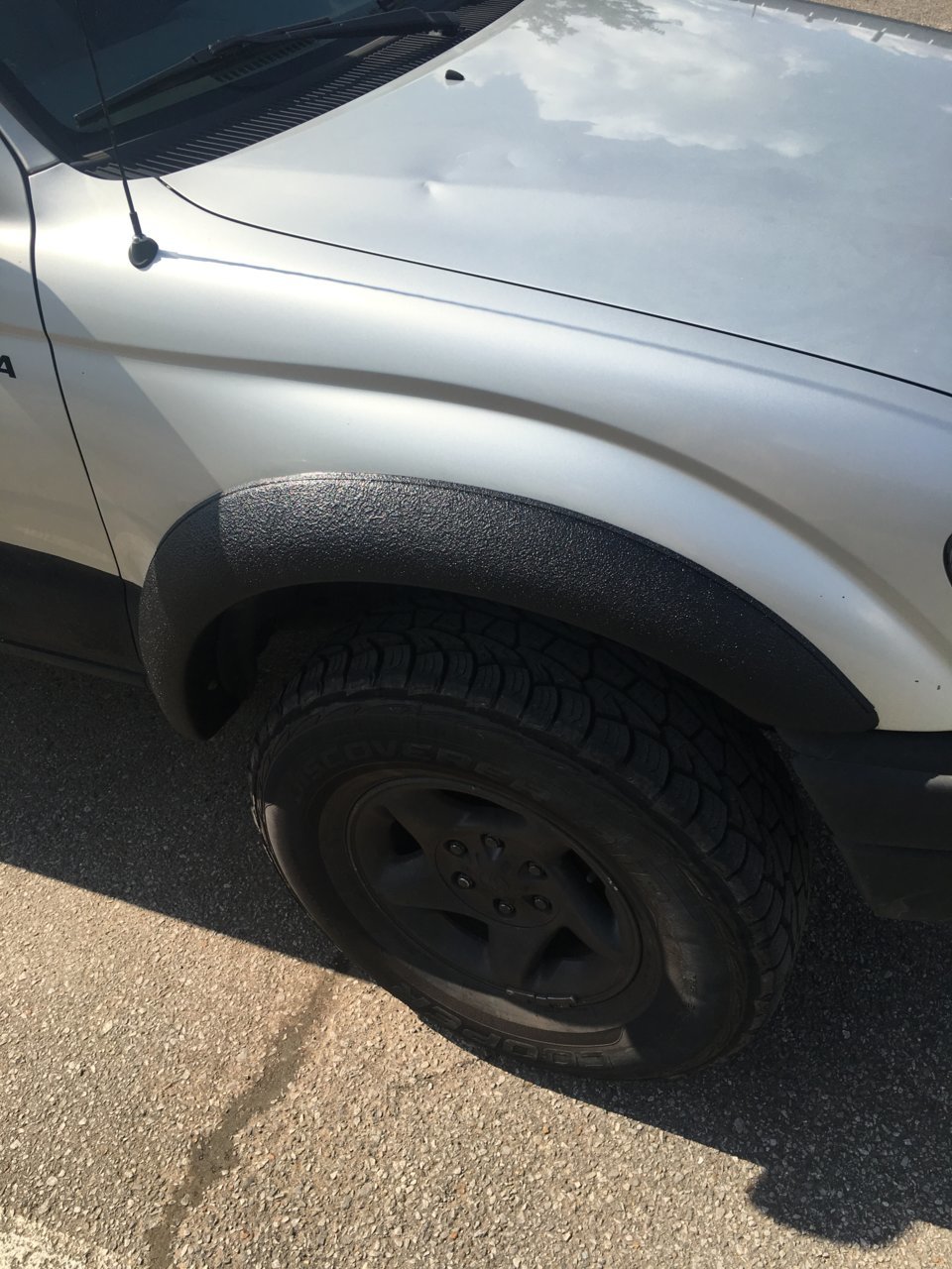

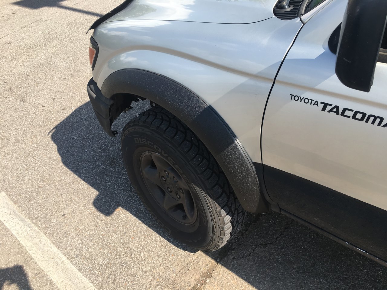

    Did mine with Herculiner this week. Used a Harbor Freight spray gun I already had that is made for textured paints and it worked like a charm. Took one coat and cost like 40$ between the Herculiner at Lowes and Xylene. I also put a clear coat on it in case it fades. Pics don't do it justice.
