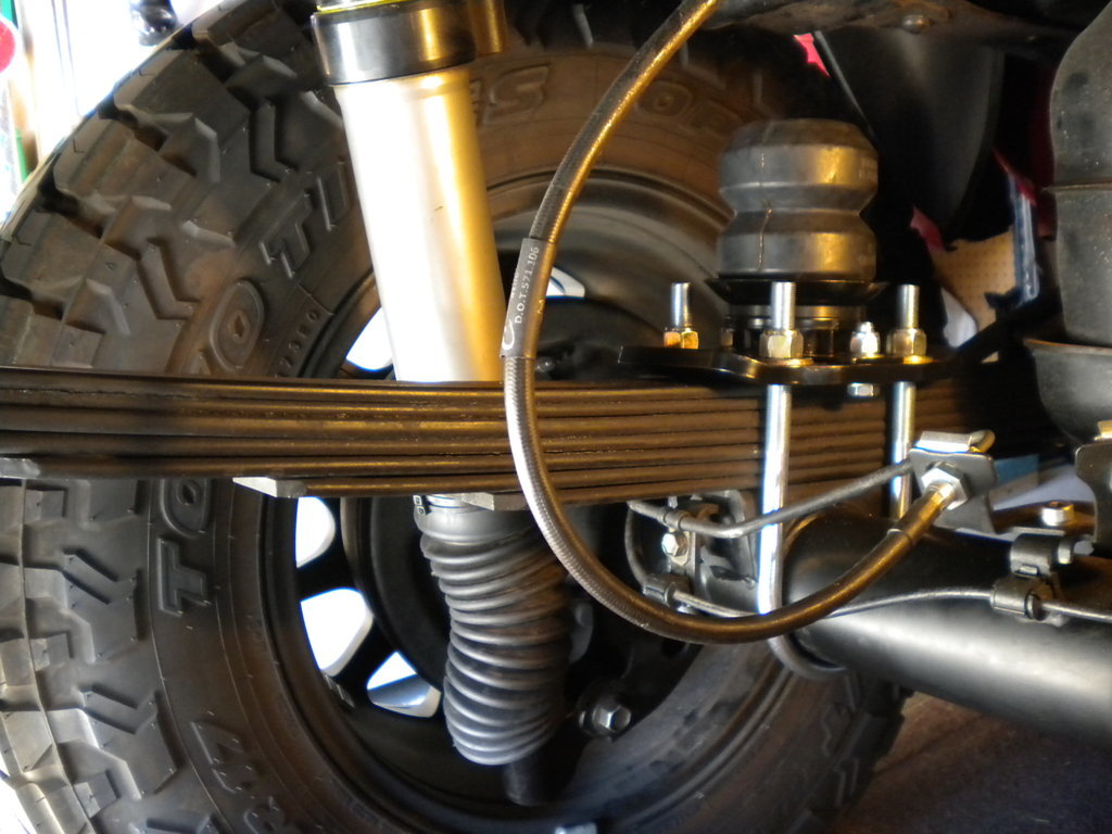

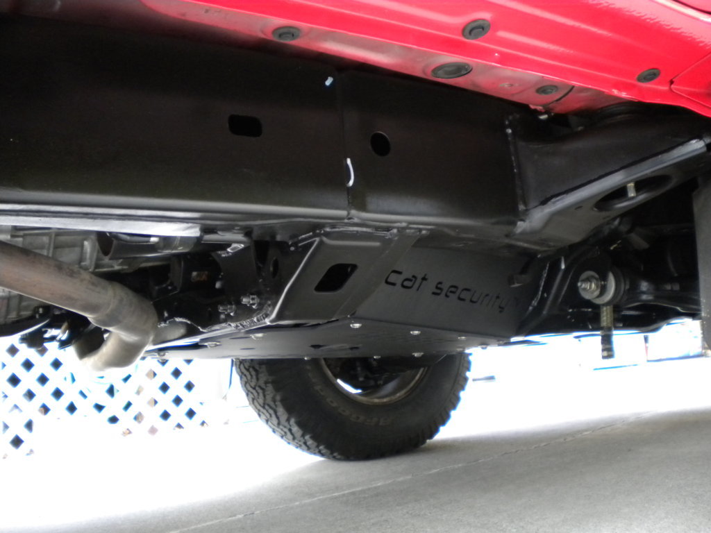

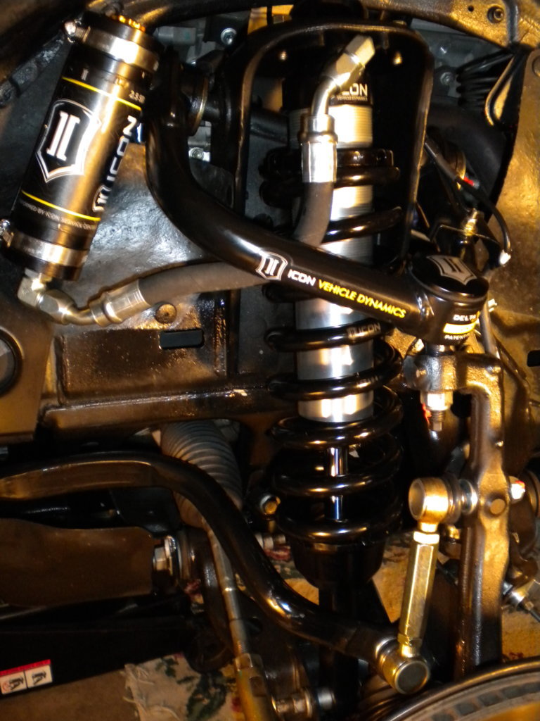

    I've done this on my 07 since new: Fluid Film on the frame/cross members, etc and Boeshield T-9 on suspension parts (less greasy, clear color, more of a waxy film that doesn't attract dirt/dust as much as FF.) Takes about a 1/2 hr to apply couple times a year with spray cans. After 18 years... original frame.

    Looks fantastic.

    Looks absolutely awesome. One important question though: Where are you located and how much salt does it actually see?

    Ok... full discloser. Live in a desert environment, no salt, 36,750 miles. :anonymous:

    Ah, ask me how I knew that. You have no idea how lucky you are. Nice truck though!
