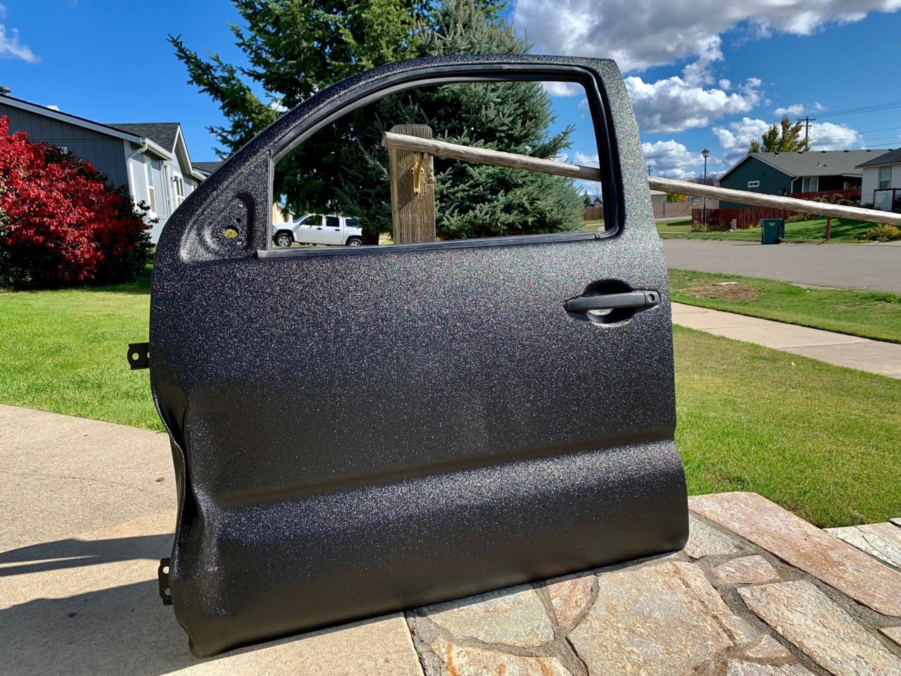

    I am getting pretty serious about pulling the trigger on this for my 2017 Black Taco. I have polished it so many times to remove pin stripes that I hardly have any clear coat left. But before I decide 100% I decided to do some torture testing on a 09 Taco door I found on marketplace. I had it coated in black. I am about 50% done making a YT video about it. But so far I am super impressed with this stuff. My main concern is staining since I am thinking about going black for the whole truck and its permanent.
    So far, it hardly leaves hard water stains and when it does, they just rub off with a brush. Mud and dirt come off super easy. I let salt water bake on for 1 hour and it came right off with no residue. I let soda, BBQ sauce and ketchup bake on in the sun and all came right off with no trace. I threw an egg at it and let that bake in the sun and it also came right off with no trace. Then I stepped up to gasoline, hydraulic clutch fluid and spray paint. Gas and clutch fluid came off very easy. Spray paint stuck on 100% and would not come off with 1900psi pressure washer alone. Going to try some acetone and a brush today to see if that works. I heated up sap and dripped it all over the door and let it bake for 5 days and about 98% of it came off with pressure washer. The residue came off easily with a bit of acetone and toothbrush and the acetone did not leave any trace either. I've been trying to get bird to poop on the door by leaving it outside with bird seeds all over it but no luck getting them to poop on it yet haha.
    Next I am going to try scratching it with branches then keys, then making artificial hail stones, also going to test a shopping kart at full speed into the door, then going to throw golf balls, change, rocks, tools, and glass bottles/soda cans at it. After all that I am going to shoot an arrow at it, then try shooting it with .22 , 9mm, .40 , .223, 7mm, and shot gun. Also going to lite it on fire then drive over it before dragging it behind my truck for a while haha. If you have any other suggestions feel free to share!
    Line-X does not add a ton of weight, anywhere from 80lbs - 100lbs tops per the rep at Line-X
    Line-X cost about the same as a paint job or wrap but will last 10x longer and scratch resistant
    Line-X is extremely easy to clean. Most contaminants come right off with pressure washer, soap and a brush if not. This means no more micro fiber towels, no more clay bars, no more wax, no more polishing. Way less maintenance then paint or a wrap.
    Line-X premium has clear coat with UV protectant so "supposedly" wont fade like regular Line-X.
    Line-X offers some serious protection VS paint/wraps. Vandalism, sever weather, off roading, road debree etc.
    I don't understand why this would lower resale value if done professionally. If a buyer understands all the benefits of this coating and realizes the time and money you will save by not having to detail it ever, and the facts that it will last much longer than paint IMO adds value to the vehicle. Maybe if you live in a desert climate and looks are the most important thing then I could understand not seeing the value. But if you live somewhere with real seasons and snow, or if you go wheeling and get pin stripes often this stuff is seriously ideal and far superior to paint in many ways.

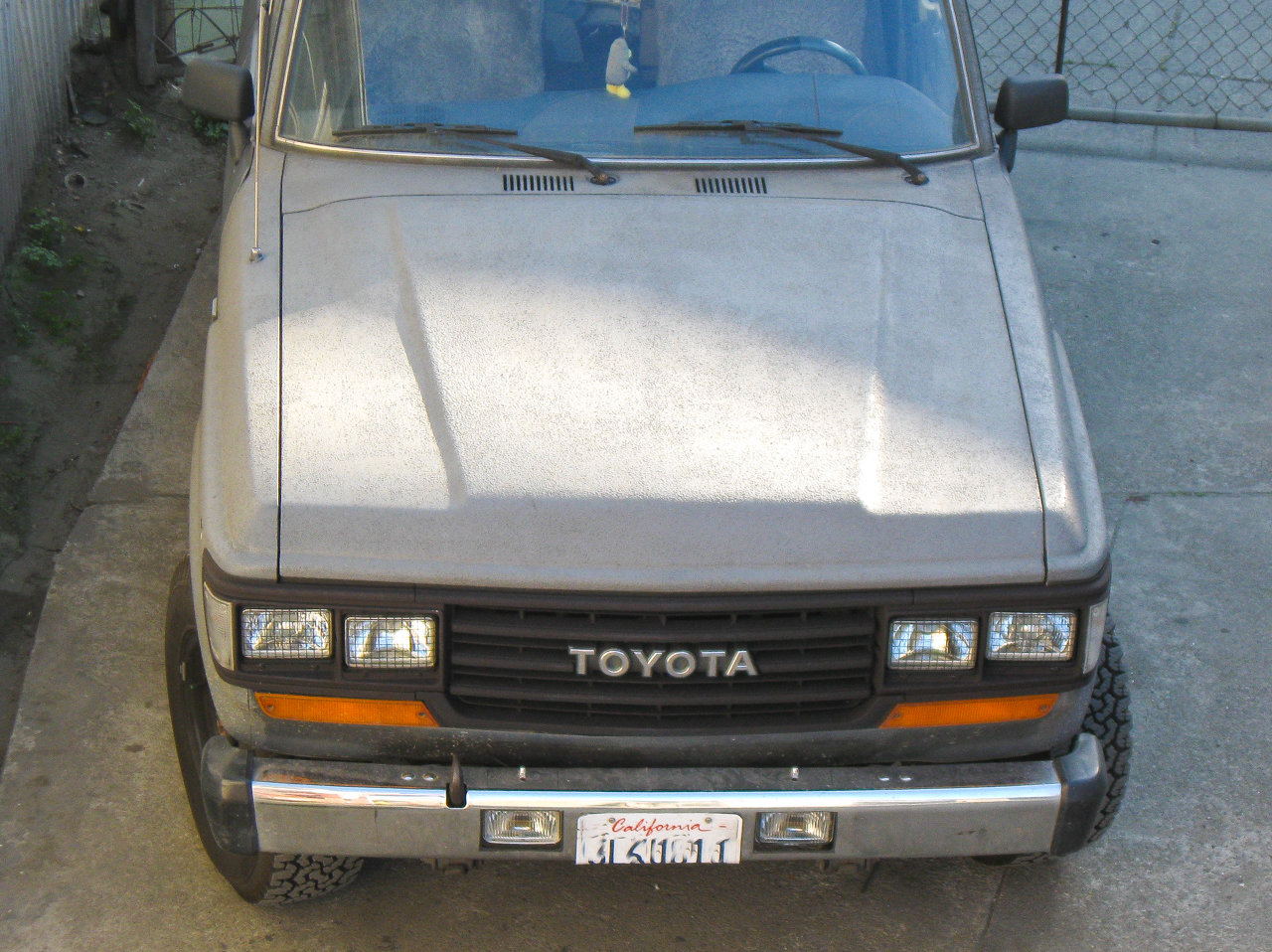

    I did that 20 years ago, and it held up really well.

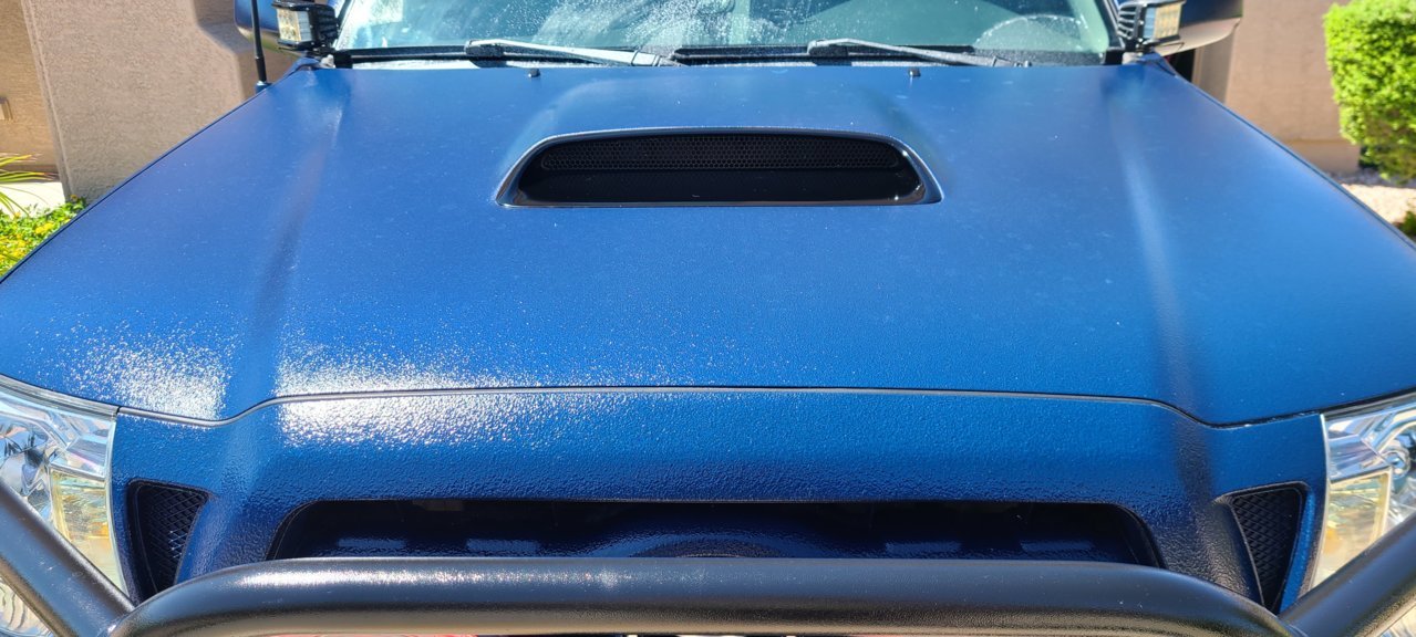

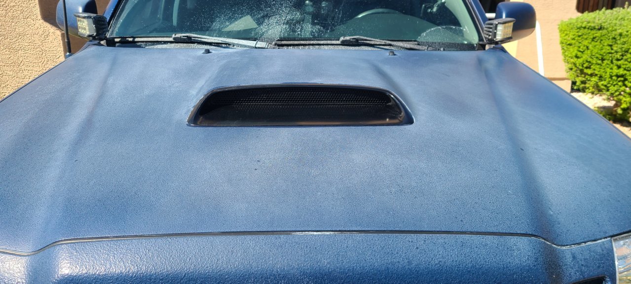

    Faded after years in the sun
    Wipe on a coat of boiled linseed oil and it's rehydrated and back to new. Dries smooth and hard like a clear coat with wax on it
