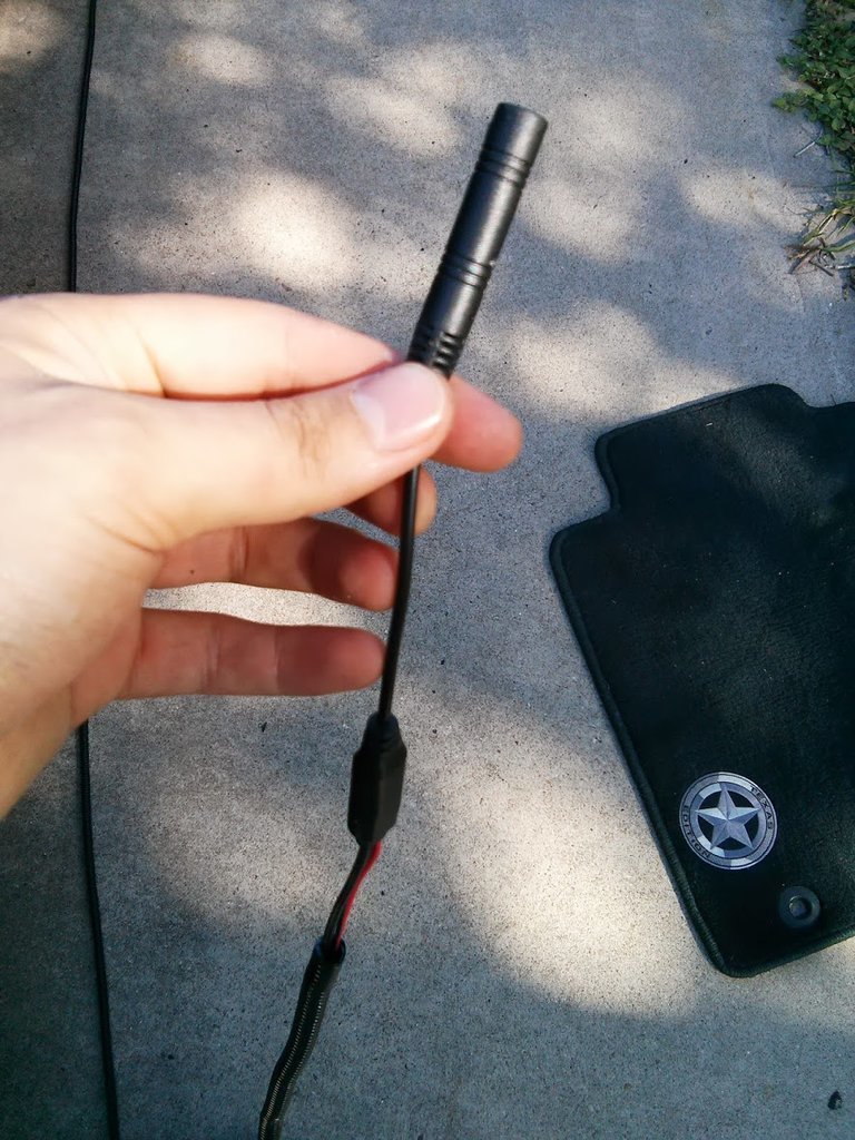

    I think you will need to rewire it, man. Here's a photo of the chassis harness that goes to the dash that came with my kit:
    The wiring harness that comes from the CS camera is also cylindrical and fits into the above. It's essentially a 4-wire connection -- two power & +/- RCA video.
    Another road-block. The reverse jumper pin that came w/the kit did not fit my harness. They were able to verify it was not the correct pin for my harness after sending them photos of what mine looks like. Judging by my first dealing with Chris @ CS, I'm sure they will take care of this for me.

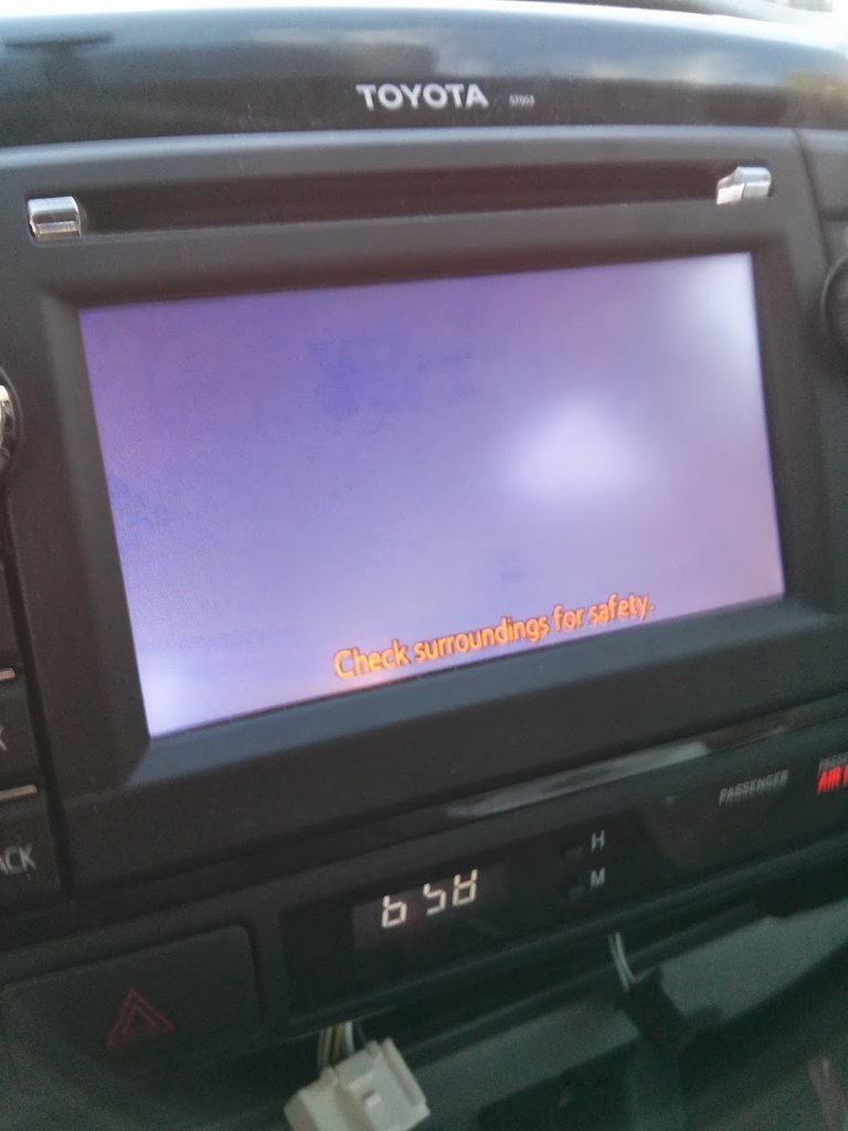

    I was still able to test things, though, and got the camera to turn on on reverse, however this is what I see:
    The camera has power at the connection. I sent another email, I'm sure they'll get back to me quick. Stay tuned.

    Update 3: I fiddled around some more just now, did some double-checking and noticed that the blank screen is not totally blank. There is a very faint picture, I think I was able to notice now that the sun is going down. Talked to Scott again and they are replacing the camera, too.

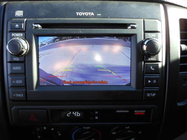

    Turned out great, man! Did he happen to say how he got the backup lines to show up?

    How'd you get grid lines? It's been driving me nuts since I got my truck that it doesn't have any grid lines when displayed on the head unit. Been looking, unsuccessfully, since I got the truck how get my camera to show in the mirror instead so I could have the grid lines.

    Thanks for the additional info. It's weird that the OEM camera displays lines on the rear view mirror but not the head unit. I never understood that.

    BJboucher, that is a great question. Does anyone know WHY the rear view will show lines but will not if you relocate it to the screen with OEM camera?
