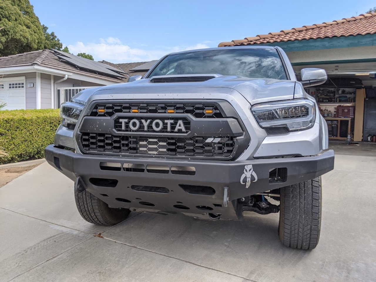

    Another boring build thread. Nothing special here... doing this more for me to have a place to watch the truck grow than anything else.
    Tacoma ownership has been a dream of mine pretty much ever since first watching Back to the Future (hence the title). Earlier this year my love/hate relationship with my Subaru Outback ended in engine failure. We were able to pay off our minivan and decided to finally make my Taco dreams come true.
    Purchased in early August for $48,332.59 including taxes / fees. DCSB in SSM. TRD Sport 4x4.
    Long-term goal for the build is to have a solid adventuremobile for taking me and the fam (wife and our three boys) camping off the beaten path (which we'd already stretched the Subie well past its limits in doing).
    Out with the old and in with the new...
    First few things I threw in were K&N filter & Weathertec floor mats.

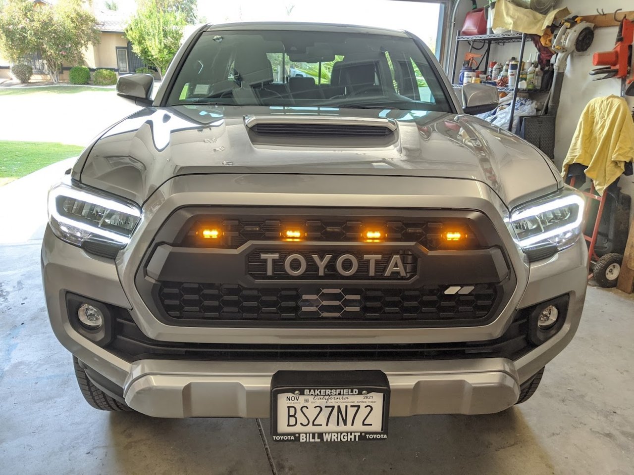

    First "upgrade" was the ubiquitous knockoff Pro Grille with FMVSS108 identification lamps (*cough* raptorlights *cough*). Don't hate.
    Also installed ARB rear-dif breather behind tail light. Not planning on fording any rivers any time soon but seemed like one of those things I'd rather have on when I need it than not have on and wish I had it.
    Trying to keep the black-on-silver thing going so next few aesthetic upgrades included yanking off the factory bed decals and replacing with matte black (I cut these myself with a small desktop plotter). I already had the SnugTop ordered at this point so I moved the new decals down about 1.5" to make sure they'd sit below the topper once it was installed.

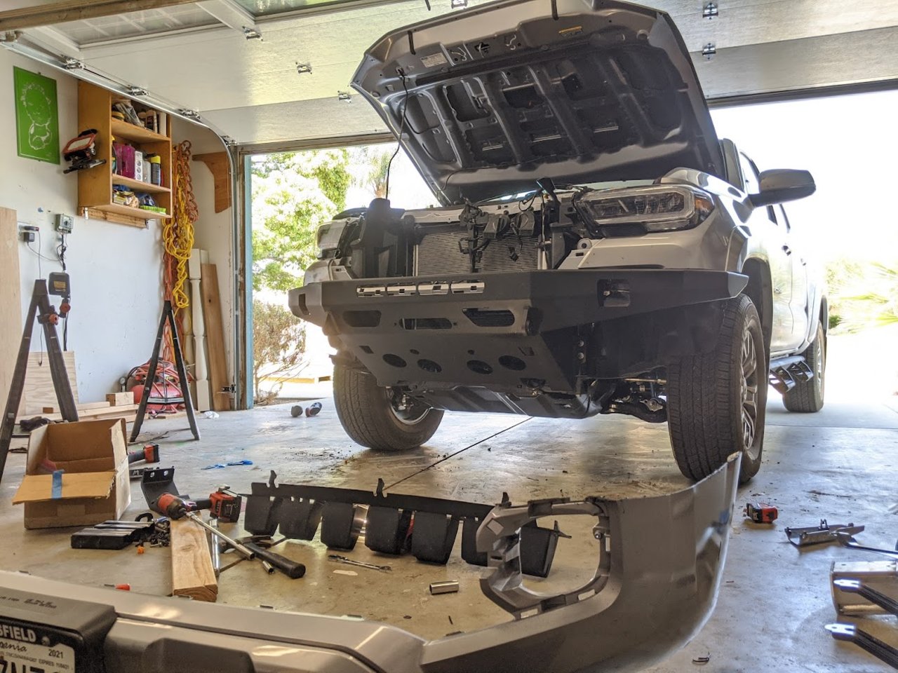

    Front bumper was on my "someday" list of mods... but after seeing one fairly close by in Buy/Sell/Trade I decided to jump on it. Linked up with @Catfish21 to snag the Brute Force Fabrication bumper which I installed the next day (that bumper cut was nerve wracking!). Added the mythosaur skull with the desktop plotter for funsies.
    Next up on the "didn't plan to spend this money yet but something I wanted some day popped up on Buy/Sell/Trade" list: Hooked up with @SLO/TACO to snag this Victory 4x4 roof rack and got it thrown on (light bar was generously included with purchase but I haven't hooked it up to power).

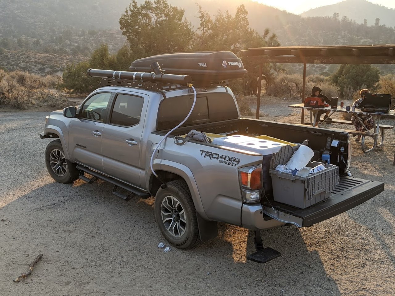

    At this point in the truck's life I'd already taken the boys for a few mini camping trips, but the roof rack served us well on our first all-family truck trek. First night was at Walker Pass east of Lake Isabella and then we shot over to AZ and spent a couple nights on Hualapai Mountain. It was nice to be able to use the Thule for extra storage but this trip made me really wish we had the SnugTop which had already been on order for a few weeks at this point.
    Thankfully the wait on the SnugTop wasn't as bad as expected and it arrived just a few weeks later. I got the Rebel w/ roof rails (plan to add the Victory rack eventually), "sportsman package" (reinforced roof), sliding windoors on both sides, and there was a special running at the time for a free tilt-open front window. Whole thing was about $3,300 installed. Ain't cheap but it's what I wanted. Also stoked w/ how the bed decals came out not being partially covered up by the topper.
    Setup as of 01/16/22
    2023 Setup. Put about 27k miles on her in 2022. Got some real sliders, too, thanks to @GHOST SHIP
    Next projects are:
    • @MillerCATCorp CatShield install (installed 11/11/21)
    • I'm already a couple months into the waiting game on my Ironman 4x4 Foam Cell pro kit (installed 01/09/22. shoutout and thank you to @GHOST SHIP for the install and cab mount chop. highly recommend you hit him up for install/fab work if you're anywhere near SoCal: GHOST SHIP: fabrication/installs)
    • ECGS bushing is in-hand and I plan to throw it in when I do the lift (installed 11/16/21)
    Planned projects include but are not limited to:
    • Try and be patient and snag some @SCSPerformance F5s... hopefully. Got tired of the Instagram games and ordered some FN Five Stars 17x8.5 -6mm 1/04/22
    • Tires... almost certainly going to stick with 33s 1/04/22
    • mezo tails installed 12/24/21
    • diode dynamics DOT fogs installed 01/11/21 (snagged 'em on sale from Hotshot Offroad thanks @memario1214!)
    • winch 5/25/2025
    • replace light bar w/ a real light bar
    • on-board air compressor
    • skid plates
    • Victory rack on the camper shell
    • real sliders (I'm liking the Relations Race Wheels ones, but I also dig these if they ever happen) Sliders installed in 2022 thanks to @GHOST SHIP
    • Considering rear bumper w/ swing outs
    • spiker engineering hood struts
    • kicker speaker swap
    • GMRS
    • UltraGuage Installed 01/26/22

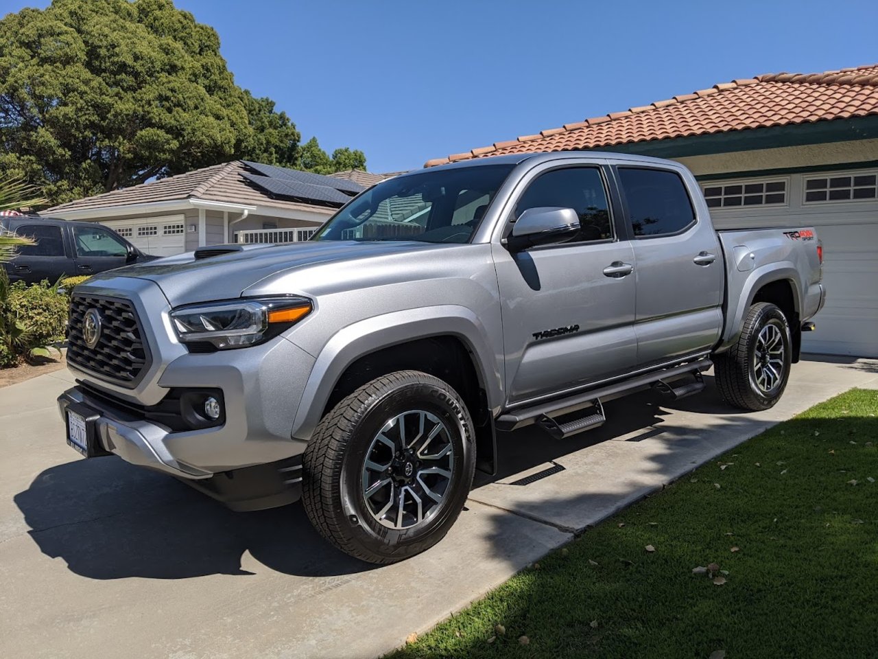

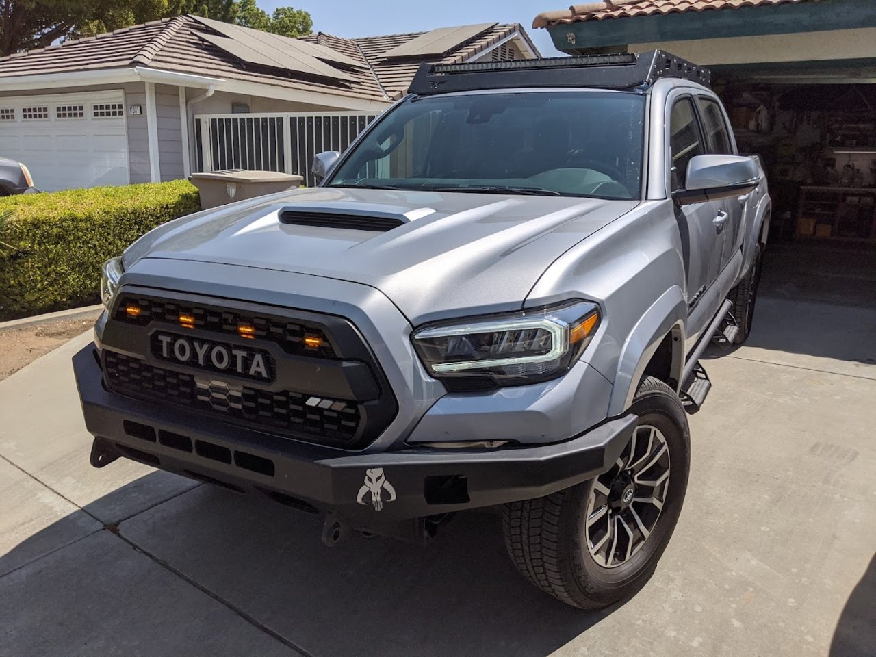

    After months of waiting and pouring over the Ironman 4x4 Foam Cell Pro thread, I finally got my lift installed!
    First and foremost: Huge shout out to @GHOST SHIP for doing the install (and cab mount chop) for me. If you are anywhere near SoCal I can't recommend this dude enough. Worth the drive even if you're *not* near SoCal. You can check out his thread here: GHOST SHIP: fabrication/installs
    So here's how she looks once all is said and done:
    I went with Ironman's "constant load" option for front and rear. I removed one (third) leaf from the leaf pack (some folks in the Ironman thread were ending up with 6" and 7" of lift in the rear with the constant load -- yikes!). I initially ended up with exactly 4" of lift in the rear and 1.75" in the front. (after driving home ~100 miles with a ton of tools and the old suspension in the rear plus ~20 minutes of light wheeling at Hungry Valley on the way home for funsies :taco:)
    I wanted to get the front up higher but obviously didn't want to take the shocks off and the compression tool from AutoZone doesn't fit these coils anyhow. I found if you unlink and swing the sway bar all the way forward you can use the spanner wrench to make adjustments on the truck.... albeit far from ideal. After dousing everything with a liberal coat of silicone spray, I was able to use to use a big persuader bar to get them to budge (and you can see what the spanner wrenches thought of my mechanical advantage!). I had to keep stopping every couple turns to hammer the spanner back into shape. This system wouldn't be nearly as bad with a beefier spanner... guess I'll need to try and find one.
    But the important part is: It worked! :rofl:
    Once all was said and done I was able to get her level (I guess not level... but sans Taco lean) with a lift of 3" in the front and 4" in the rear -- pretty much exactly what I was after.
    Anywhoooooo.... overall very happy with how everything turned out. Now time to save up for tires 'cus right now she's looking a little oafish with these tiny shoes on! :laugh::laugh::laugh:
