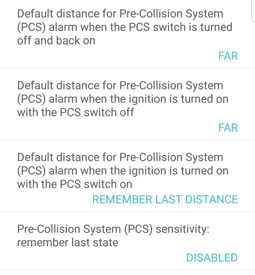

    Can I confirm this somewhere? Did you do this yourself and that is why you posted it? I will buy Carista in a flat second if this will do this part. I am having a horrible time with my dealer here not being able to clear a hard code on this TSS safety recall or admitting you can permanently disable the TSS. My Tacoma has a T3 CBI bumper and when they went to do the recall they said that cannot calibrate the sensor because the pre-runner grill is in the way. I don't even want to use the sensor or the functionality. I just want to use normal cruise control and I just get the run around at this dealer here in Bellevue, WA.
    I want to clear the yellow error I get about the TSS being inoperable and then go disable it permanently. I was told I had to drop my front bumper and bring it in to have it calibrated to complete the recall and with all the other stuff I read on this forum with people moving the sensor in their legit or fake pro grills I am fed up with the issue of not having cruise control.
    Thanks!
  8. Jan 2, 2020 at 10:50 AM
    #148
    dilbert
    dilbert AI Member
    Mar 14, 2016
    #181276
    2,853
    PNW
    2019 DCLB TRD Off-Road

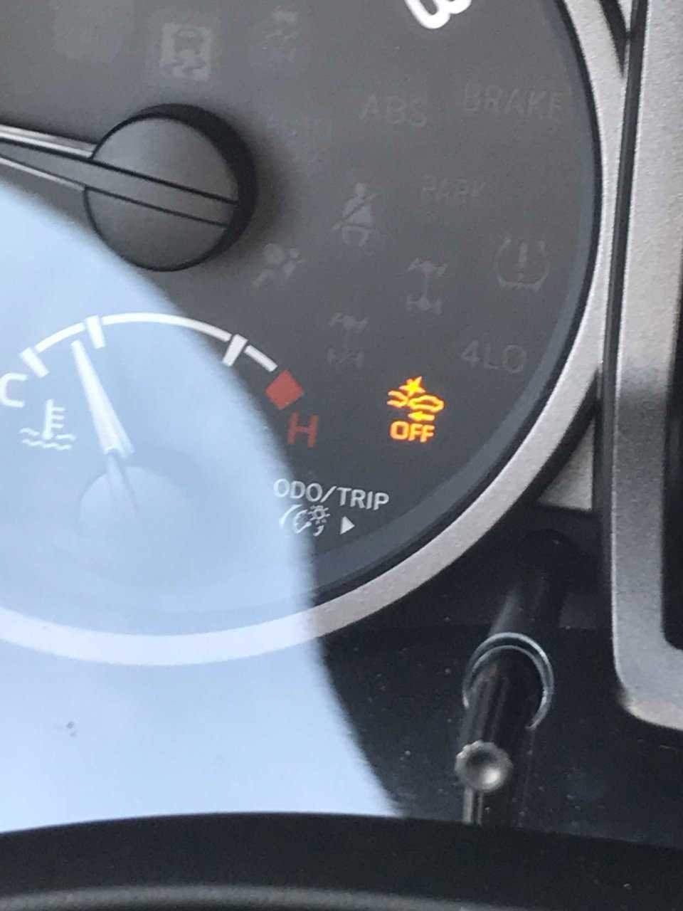

    These are the PCS system options in Carista. The last one, remember last state, is what TSB 0059-18 does. If you set it to enabled and then turn off the PCS system, it will remain off until you turn it back on. It will also light up the orange PCS light on the dash when set to off (same as the TSB)
