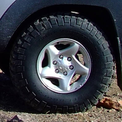

    I measured mine
    1st Gen TRDs 4.5" BS
    2nd Gen Stock Steelies 5" BS
    2nd Gen TRDs 5.5" BS (according to the wheel specs thread)
    Mine with 255/85/16 BF Goodrich Mud Terrain T/A KM2 on 1st Gen TRDs
    A slightly wider stance. No chopping and still running mud flaps. By the way spell check wanted to replace TRDs with Turds but I didn't let it. I just thought of something. I'm not sure if mine will clear the rear with 4.5" BS and 4" BS will push them out farther. I might have to increase my bump stops to prevent them from stuffing into the fender. This is just a baby flex on the hill just north of my house. I haven't taken them out for a good trail run yet. I'll let you know after I get a full flex.
