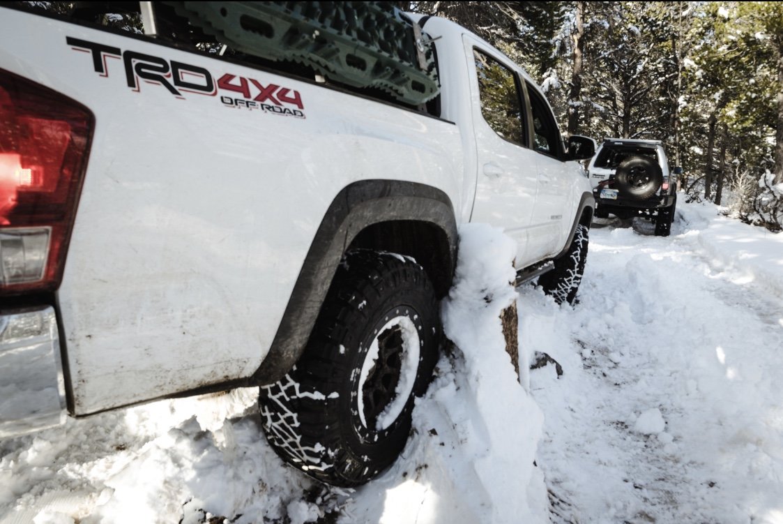

    Shit that must have been like November ish of 2017 haha. Slid straight sideways into a stump. Somehow didn’t damage the beside or door... just the C pillar

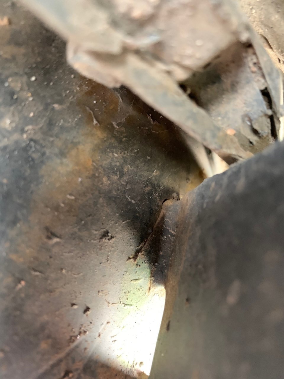

    Whelp, I need to do some welding. Hopefully the shop I mooch off of is able to open back up soon (mostly so the boys can get back to business, but also because I'm selfish and need to fix my shitbox). When I hucked my truck in Moab, I cracked my frame at the body mount, and it pulled down a bit, pushing my body closer to the frame. Now I need to cut off the mount, weld the crack, pate it, and weld the body mount back on. Plus I need to finally weld a pin hole in my exhaust shut.
    Then I can weld in some goodies from Locked Offroad so that this doesn't happen again :welder:

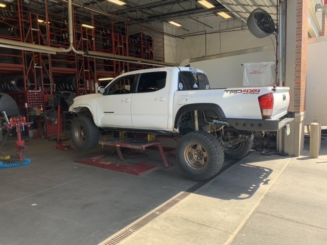

    Update:
    I’m still a lazy sack of crap and haven’t finished my camper or fixed my body mount... but I did get some 37s mounted up today! I’ll try to do a decent write up in here about the process when I tub because I haven’t really seen one for 3rd gens yet
