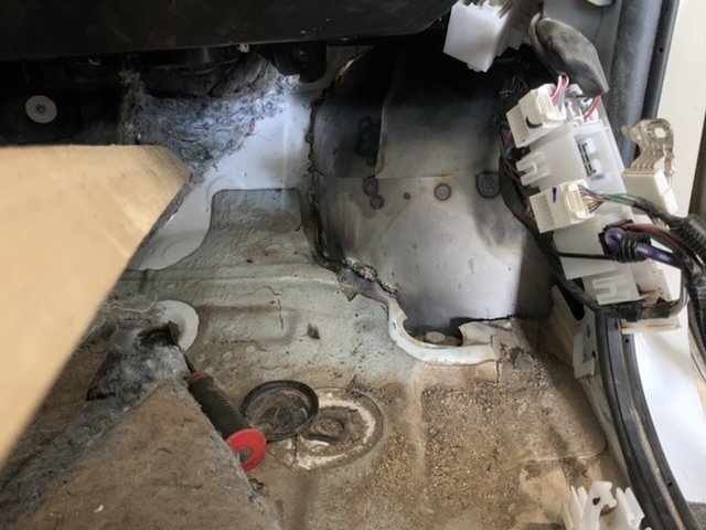

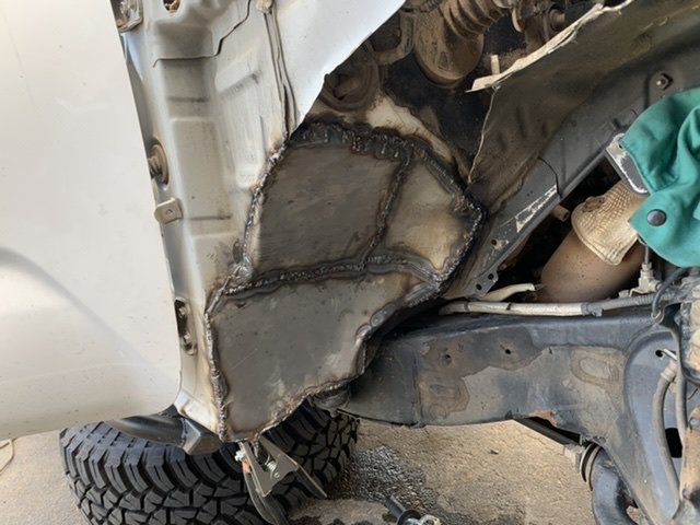

    Well today was once again less productive than I would have liked. The 110 flux core I was welding with really wasn’t doing it for me, and I was either not penetrating at all, or blowing holes in the sheet metal. So I got everything all lined up on the fire wall portion, and tacked it together. Then I drove to my friends’ shop and myself and a buddy welded the fire wall portion shut. That part is now primed and ready for undercoating. I welded a couple spreaders into the gap I left in the fender well in order to be able to throw the fender back on to drive to work this week. To be continued...
    (Pic from interior was just tacked together)5CBFF230-FE90-4094-B8A3-13E0AB6964A8.jpg

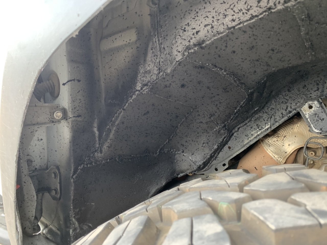

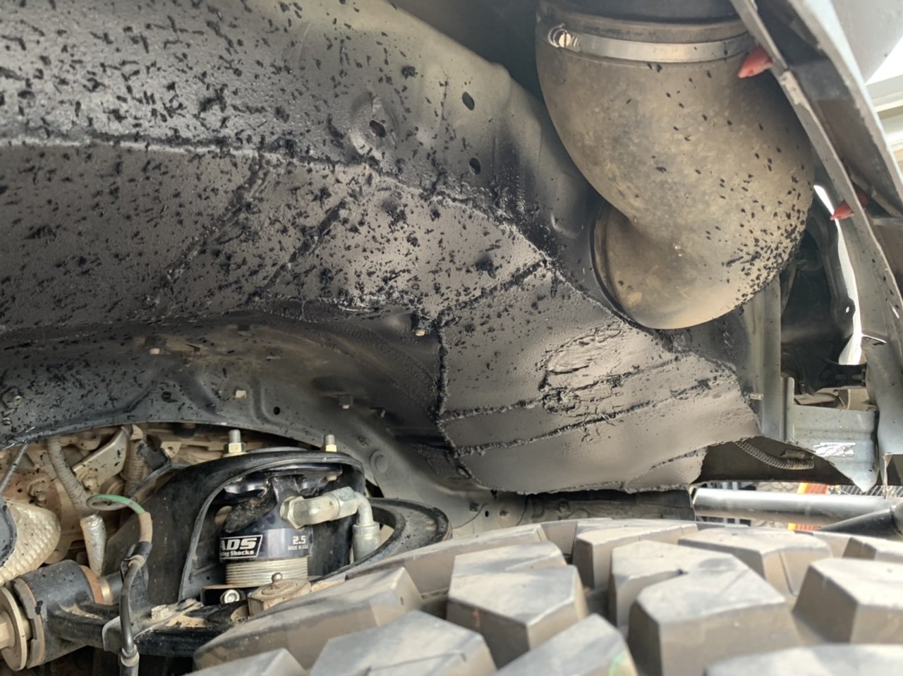

    Well, today I finished up the front passenger corner of fitting 37s. I rub ever so slightly on my new firewall at the cab mount (couldn’t push it further back without relocating the bolt so I’m fine with it) and a little bit on my new inner fender up front (couldn’t go any higher due to intake tube, so I’m ok with that too. Both rubbing spots are at full bump and full lock. The black crap everywhere is from flap disking my flare so it’ll wash off. On to the drivers side... eventually
    E958C3A9-B29D-49BC-A99F-344F2BB9D1EE.jpg 16BF141C-75A8-40F7-BB87-3ED178C06BF7.jpg E5C94C8C-B0BF-4A71-9B5D-8756360CF548.jpg

    Thanks! It’s been an interesting project so far. 2 weekends in and I’m done with one side. Makes it more difficult since I still need to drive this pig to work every day haha.
    hard to tell cuz of all the crap, but I used rubberized undercoating, I’ll probably add another coat or two on there to keep it nice and tight

    My only concern with line x or something similar is how abrasive it is and the fact that I still rub a little

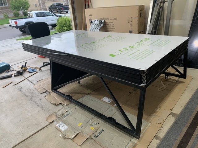

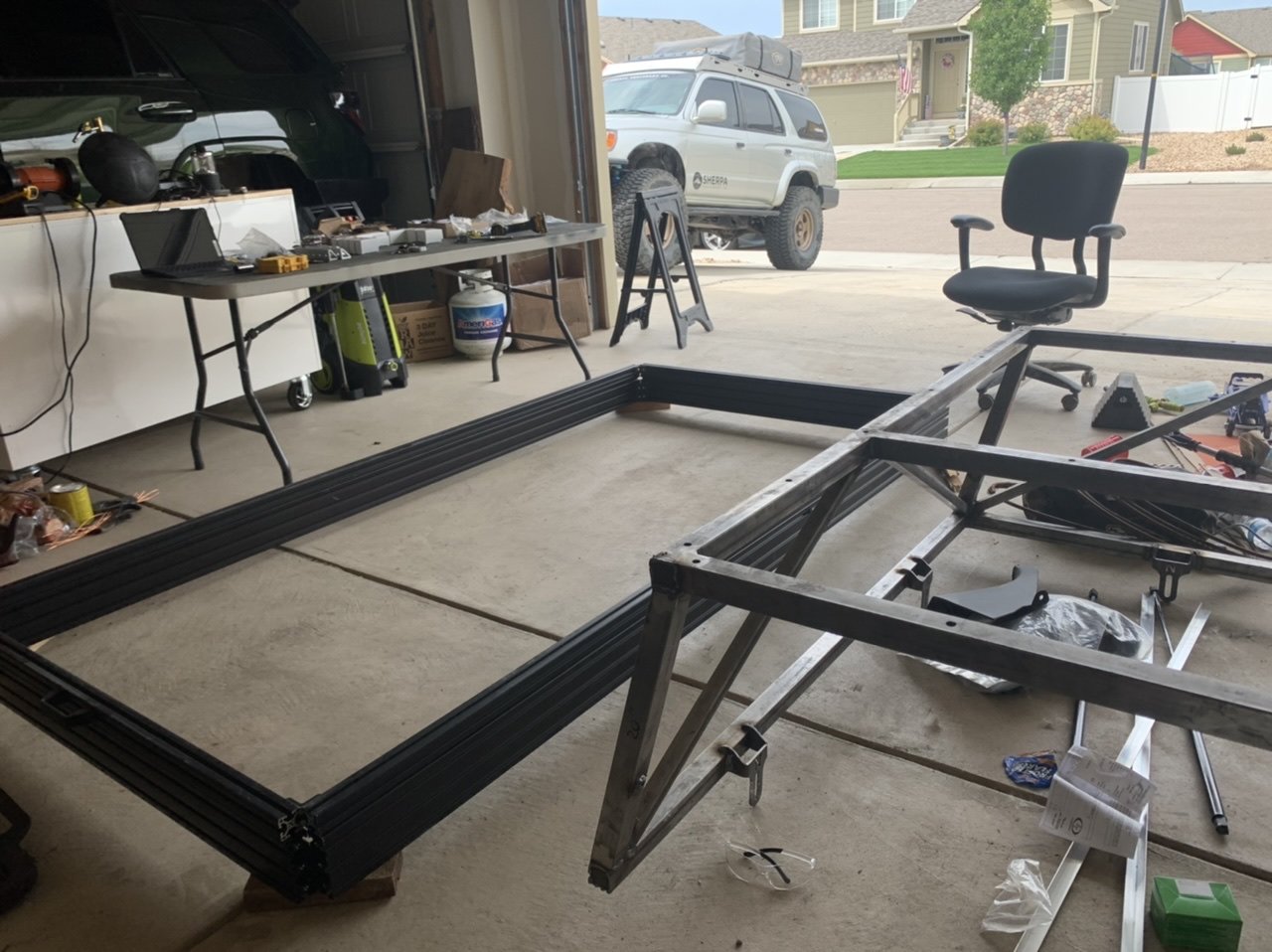

    Woohoo this thing is starting to look like a camper! My rivet gun broke today, so now I have to figure out how to get one without leaving the house. Then it’s just a matter of mounting/trimming the doors, adding some weather stripping, and mounting the latches and this bad boy will be ready to go

    Amazon prime baby, I'm about to go catch the rona on purpose so I can find some time to do this myself.
  18. Jul 30, 2020 at 6:18 PM
    #238
    literallynothing
    literallynothing [OP] I tow my new truck around with my old truck
    Aug 27, 2017
    #228243
    2,158
    Noah
    2017 DCSB
    Steel and 37s
    It’s a blessing and a curse. Timing was great and terrible. I manage commercial construction, and the project I’ve spent the last year and a half of my life on will finish tomorrow without me. So will the small job I’ve been doing on the side. So it sucks to miss out on that. But on the bright side I have a vacation coming up that I was just planning on not having the camper for, and at this rate I definitely will
    RockiesTaco likes this.
  19. Jul 30, 2020 at 9:17 PM
    #239
    rlx02
    rlx02 ¯\_(ツ)_/¯
    Sep 3, 2016
    #196329
    6,150
    Western WA
    2017 Inferno DCSB TRD OR 4x4
    How does the interior look when it's all put back together?

    I’ll take a pic today. Hard to notice, but there’s basically a foot rest for the passenger lol
