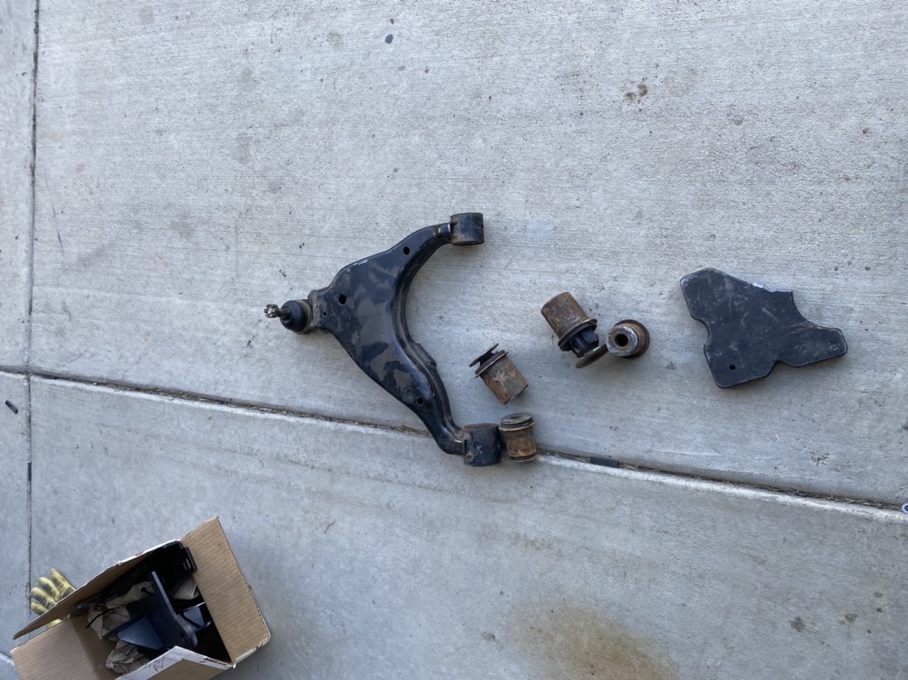

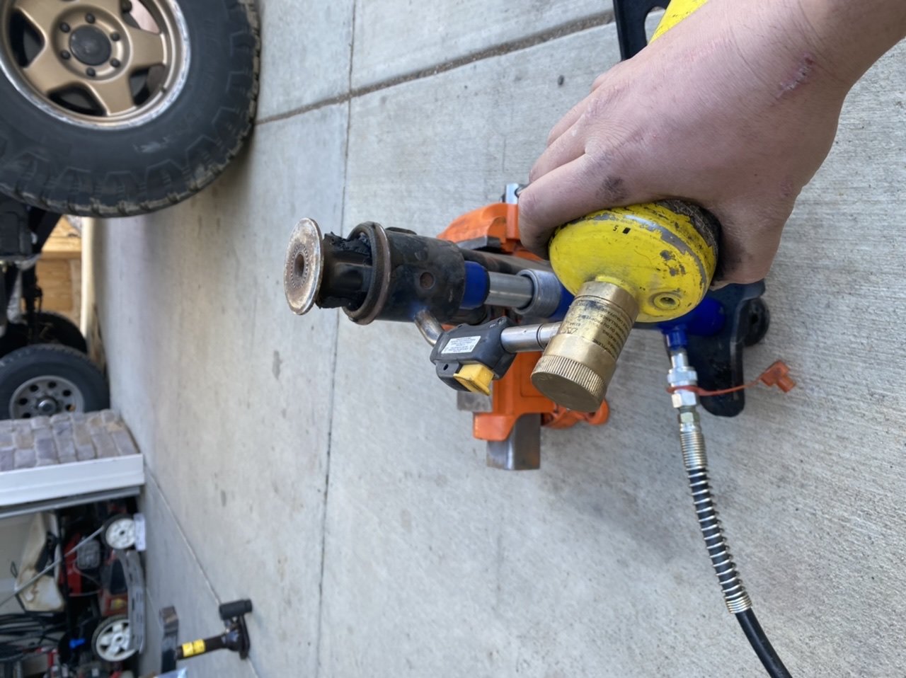

    Believe it or not, I actually did something for my Tacoma today. My neighbor had some spare 2nd Gen LCAs laying around, so I pressed the bushings out and will press new 3g bushings in. If you have access to a porta power, this is super easy. Took about 30 mins to get all 4 out
    43E34844-F382-4DE4-A262-F6F1DF86F3DF.jpg 13D02E8F-E3A8-4AED-8F3C-50BA42C0FBB6.jpg
