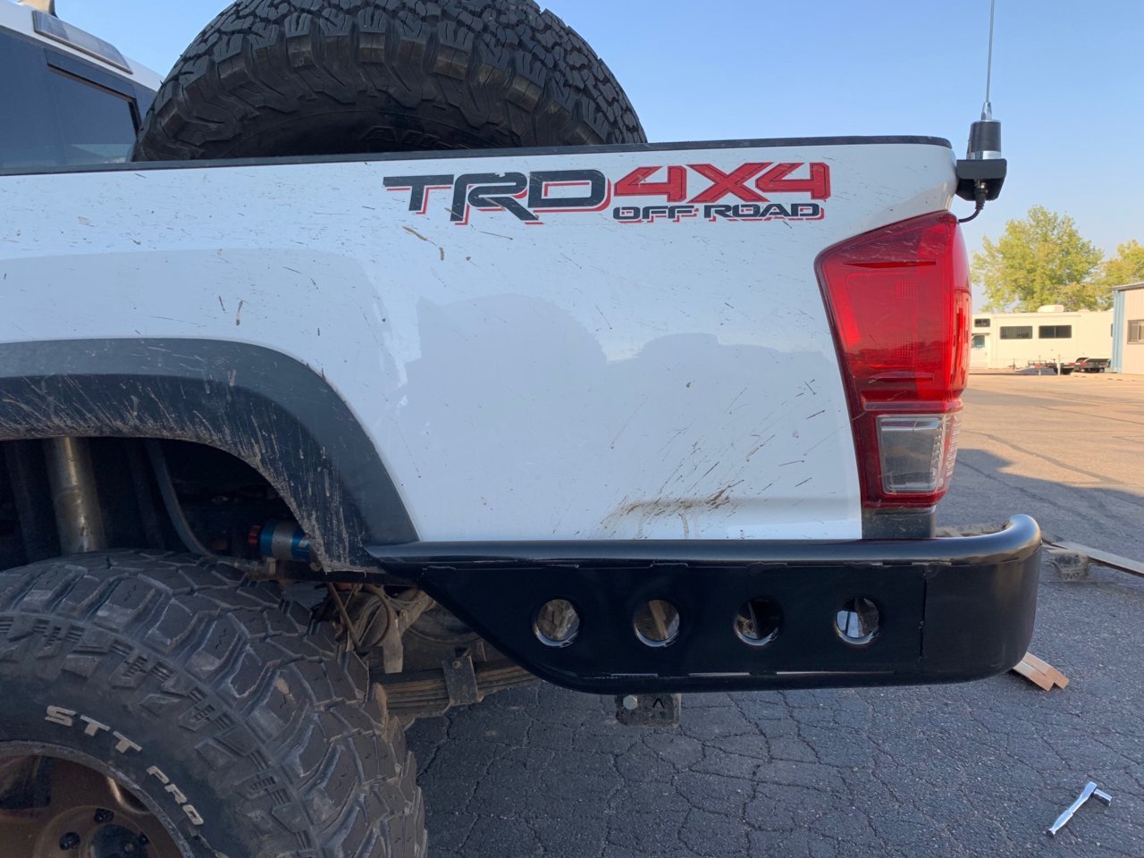

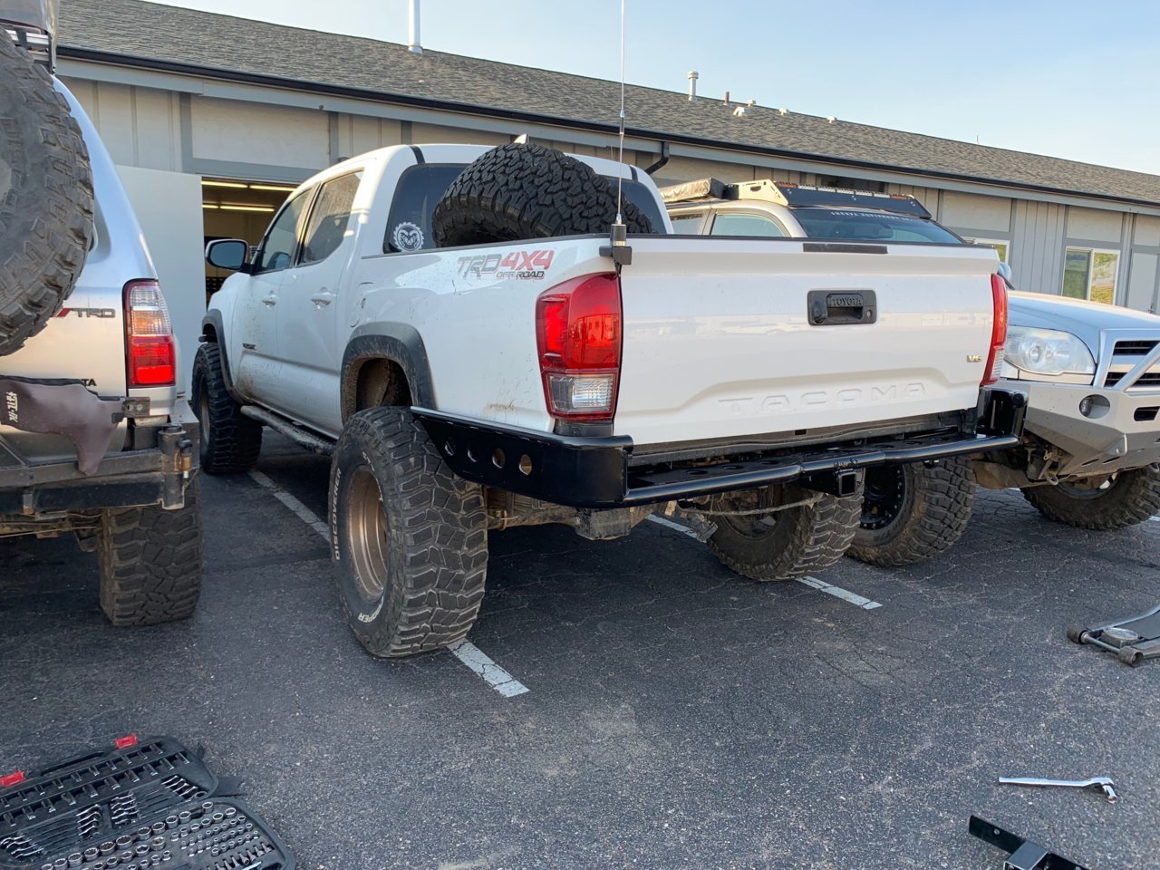

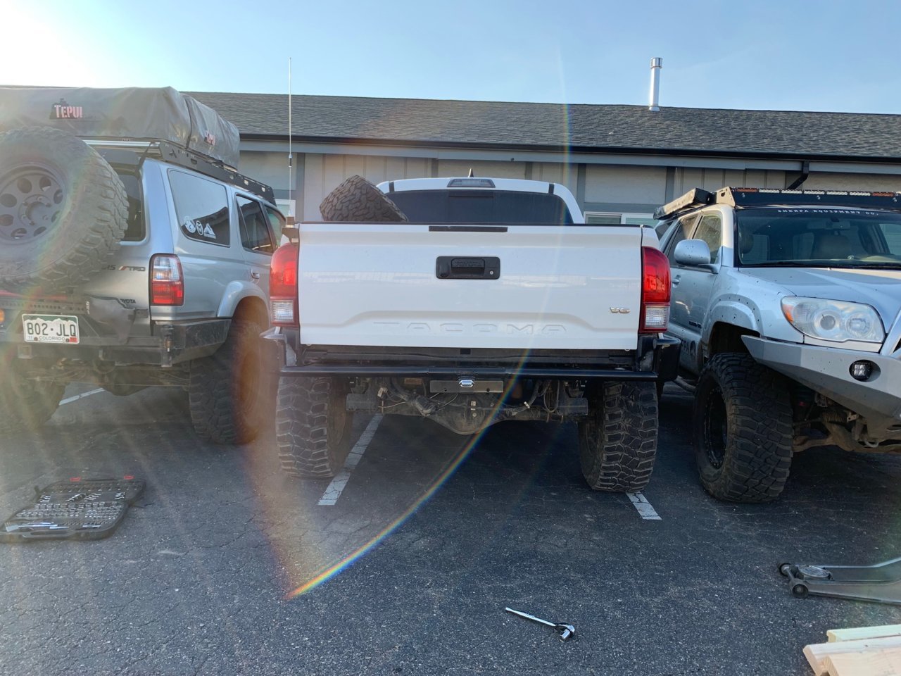

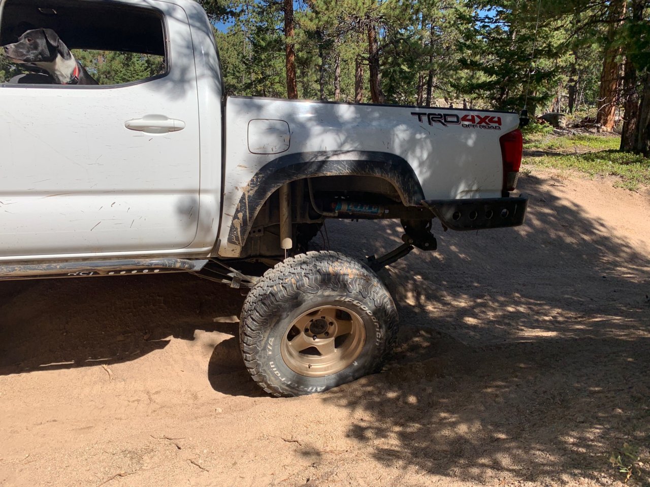

    Replaced my rear bumper last weekend with a WarFab high clearance Phantom rear. Huge shout out to @In4aride for hooking it up, and helping me get a bumper that is perfect for my needsIMG_3063.jpg IMG_3064.jpg IMG_3066.jpg

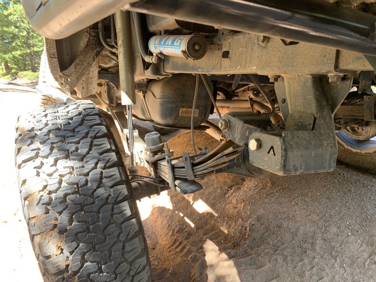

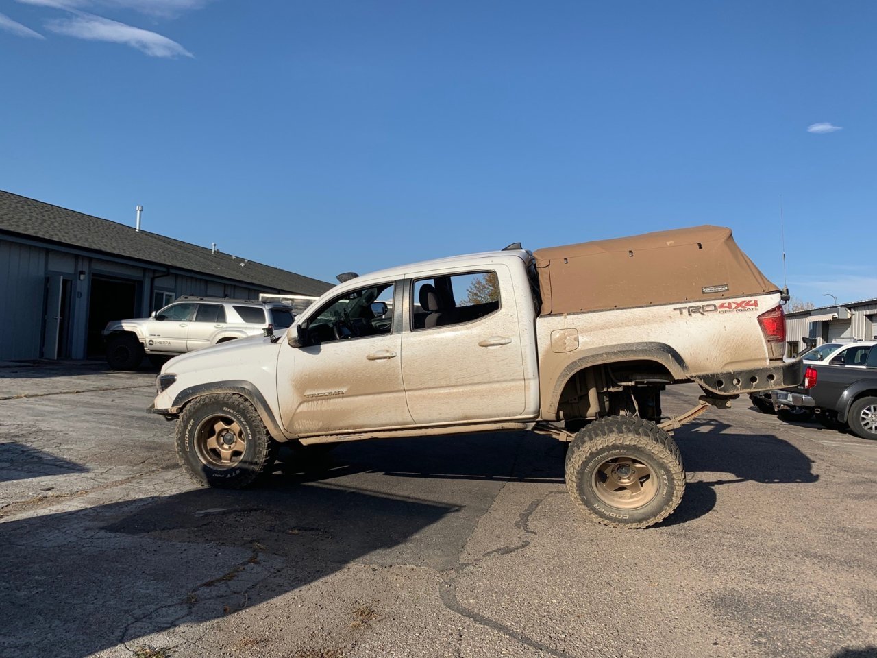

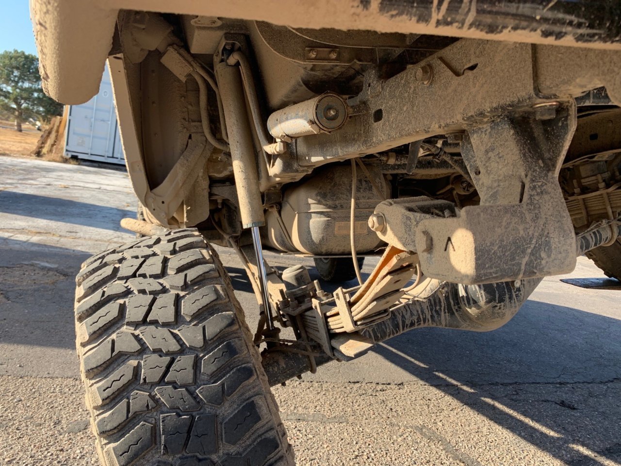

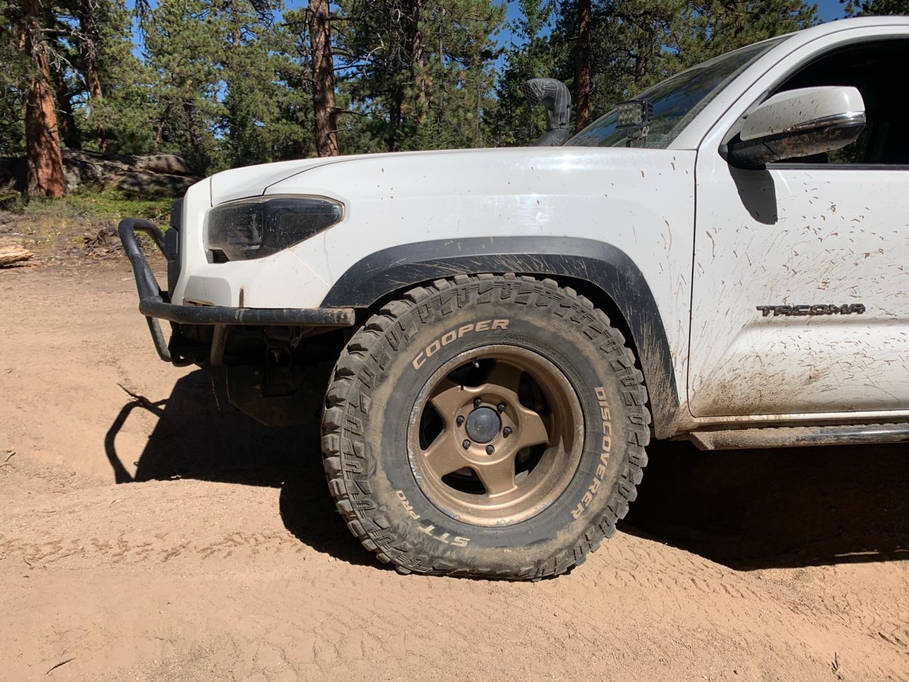

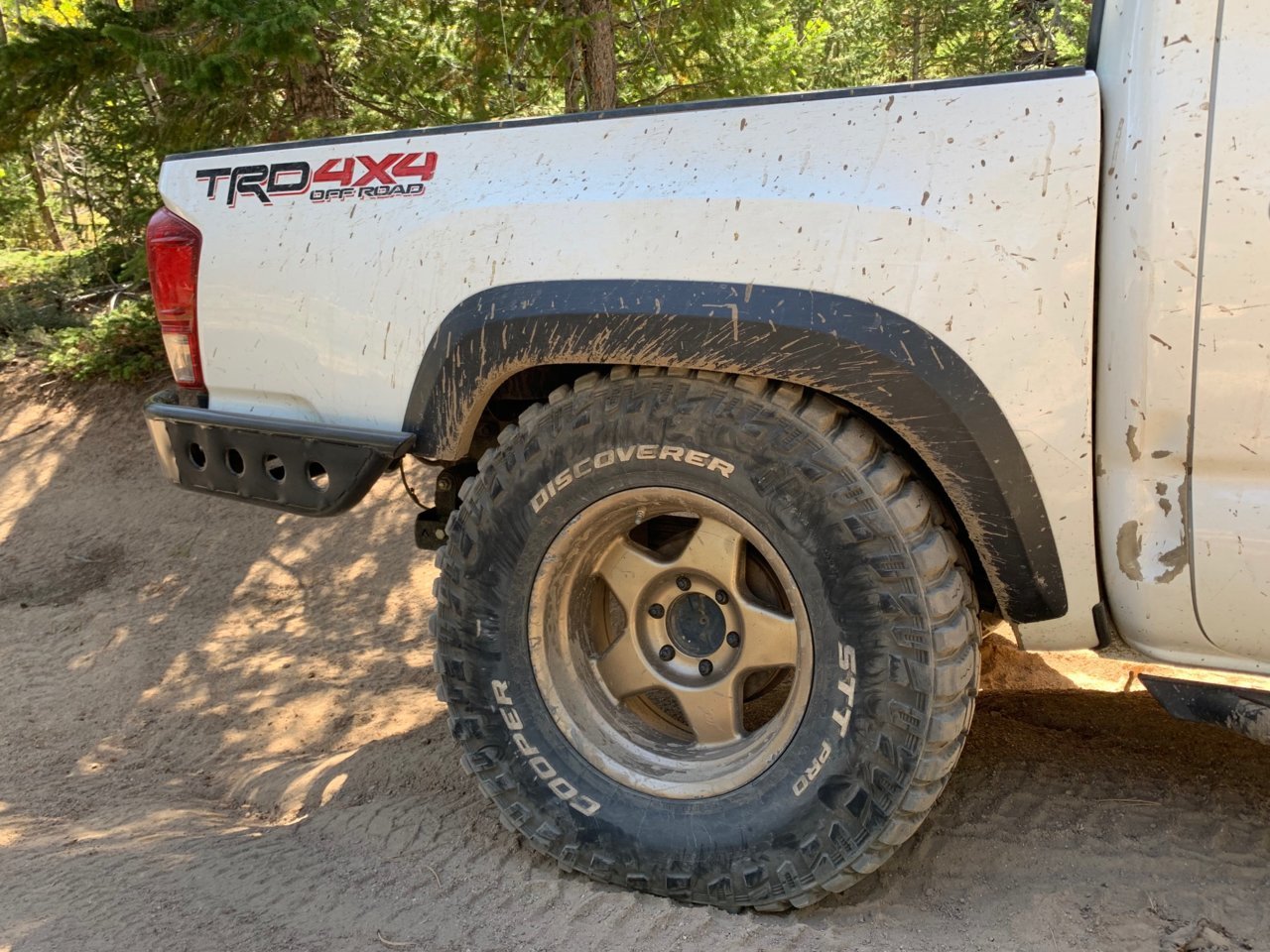

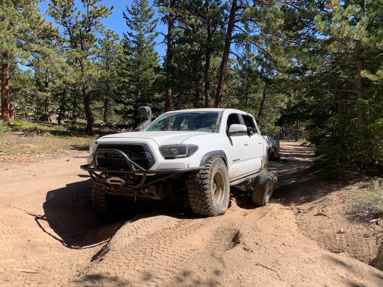

    Ended up running a local trail yesterday and finding a good spot to check clearances at full bump, also got to see pretty much full droop out of those Kings thanks to @ARCHIVE shock relocation and shackle hangers. I do need to move the lower shock mounts down a tad, and hopefully get a shorter pedestal for the superbumps, but I've decided to work on the front a bit first, since it is already miles behind the rear. I have a feeling that locked off road bumpstops are in my near future. IMG_3082.jpg IMG_3083.jpg IMG_3089.jpg IMG_3084.jpg IMG_3087.jpg
    P.S. ignore the KO2, had a sidewall failure on one of the coopers and need to get a replacement
  8. Sep 23, 2019 at 8:16 AM
    #168
    90yota
    90yota Instagram: 90_yota
    Apr 13, 2016
    #184183
    5,417
    Dixon, CA/Truckee,CA
    88 T4R / 15 F350
    Stock....ish
    You running 12s or 14s?
  9. Sep 23, 2019 at 8:24 AM
    #169
    literallynothing
    literallynothing [OP] I tow my new truck around with my old truck
    Aug 27, 2017
    #228243
    2,158
    Noah
    2017 DCSB
    Steel and 37s
    Short body 14s. That’s about 12.25” of shaft shown in the picture and the other side is completely bottomed out which is why I need to move the mounts down about an inch or so

    I’ve been eyeballing that bumper, it’s as HC as HC bumpers get!
    Did you ask @In4aride to build it shorter on the sides or is that how they come? I like the size since I’ll chop the flares anyways for larger tires.

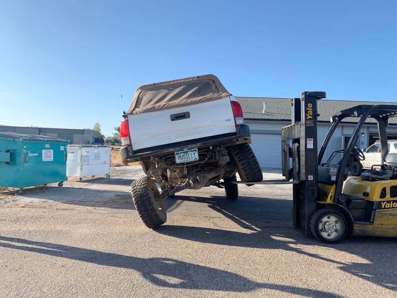

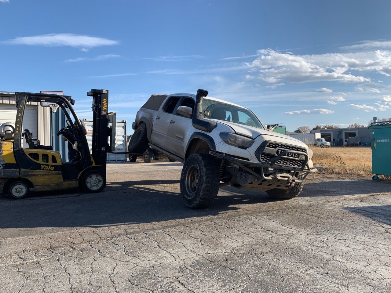

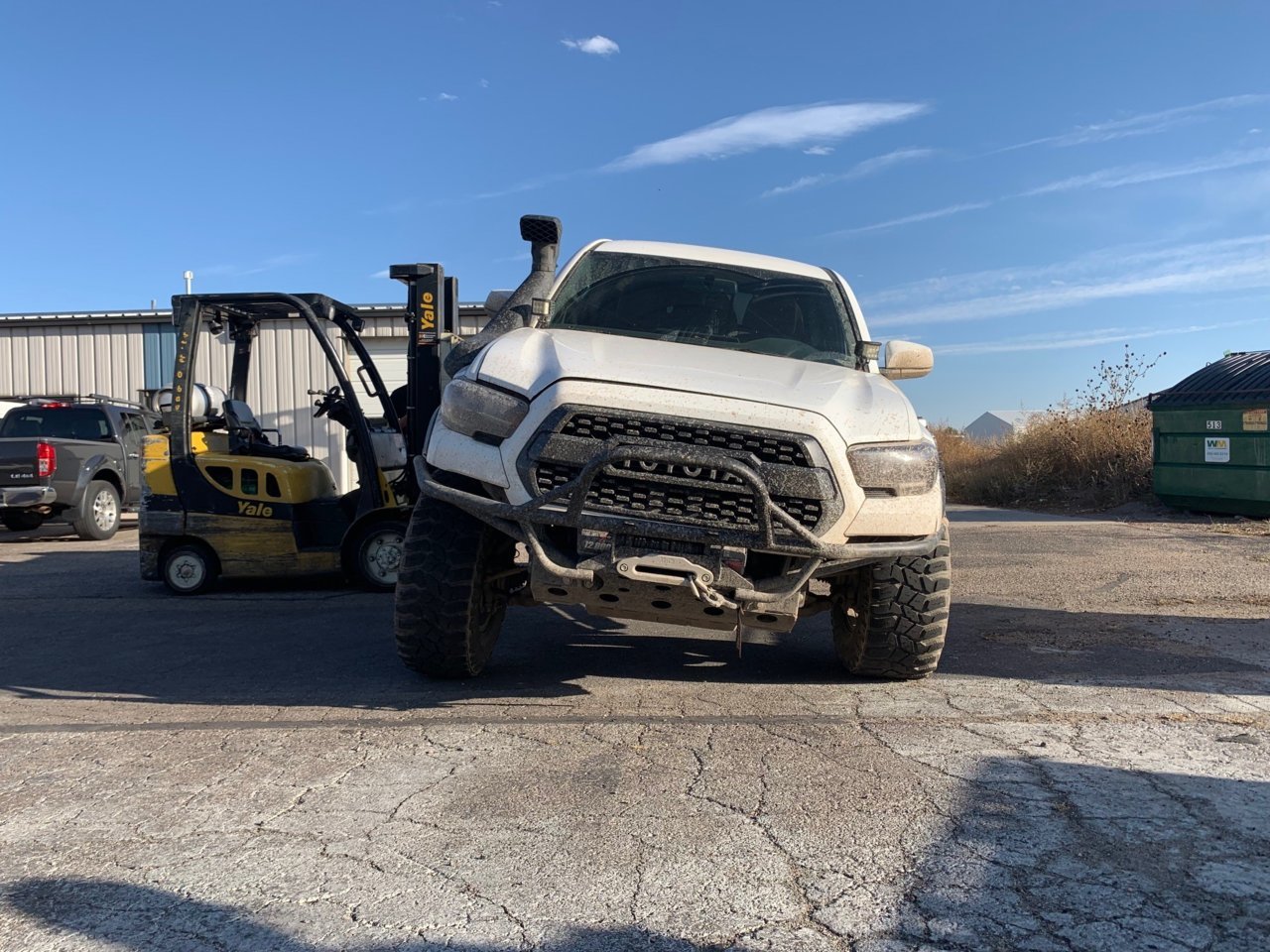

    Little update:
    Found a good deal on some ADS coilovers, so I shelled out the cash for those. The guys over at Sherpa Equipment Company decided to buy a forklift, so the following pictures are because of that. The tire ended up being 30" off the ground at max height. Not half bad for a leaf sprung truck with IFS. Fork 6.jpg Fork 1.jpg Fork 2.jpg Fork 5.jpg Fork 4.jpg

    Nice! Are you on 12 or 14” rear shocks?
  20. Oct 14, 2019 at 8:56 PM
    #180
    literallynothing
    Aug 27, 2017
    #228243
    2,158
    Noah
    2017 DCSB
    Steel and 37s
    14s. I have about 12.5” of shaft showing at here, and the other side is damn near fully compressed
