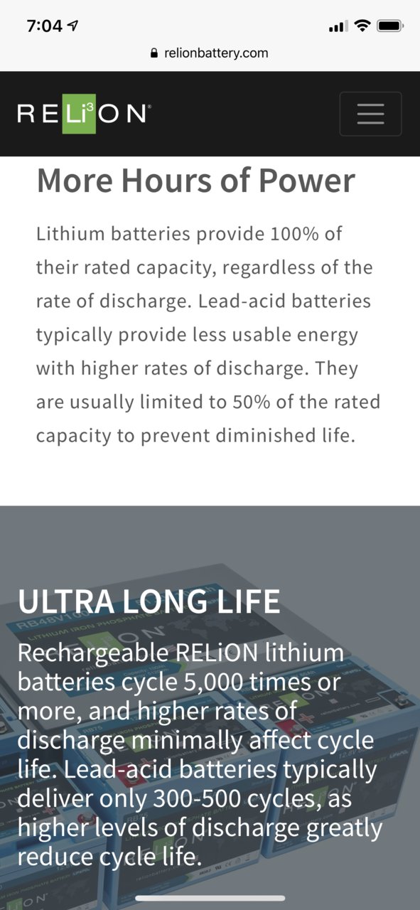

    destin_meeks
    destin_meeks I used to fix people's crappy stereos
    Jul 14, 2017
    #223997
    3,944
    Destin
    Tuscaloosa, AL
    2017 SSM DoubleCab TRD Off-Road 4x4
    From Relion’s website
    100% of rated capacity
    As for charging, I’ll give you that one. While it’s possible to do, it’s not smart to risk your expensive batteries. The biggest dc-dc charger I can find is 40A without stepping up to the RV stuff (inverter, shore power charger, solar charger, dc charger all built together) so +/-2.5 hours.
    And again, I only have to do that once a week. The moment I add in solar, I’m topping my battery off all day while we’re not at camp.
    We all have a preference. I don’t have lithium money right now so I don’t have lithium. I buy cheap deep cycles and beat them to hell. One day I’ll drop the coin on lithium, when I can go camping more than once every few months. But if you can swallow the price tag up front, they have tons of benefits and you get your money’s worth over the years.
