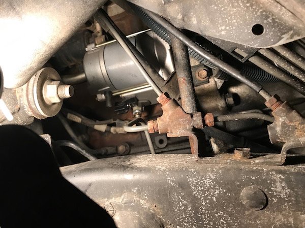

    Actually they didn't have the starter in stock, but the gal behind the counter drove out to a store that did (the 2kW version vs the stock 1.4kW part). That was awful nice of her. Just popped the new one in there, which was super easy with the wheel off. The stocker was weak and getting weaker. Easy swap and now it sounds real nice starting up.
