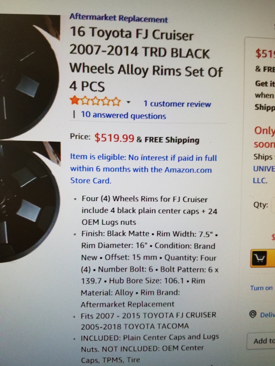

    20180825_123137.jpg Within a couple of weeks, I am going to have my factory wheels powder coated or buy these. Just want to make 100% sure these fit? Looks like they do. 2018 OR 16" wheels. Thanks.

    Seen lots on different tacomas. The front brake architecture hasn't changed from 2005-2018 so it should fit fine.
    Edit: the entire front end architecture hasn't changed.

    After reading the specs in the description theyll fit perfect.6x139.7 Hub bore 106.1 is the size on the Tacomas

    Should technically fit, but are you sure you want a 15mm offset? That will sit about 0.4” out further than stock. That’s not bad, but a lot of folks are going with either at least 10mm or 0mm offset. Not knocking it, just wanted to make sure you see that number as well before you pay the man.

    I saw that. Decisions, decisions.
