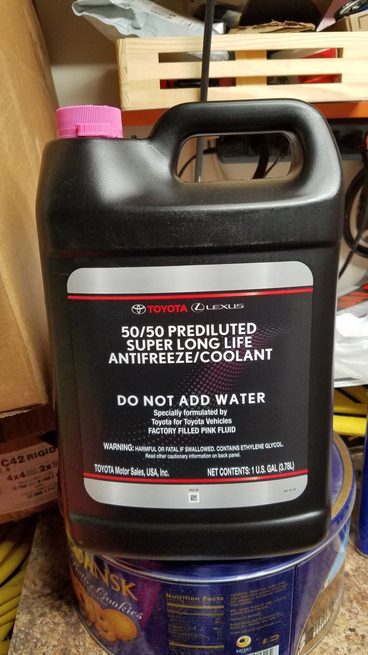

    If your only a little low, let’s assume 6 or 8 oz. or so. Then you just add the same with distilled water. No need to buy a full jug and store the rest.

    edited my post so as not to spread misinformation, had no idea they were that different from one another. Glad I picked up the 50/50 pink the other day and not the undiluted red.

    My pink 50/50 from the dealer has a pink top...

    So......, I went down that rabbit hole until my head was spinning. If I understand anything about this, my 2009 Tacoma requires the Pink Super Long Life prediluted antifreeze with no aftermarket additives, correct?

    The FSM states "TOYOTA SUPER LONG LIFE Antifreeze Coolant" or equivalent"
    Manual transmission 9.7 liters (10.3 US qts, 8.5 lmp.qts)
    Automatic transmission 9.8 liters (10.4 US qts, 8.6 lmp.qts)
    Diluted or concentrate doesn't matter. You can buy either. If you buy the concentrate, you just have to mix in distilled water yourself.

    But TOYOTA doesn’t sell a SLLC that’s not diluted 50%. I’ve spent years, literally, reading about coolants. If you do a complete flush, thoroughly, and use an equivalent coolant that’s not Toyota then you should be fine. Mixing ANY 2 different coolants that aren’t identical has resulted in sludge. In my case, it was compatible coolant to Toyota yet mine still created a brown, rust colored sludge even though I very thoroughly flushed it. I seriously spent hours flushing with the Prestone kit and distilled water, draining the radiator and engine block but it still created the sludge. Seeing as this only needs to be done every ~50K miles, it’s worth it to just spend the extra coin and use Toyota SLLC.
