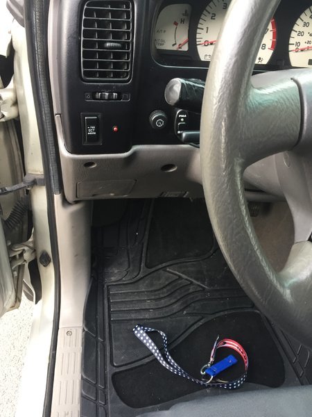

    I have this little red light next to my steering wheel and i dont know what it is. I dont think its a security system or anything like that because i did not get a key fob when i bought the truck, i just got a key. Any thoughts?

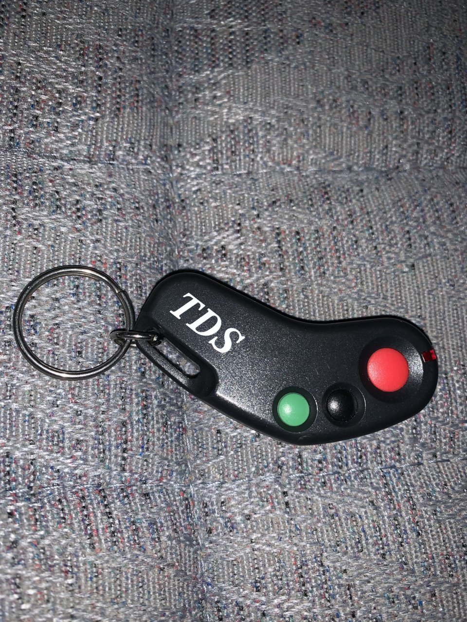

    Could be the "Theft Deterrent System" or TDS that was installed by some dealers.
    The fob looks like this:

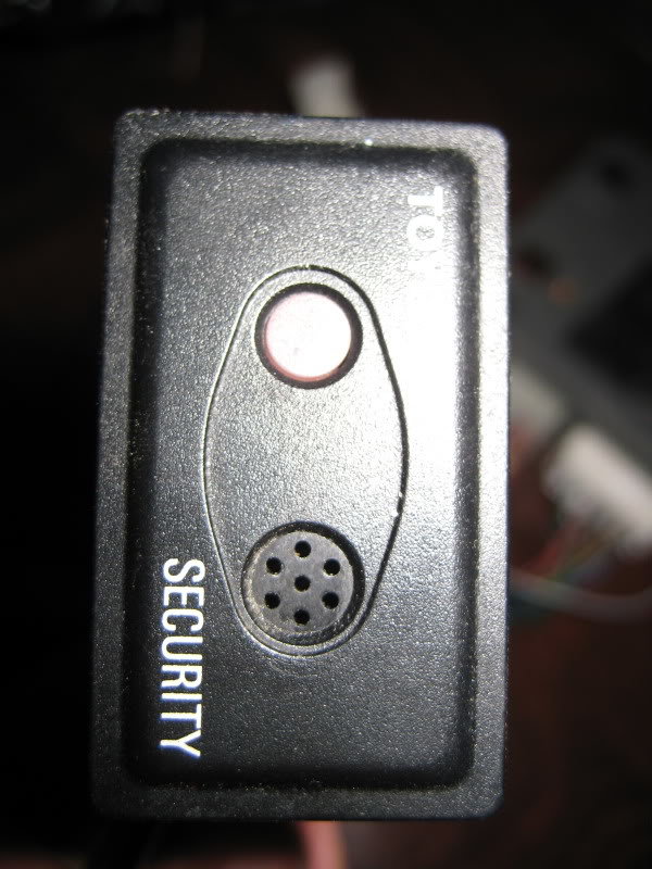

    this is the Toyota factory alarm light, not the little dot.

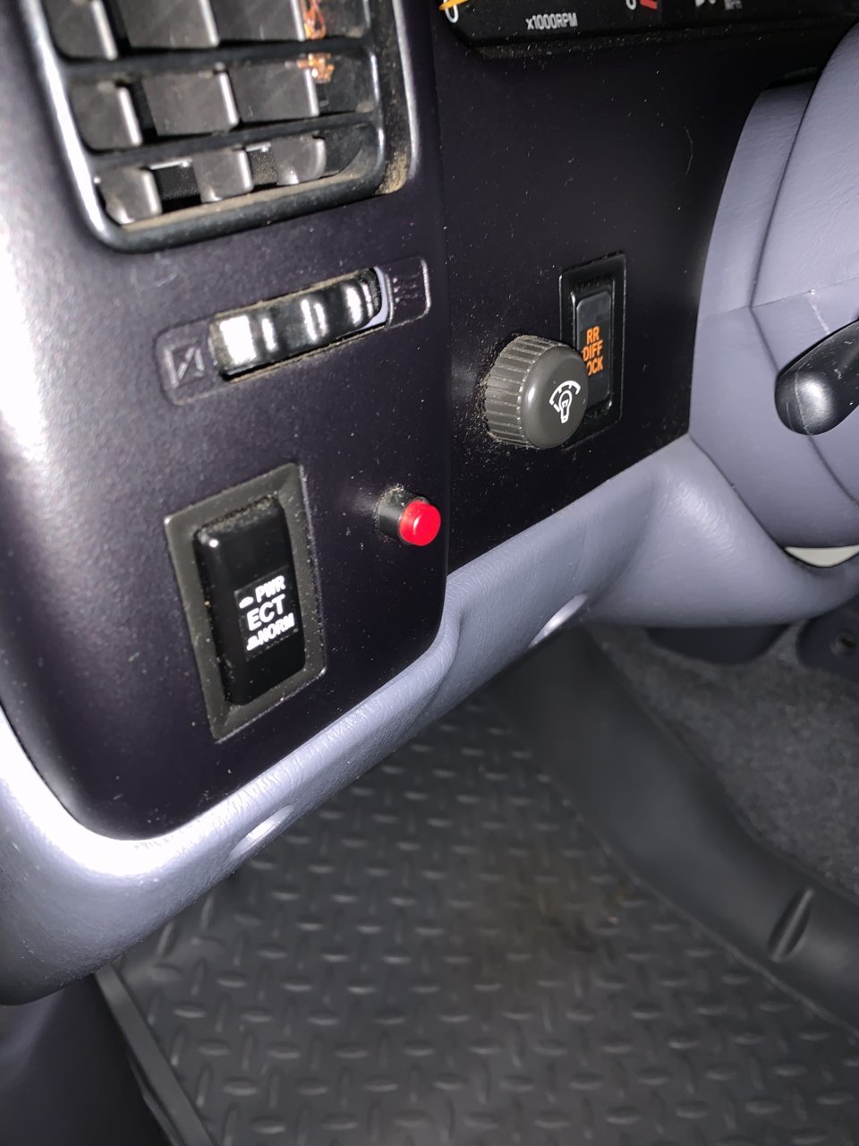

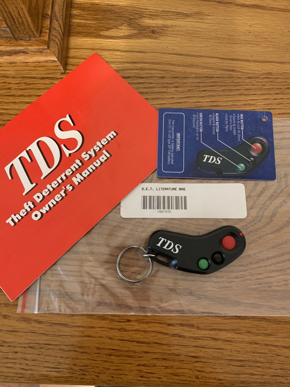

    I believe the Toyota Theft Deterrent System (TDS) was a dealer installed option on my 1999 SR5 with the TRD package.
    My red light is a valet mode switch that turns the TDS on and off. When the switch is in, the red light stays ON and the TDS is in the alarm systems OFF valet mode.
    If you have the Toyota dealer installed TDS you might want to contact your dealer and ask about purchasing a new FOB like the one in the photo and programming it to your truck. I don’t use my system daily, however when I disconnect my battery, pushing the red button on the FOB that unlocks the doors is the only way I can turn my alarm off (horn beeping) and start my vehicle. *after just now reading the TDS Owners Manual, I’ve learned I can stop the horn from beeping and start my truck without the FOB by doing the following: open the drivers door using the door key alarm will sound, make sure the valet switch is is in the off (out) position, then turn the ignition key on. Press and release red valet switch to the on (in) position. The alarm will disarm and the truck can be started.
