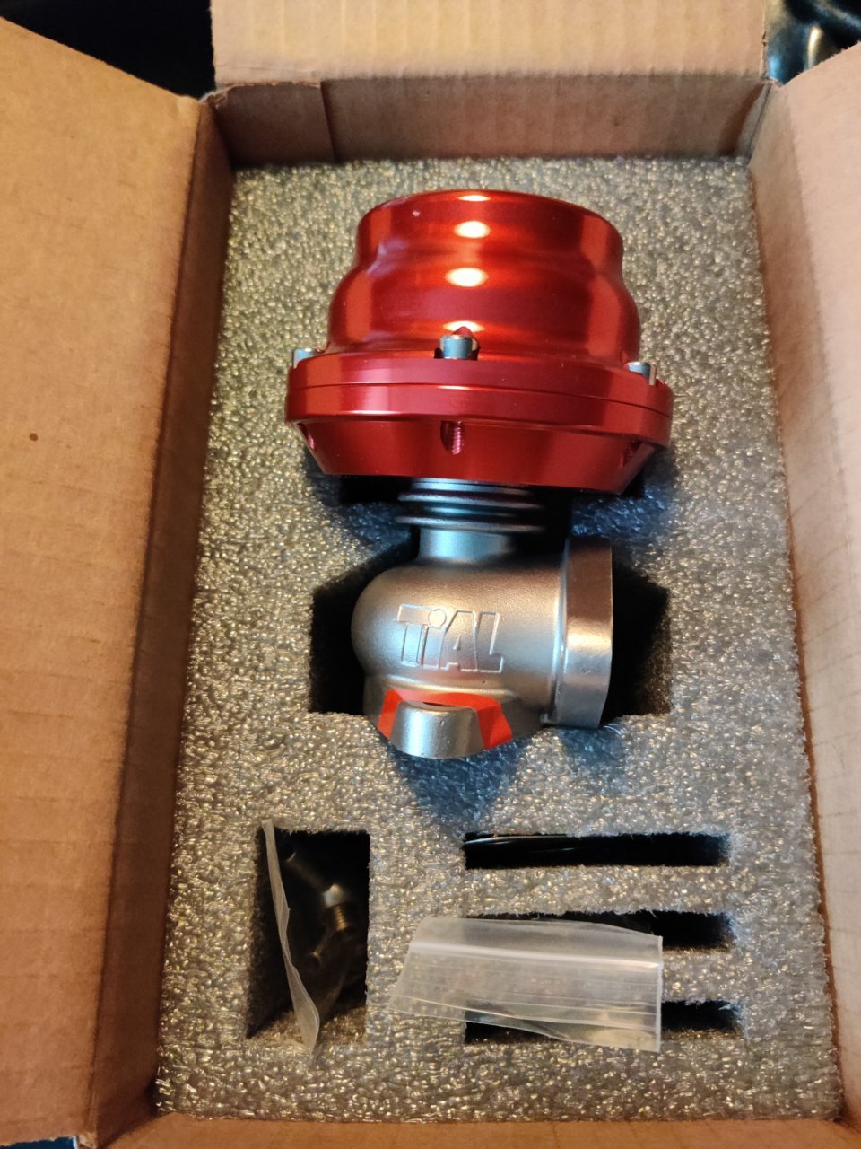

    Got some more pieces to the puzzle today
    I'm kicking myself for not throwing a larger diameter exhaust on when I had it all rebuild last year. Buy twice cry twice.

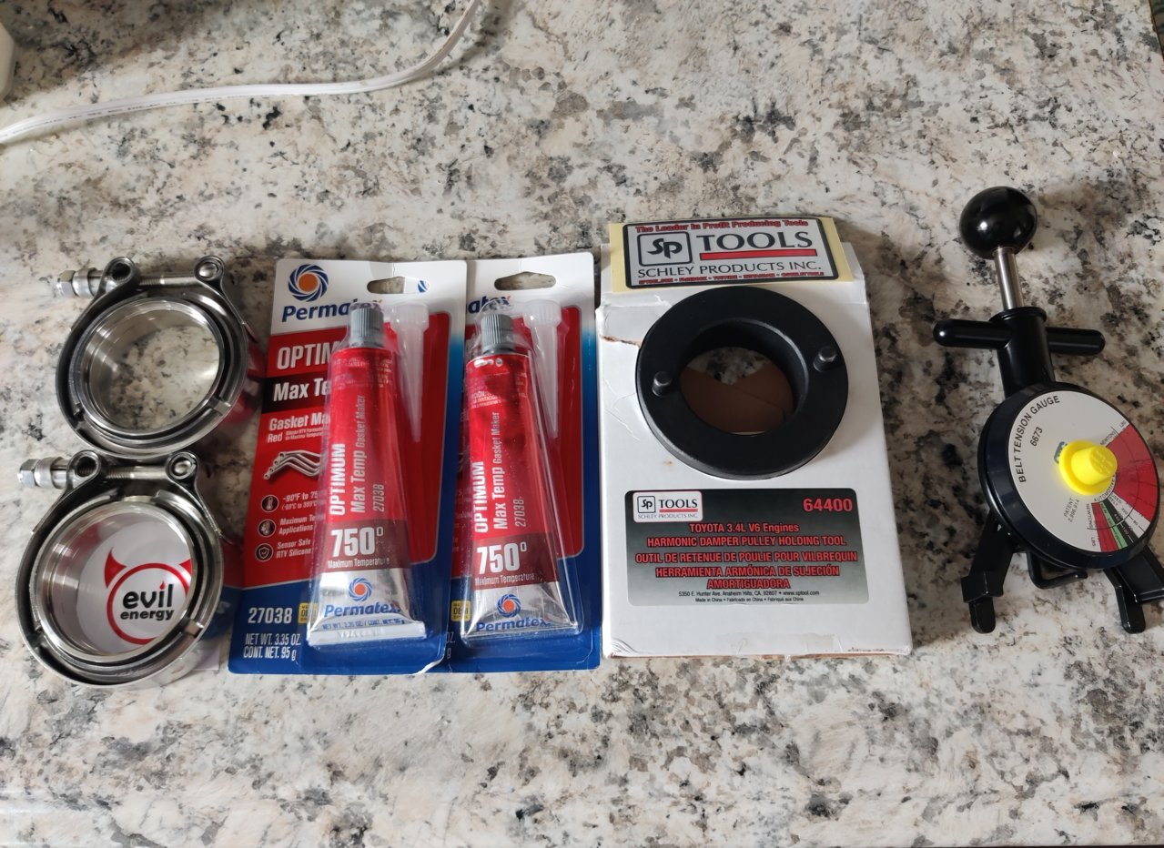

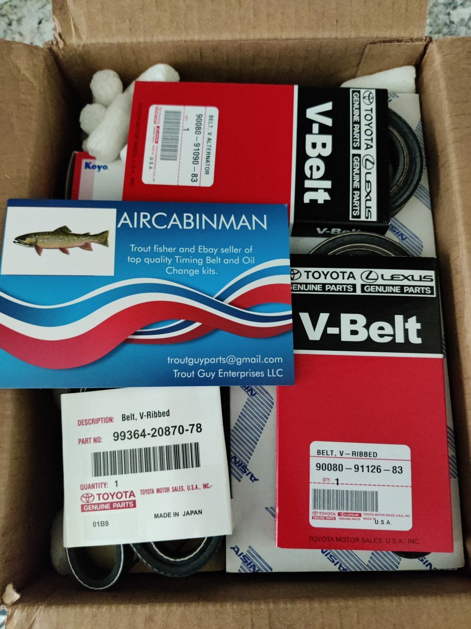

    Timing belt and water pump kit came in.
    I'm going to run out of space on the parts shelf pretty soon
    I still need to grab a 170° Thermostat.
    so glad I put a new thermostat in last year. Now I'll have 3 spares

    I went with one of his kits on my truck and my old IS300, good shit. Too bad he didn't have a 170° thermo for you. I wasn't gonna swap my thermostat just yet, I don't think I'll need to

    I might not "need" to but if it's going to be better in the long run I might as well do it while the system is open and not have to revisit it for a while

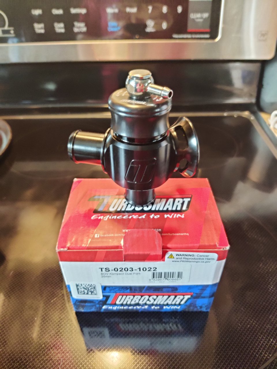

    Turbosmart BOV has entered the purgatory shelf

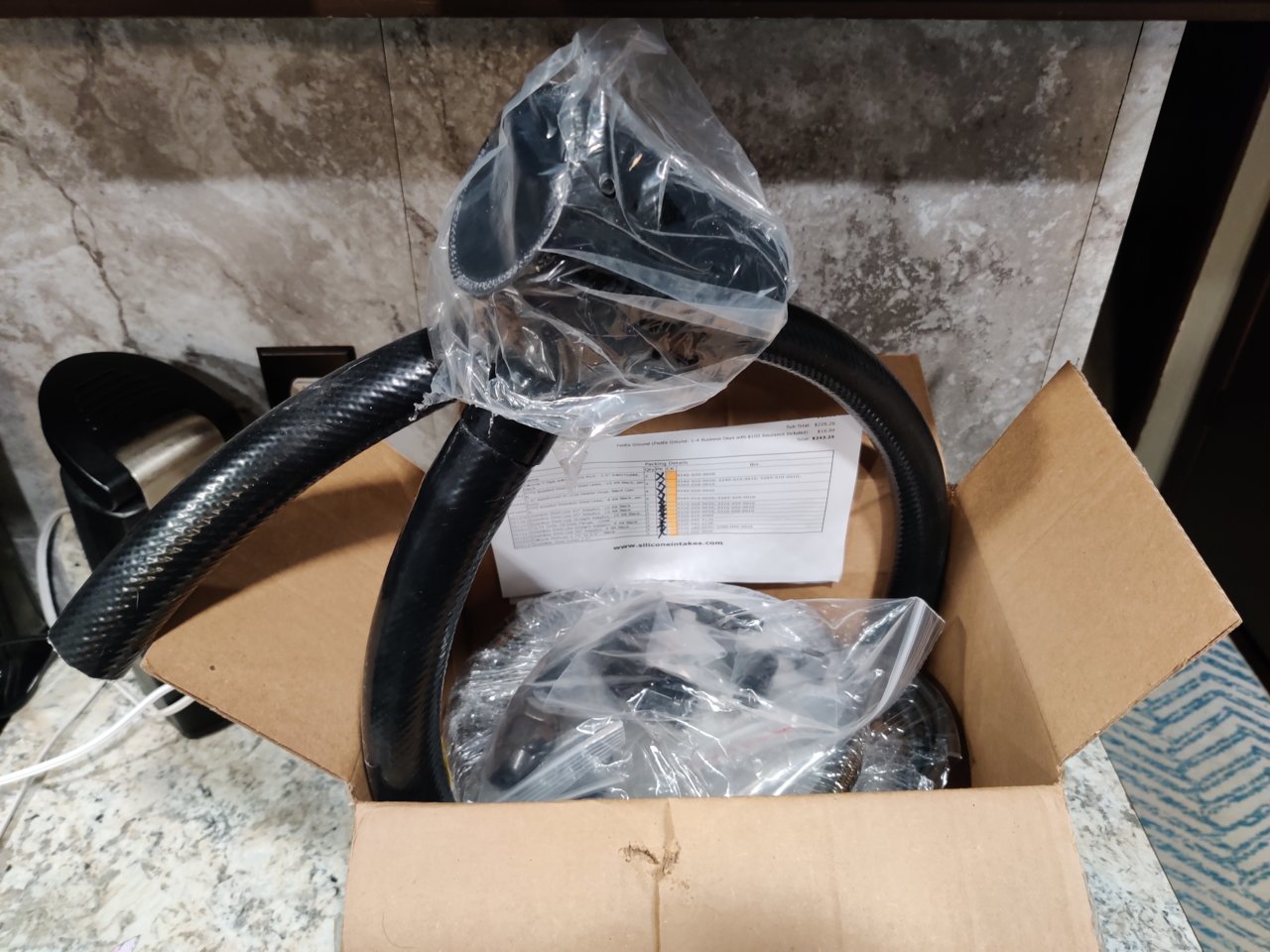

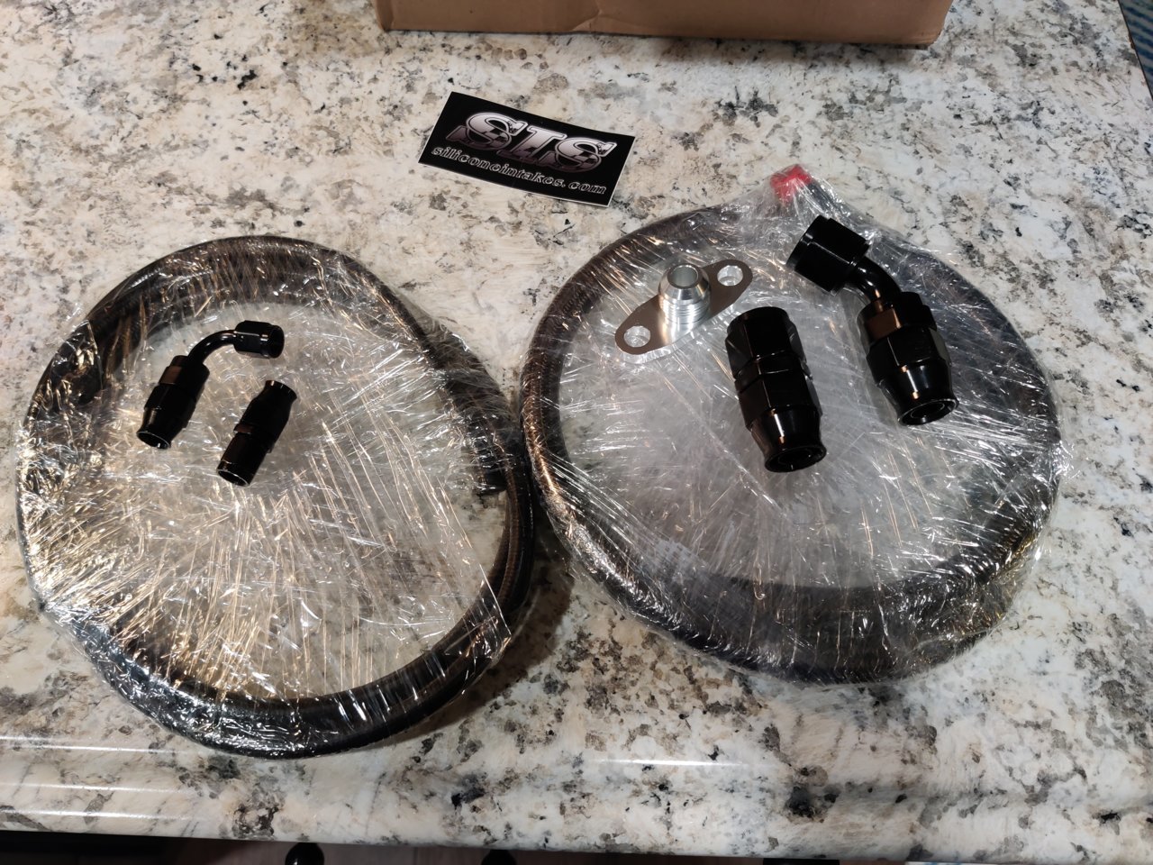

    A few more pieces to the puzzle came today from Silicone Intake solutions
    3ft of 10AN SS line + fittings
    5ft of 4AN SS line + fittings
    Also grabbed 4ft of 1" reinforced Silicone heater hose and connectors for the BOV recirculation
    I should have taken better pictures but that'll do for now.
    I ordered a couple extra fitting just to make sure I have what I need. I also probably should have got some measurements before buying the SS lines for the oil feed and return but hopefully ill have enough.

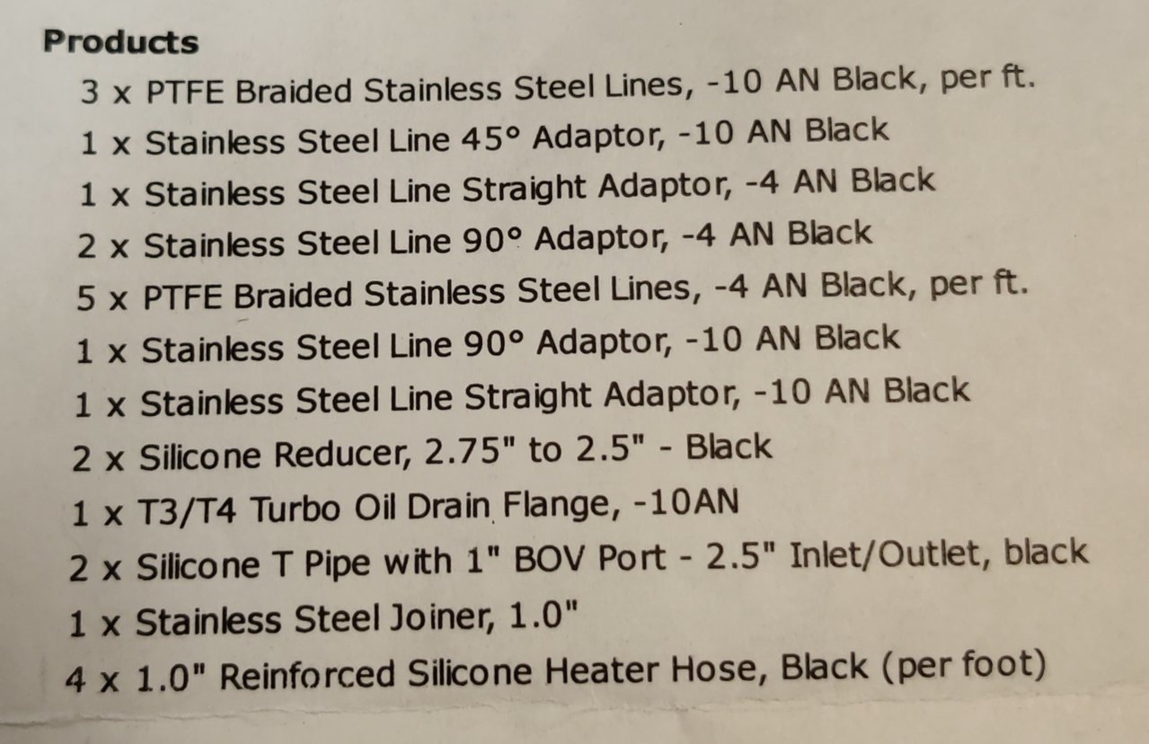

    Here's a complete list of the latest shipment

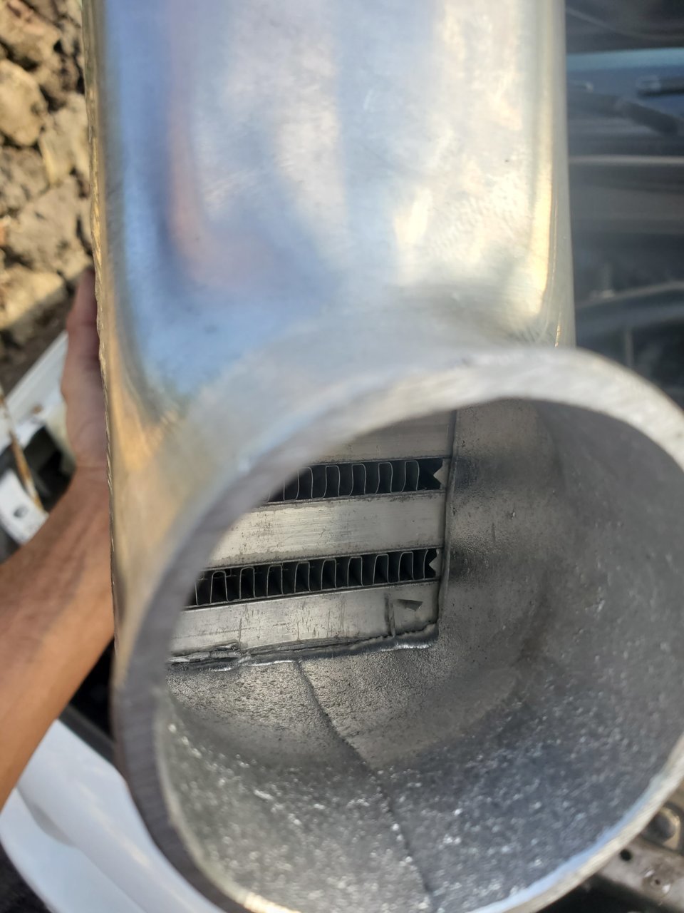

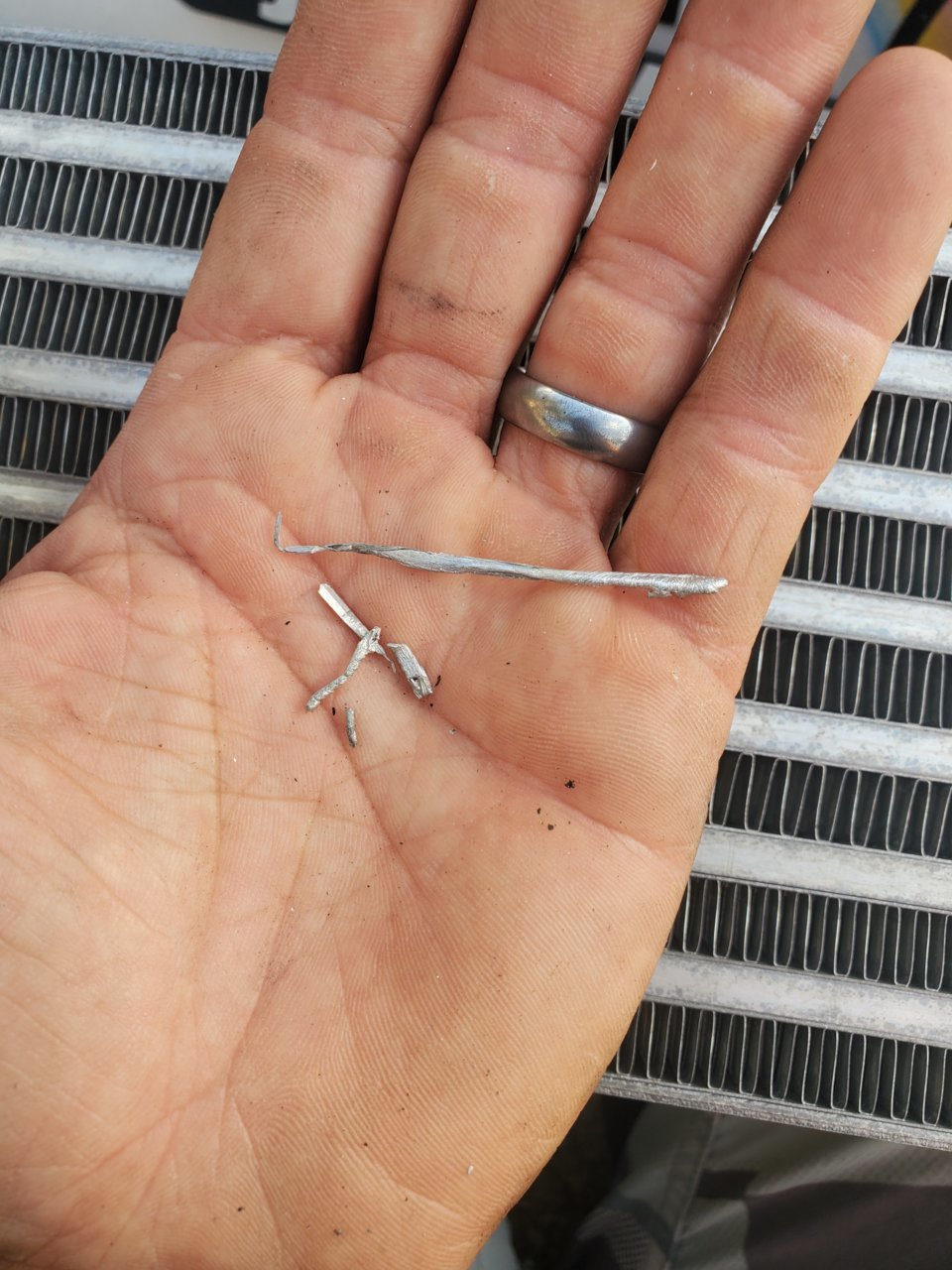

    At least you noticed before hand. I'd still run it. Are you going to keep it shiny or paint it black? I'm contemplating painting mine so it's not so flashy behind the grill

    Will probably hook the shop vac to it. Definitely dont want the new turbo eating that shit.
    I have some air dry cerakote that I may or may not use. We will see. Its black so not sure.
