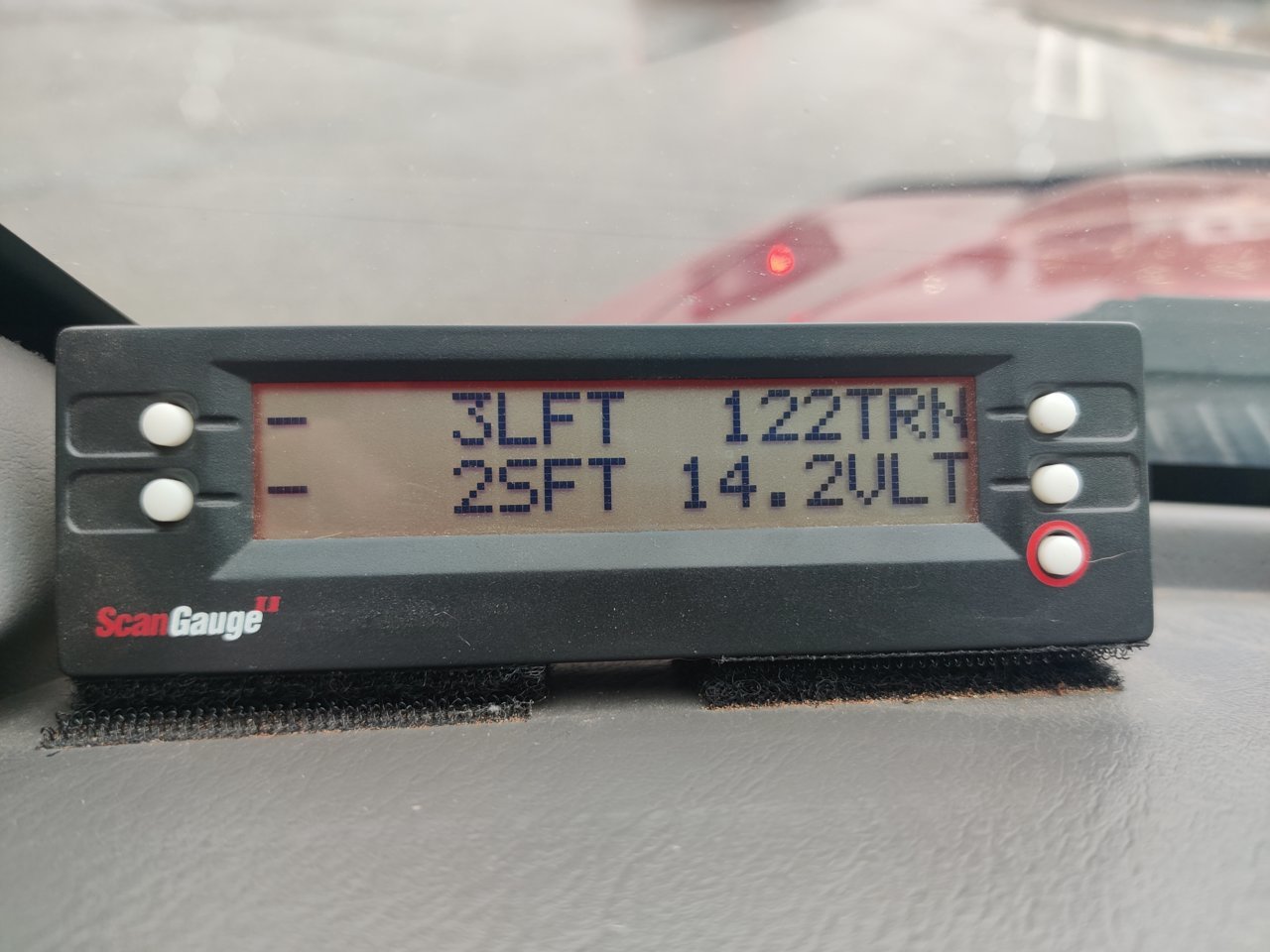

    I finally programed the Scan guage II for long and short term fuel trims

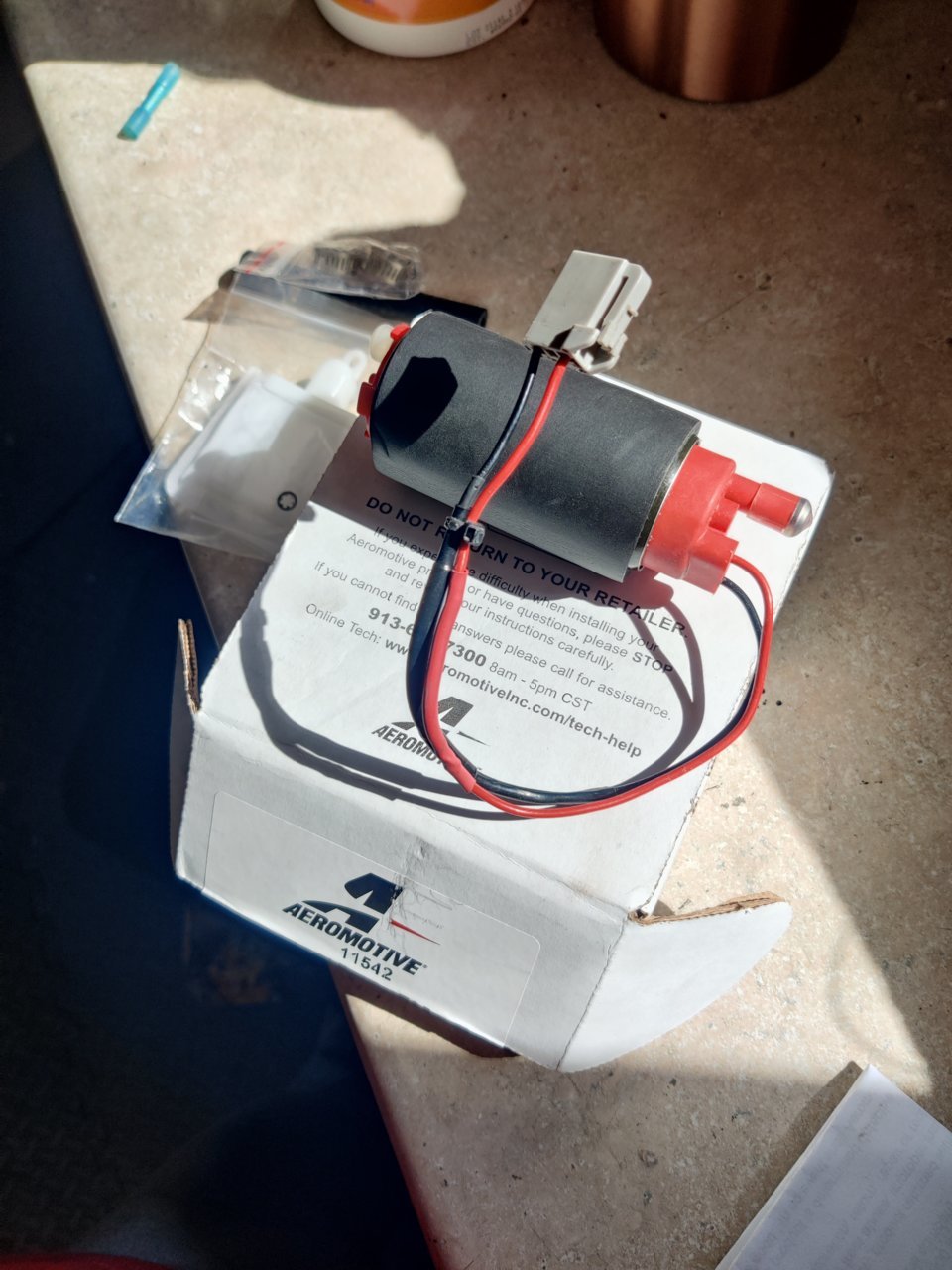

    Got the Aeromotive fuel pump plug and play ready-ish
    Tank is empty now so I guess it's time for that (I probably should have started hours ago instead of procrastinating but I did finally get the frame ground from @Speedytech7 installed so that's nice to have checked off the list. I also happened to notice that the motor ground was disconnected :anonymous:
    My fuel trims seem to be reading more accurately now :notsure:

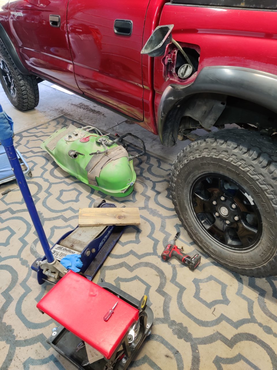

    Said hello to pickle Rick again
    Sometimes I envy the extra cab for its fuel tank access under the bed (and of course the manual transmission)
    It LIVES!

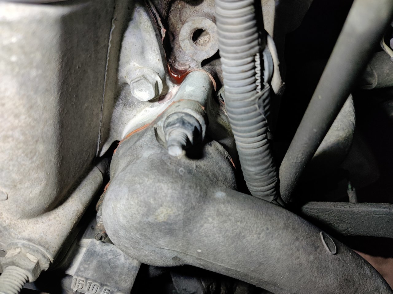

    I think the Water pump is nagging at me
    Good thing I've gathered most of what I need. Except maybe ambition
    MarX and Wulf like this.

    That’s the oil pump….hopefully it’s dripping down and not weeping through the oil pump there. Looks red so best thing would be the water pump.

    Oil pump leaking coolant?

    Sorry. Added to the comment. Just my anxiety from accidentally loosening the oil pump bolt when blindly trying to loosen the lower alternator bracket bolt

    I did just replace the alternator so I could where you are coming from.
    It's definitely coolant, I was actually contemplating adding the oil pump and seals to the timing belt and water pump job so I was wondering if you knew something I didn't when you saw the coolant.
    I still need to see what extra work it would require.
    @Speedytech7 said it's a bit more work but that's literally all I know. I didn't have much luck looking for answers on my quick YouTube search.
    I'd prefer to get any possibly needed maintenance done in one clean sweep instead of opening it back up 6 months down the road.
    I almost took more pictures in the garage today. There's definitely a little oil coming from either the back side half moon or the valve cover on the driver side that's dripping on the header. I've wondered If it has something to do with the exhaust leak blowing right there :notsure:
    It looks to me like the majority of the oil is coming from the oil pan seal but it also seems like there's something leaking around the oil cooler.
    On the bright side the passenger side seems to be dry

    I’m going to blame the small screen of a iPhone mini. Zooming in it’s definitely red. Anyway, the the half moons are doing what they do. Mine were leaking when I did my valve covers with no exhaust leak. it’s probably common seeing that people reseal those when doing valve covers.
    I will say with those coolant leaks in more than one spot it might not be a bad idea to check the valley, especially if you plan on replacing the knock sensors or harness. You’ll also want to check the heater hoses and actuator for the heater core. Mine crumbled when I took the hoses off.
    My lower intake gaskets rusted away and pitted the heads around the coolant passages. It was a tedious process to clean all the gunk up. I assume the coolant was old and started to eat things.
    Just something to look at. Unfortunately, it’s not really possible to just check the valley for coolant without taking it all apart.

    I think you can leave your oil pump alone, I would, in fact I currently am.
