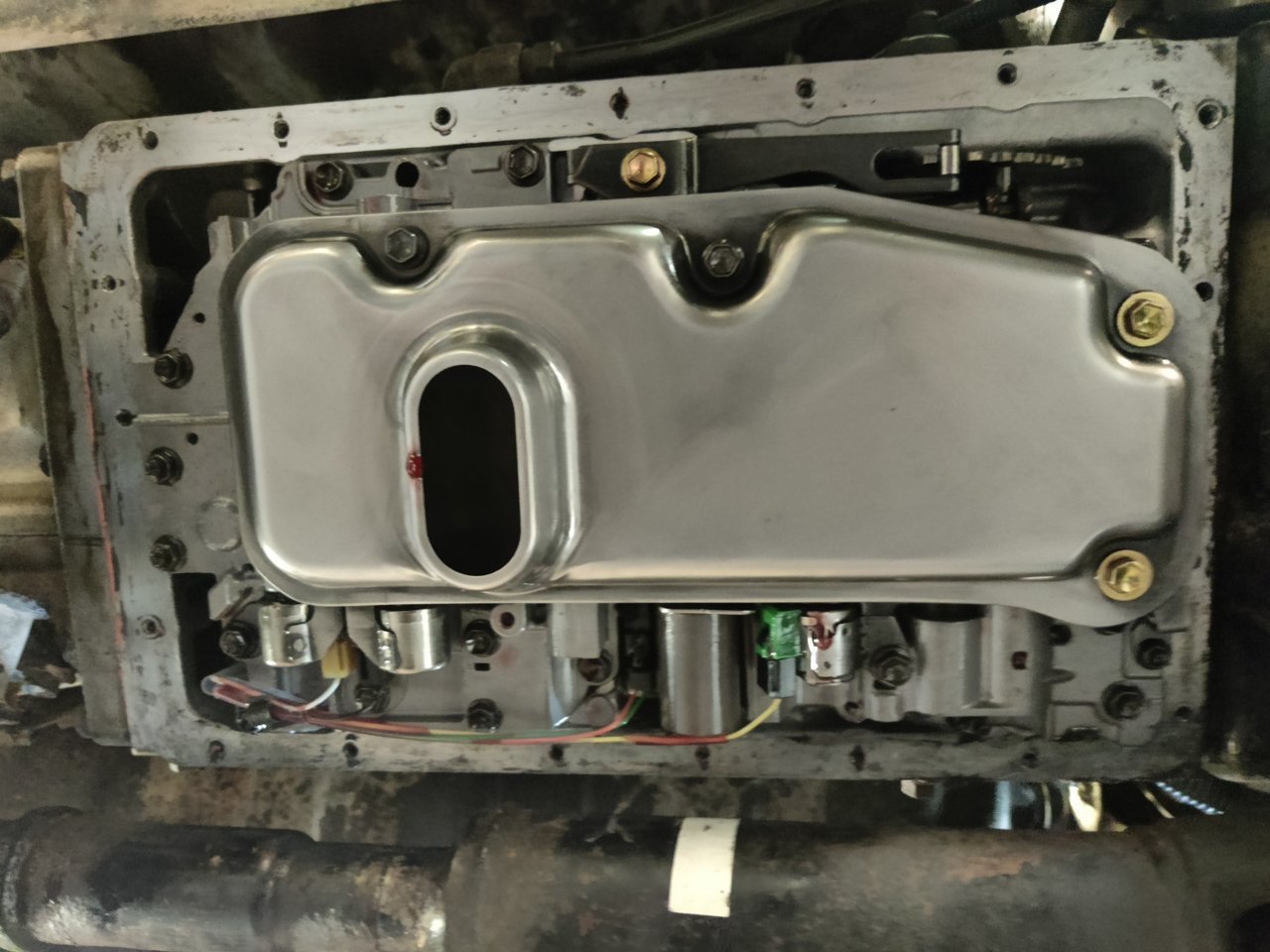

    I just got home, swept out the garage and pulled the drain plug for the transmission. Things are going to happen... In the morning

    Here we go

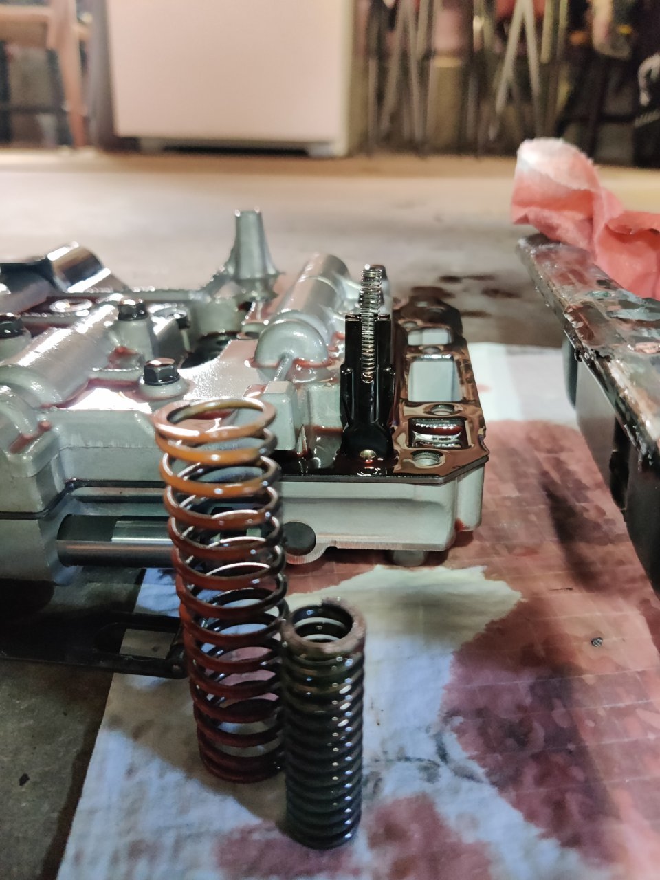

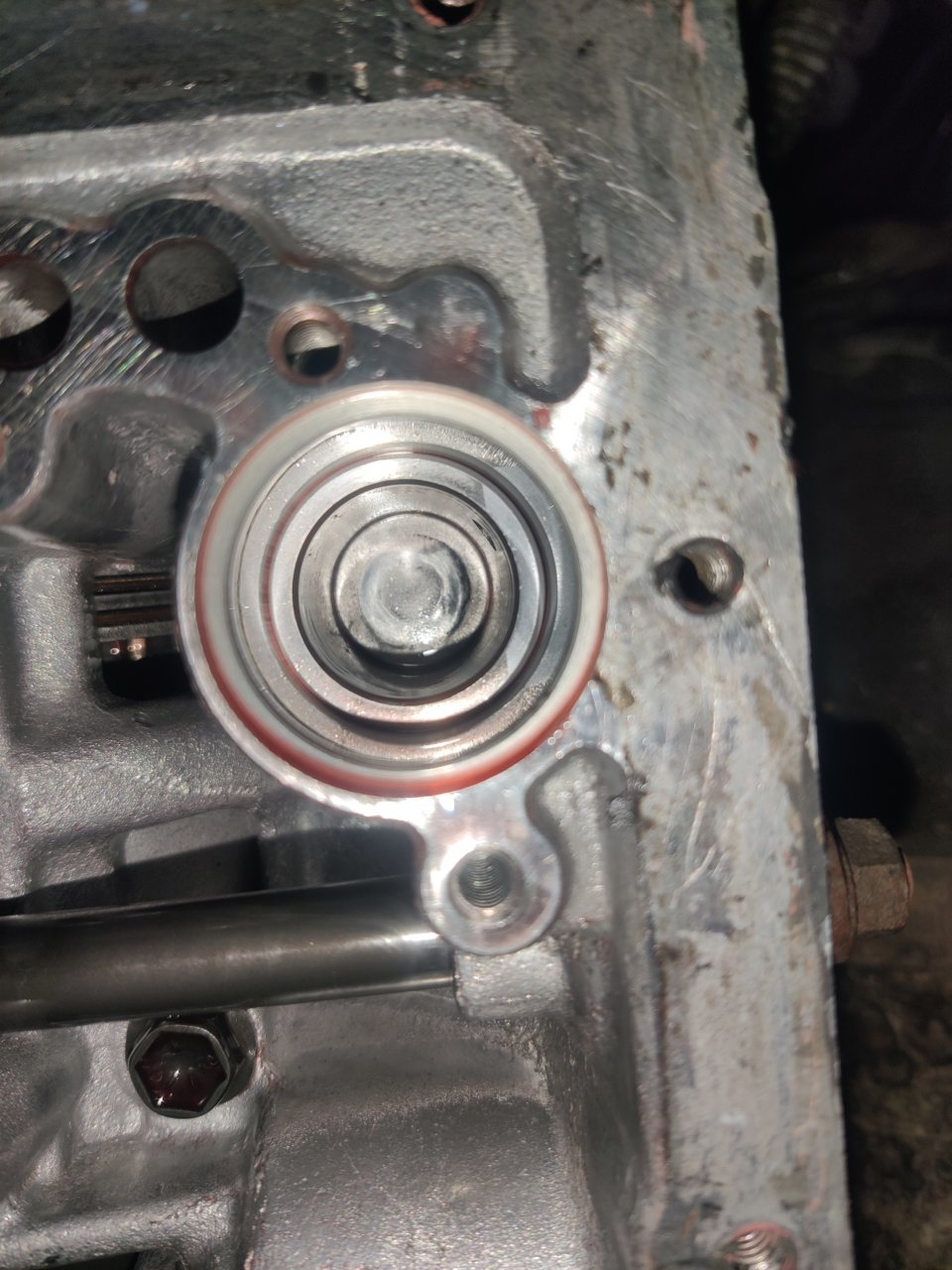

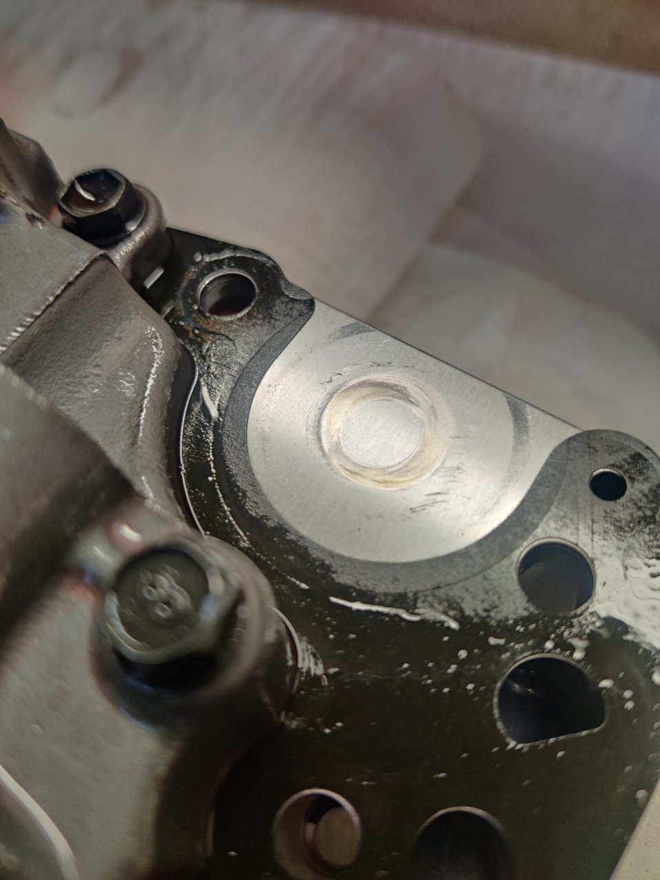

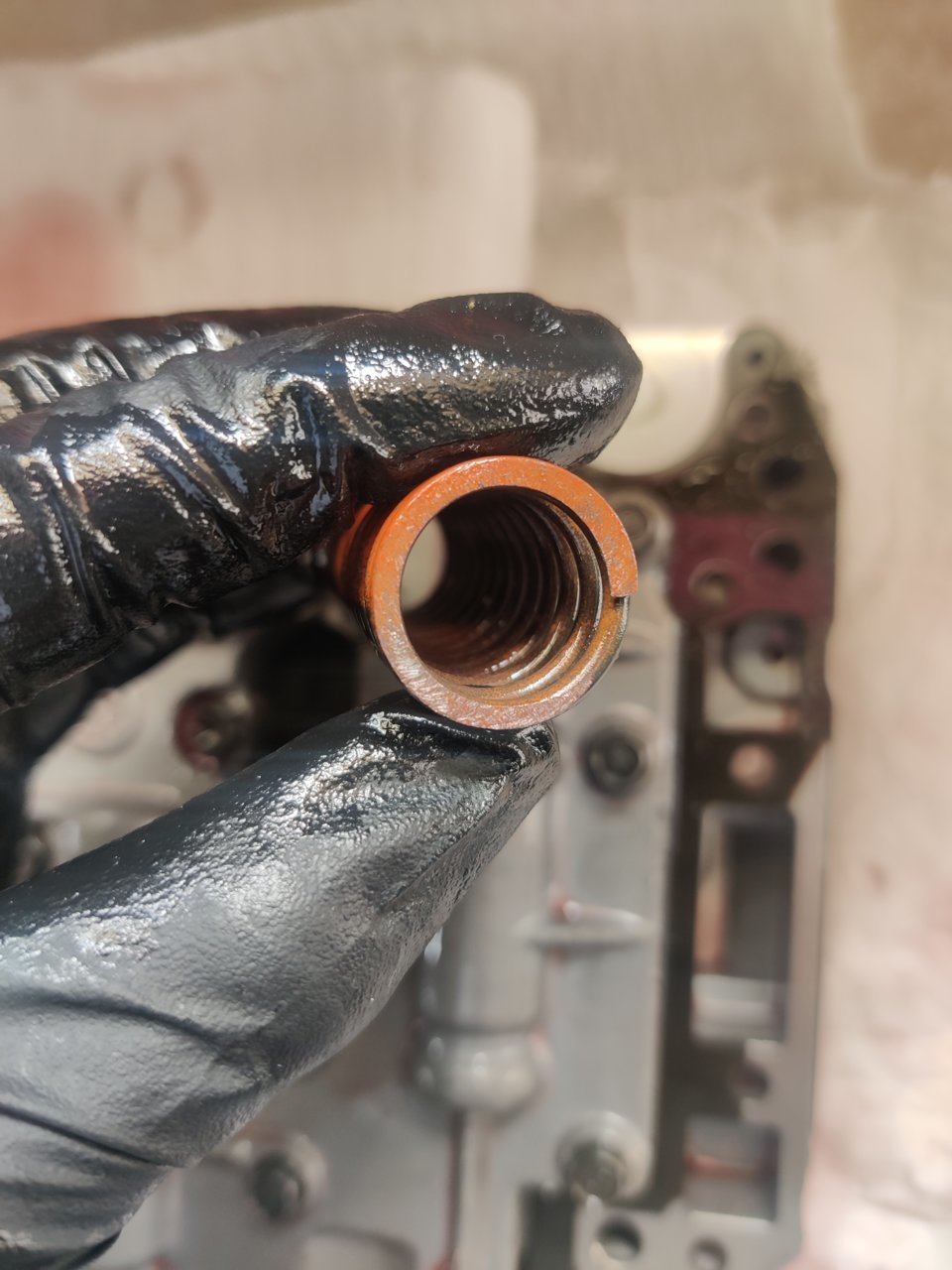

    Here's what fell off the top of the valve body when I removed it from the trans, I'll have to make sure I get them back where they belong when it goes back in.
    It's the fat orange spring and a narrow shorter green spring and the little plastic piece with a ball bearing and a very delicate spring (which I believe goes where it's sitting in the picture but unsure if the exact direction).
    Looks like the green spring possibly sat right here.
    The markings are a perfect fit
    Here's the opposite side in the trans
    It's possible they both sat in the same spot, if you look close and hard it seems like there's another ring of scratches that aren't as distinct.
    The longer orange spring still has paint on the friction surface so maybe it hasn't been moving around enough to wear a mark or rub off the paint.
    That's my best guess and how ill assemble it if I don't find anything to suggest otherwise before it goes back in

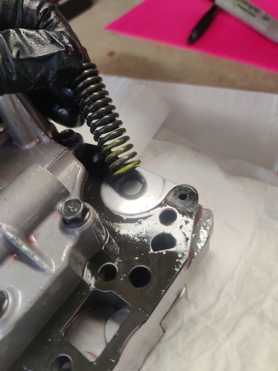

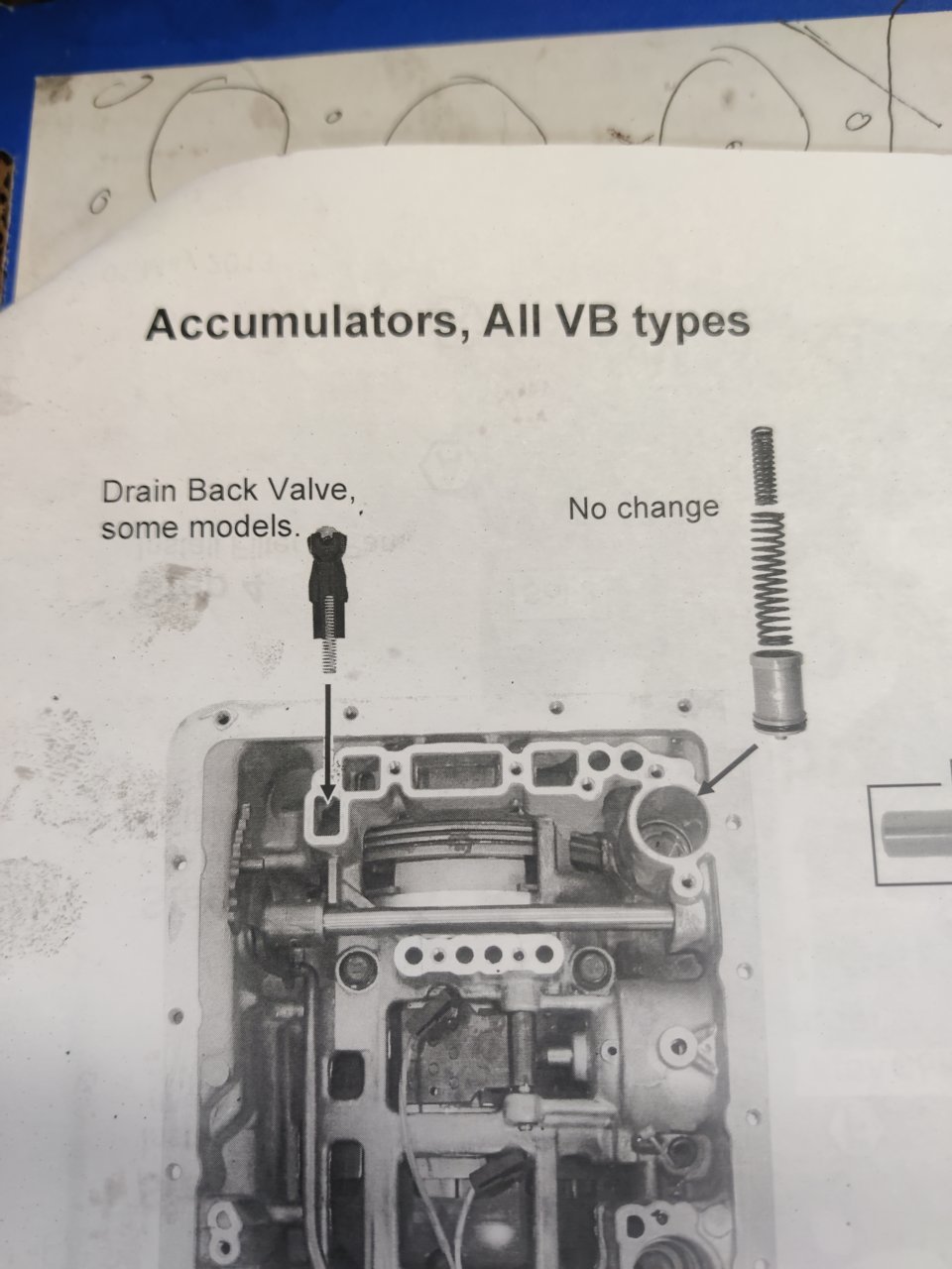

    Well would you look at that, according to the instructions I was right
    The valve body is back together, now onto the actuators.

    Went with the truck settings. Figured its a lot easier to drill the holes bigger down the road if it's not what I want but I think it should be plenty for now
