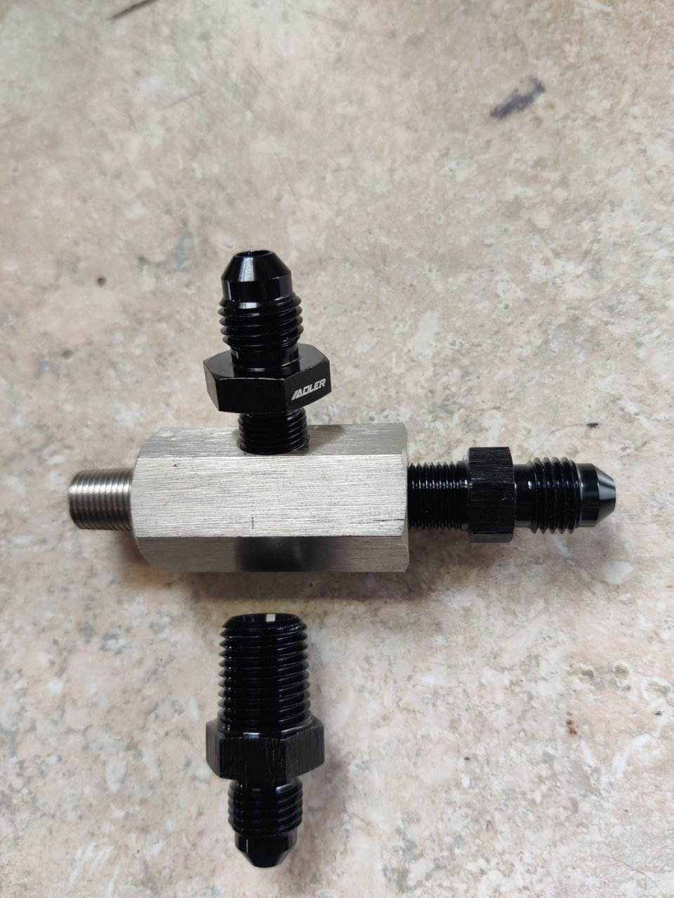

    Double check your 1/8 bspt oil feed tee you got, just got mine in and it didn't have the 1/8 npt on the side like it was suppose to as just a 1/8 bspt tee all around. I was only able to get maybe 1 thread engaged on that 1/8 npt > 4 an fitting. Just ordered the GlowShift one now (should have done that to begin with :censored:...:spending:), but it comes with 2 - 1/8 npt now.

    Just checked it mine out
    The top doesn't like the NPT but it does fit my 1/8 BSP fitting nicely https://www.amazon.com/dp/B07BTH71GJ
    It doesn't seem to want more than just the tip of the NPT or BSPT in the back end though :poking:
    There's probably a thread chaser or tap to make it fit a little better.

    Yea I took a wrench to mine and could get it to go 2.5 turns, but I don't think I could with thread tape on there so I ain't trusting it with the amount of oil pressure coming out of that port. Hopefully the Glowshift one is better.

    I'm just over here jamming a 1/8NPT tee into the BSPT block cause they're so close the brass deforms and seals fine

    I had my NPT And BSPT fitting backwards in that statement so I edited it :anonymous:

    Brass makes sense

    I did stainless to stainless so that might be part the problem :p
