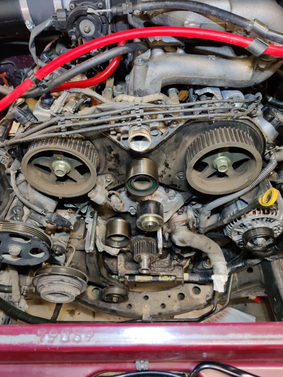

    Looks like a good time to start working on my timing belt and water pump kit.
    Here goes nothing

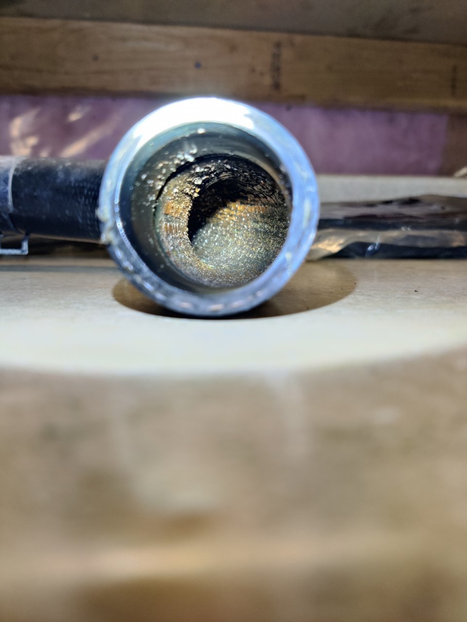

    This looks nasty...
    Upper radiator hose :puke:
    Lotsa chunks
    I want a new radiator and hoses now

    I had that done when I got it a couple years ago. it's mostly just looking like the upper hose is nasty. I'm guessing it's from not always holding fluid so it's allow to dry and crust up but really idk:notsure:

    There's definitely some of what looks like mud in the bottom of the radiator I'll flush it (and the hoses) out as best as I can before it goes back in.

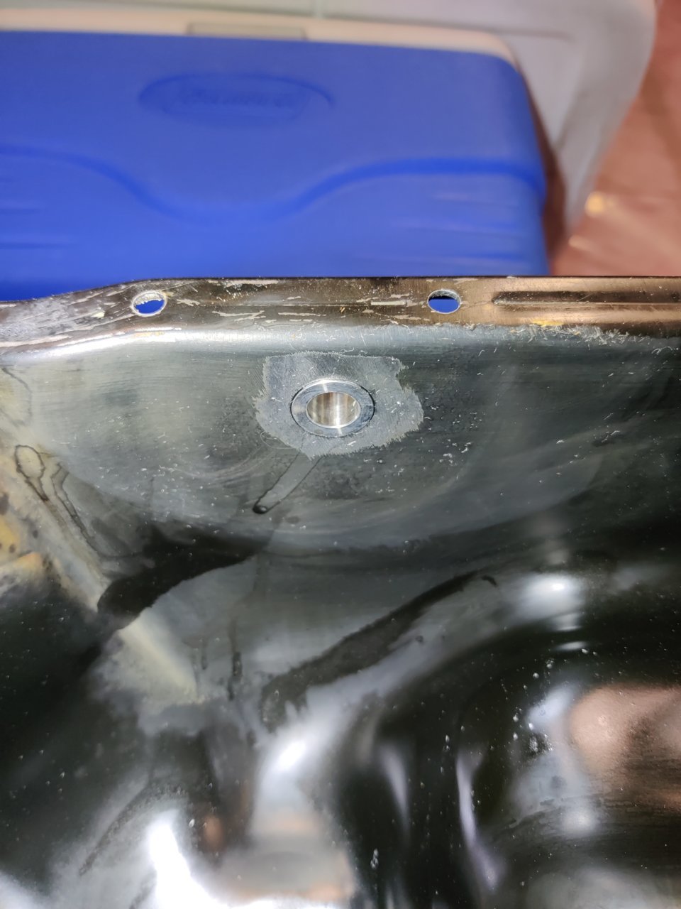

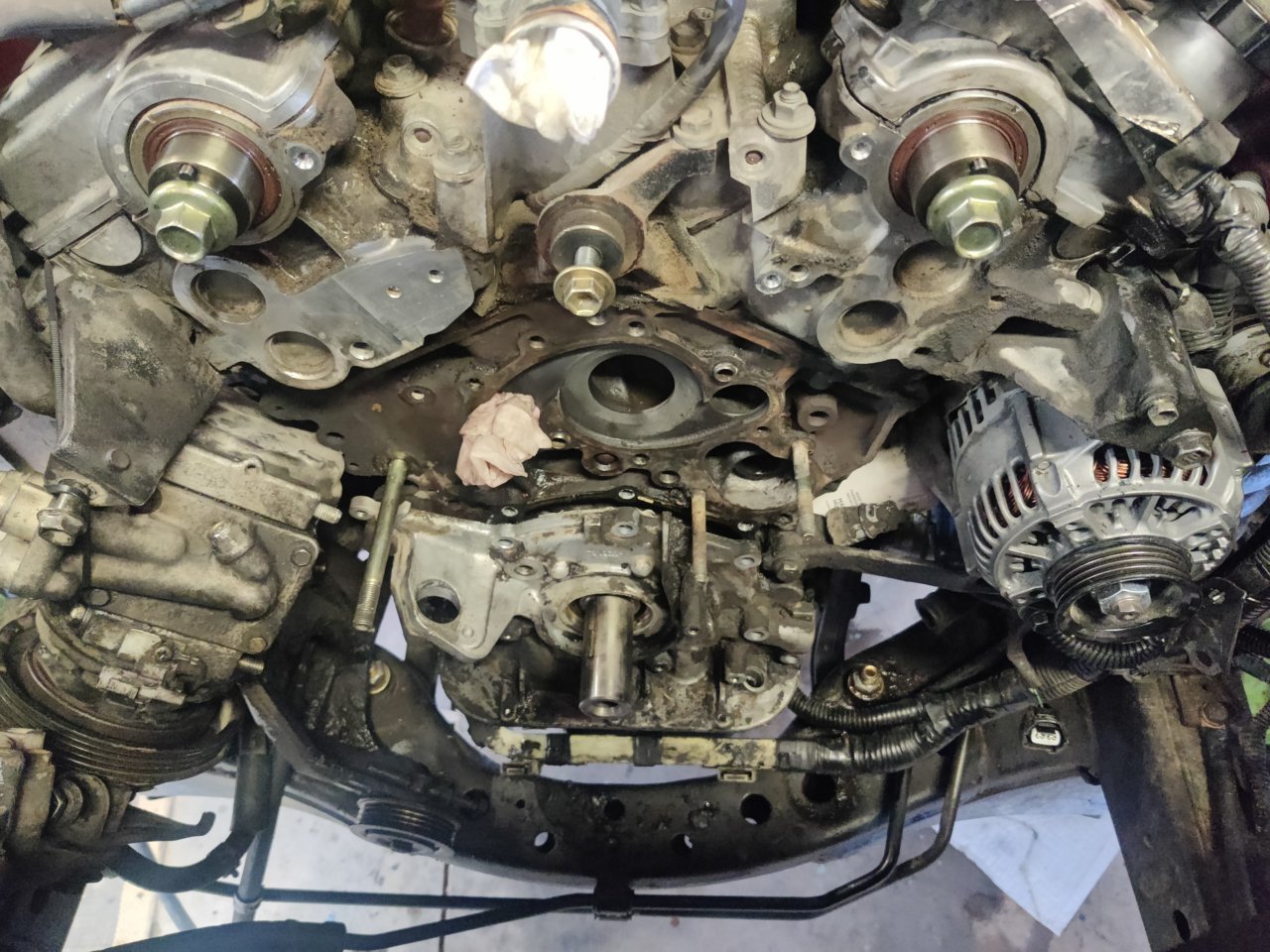

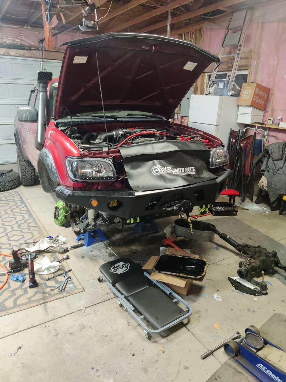

    I made some mistakes... After being told repeatedly not to do the oil pump I decided to put a new one in thinking it would be a few simple bolts...
    I got the AC and power steering is out of the way and the oil pump started to come out but now it's hanging up on the metal oil line inside the pan big oversite on my part.
    So it looks like I'll be pulling the axle and diff and welding in the oil return bung into the pan once I get it out.

    Diff is out, oil pan is off, oil pump is removed.

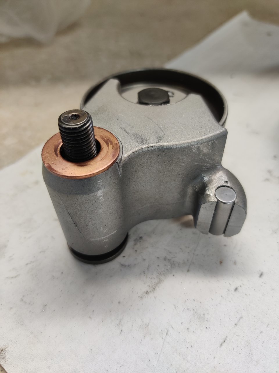

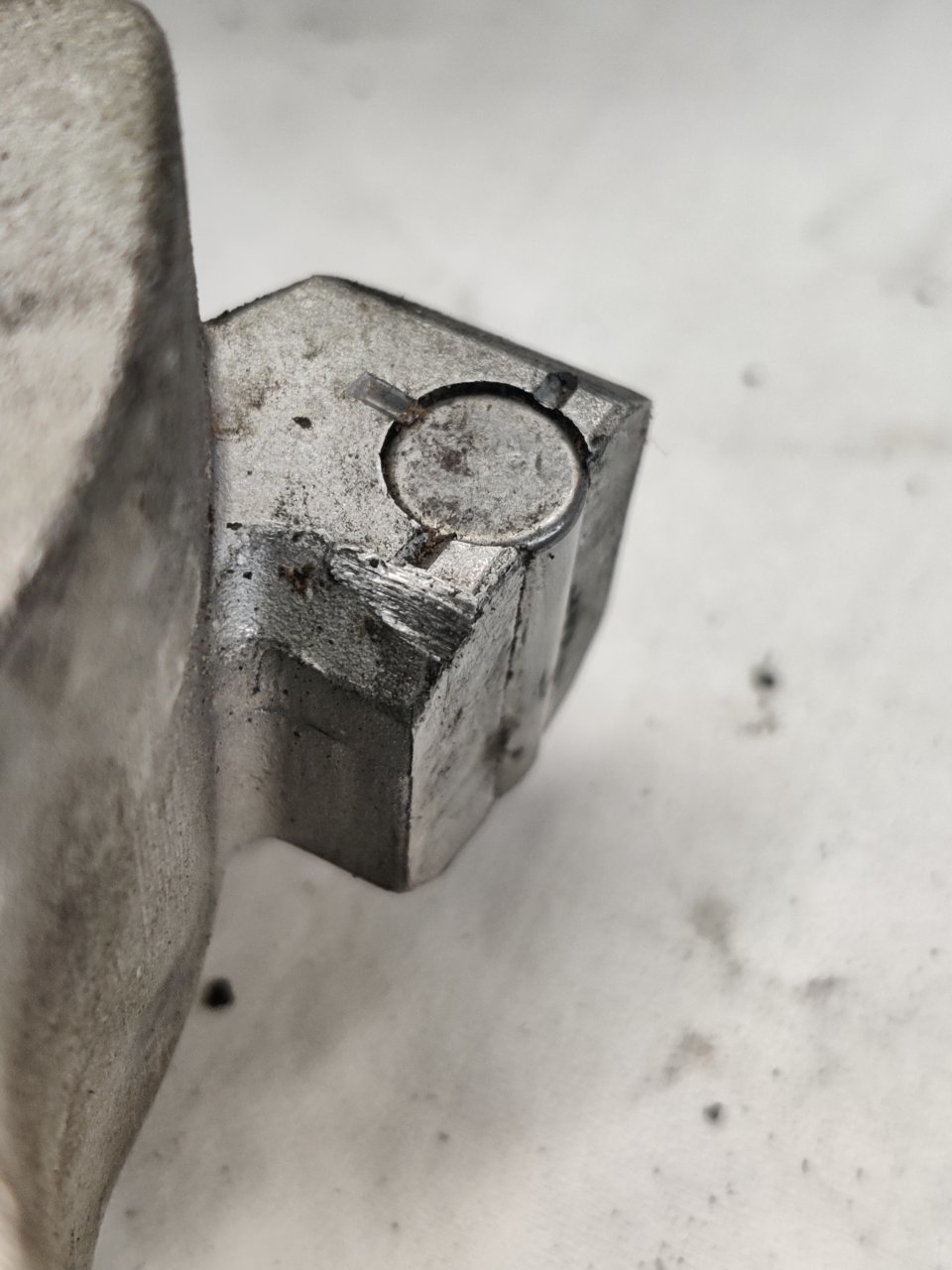

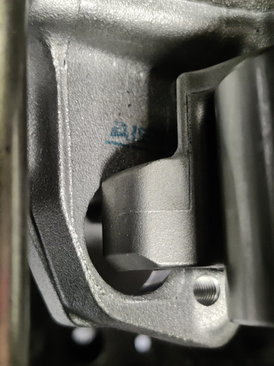

    The front of the motor is all back together except for the radiator and transmission cooler. I did find a little clearance issue on the timing belt tensioner and tensioner pulley that may have something to do with why Timmy the toolman stripped out a bolt in his timing belt video.
    When I was taking it apart I noticed the tensioner pulley wasn't moving freely after the tensioner was removed and that seemed odd but I didn't think much about it until I went to put the new pulley in
    I ended up filing down the edge a little and placed a copper washer between the oil pump housing and pulley and now it moves like it should
    You can see a little wear mark in the cast aluminum on my old oil pump and tensioner pulley so I'm wondering if this is something others have seen as well.
    Not the greatest picture but you can see where it was rubbing and keeping the tensioner from doing it's job properly.

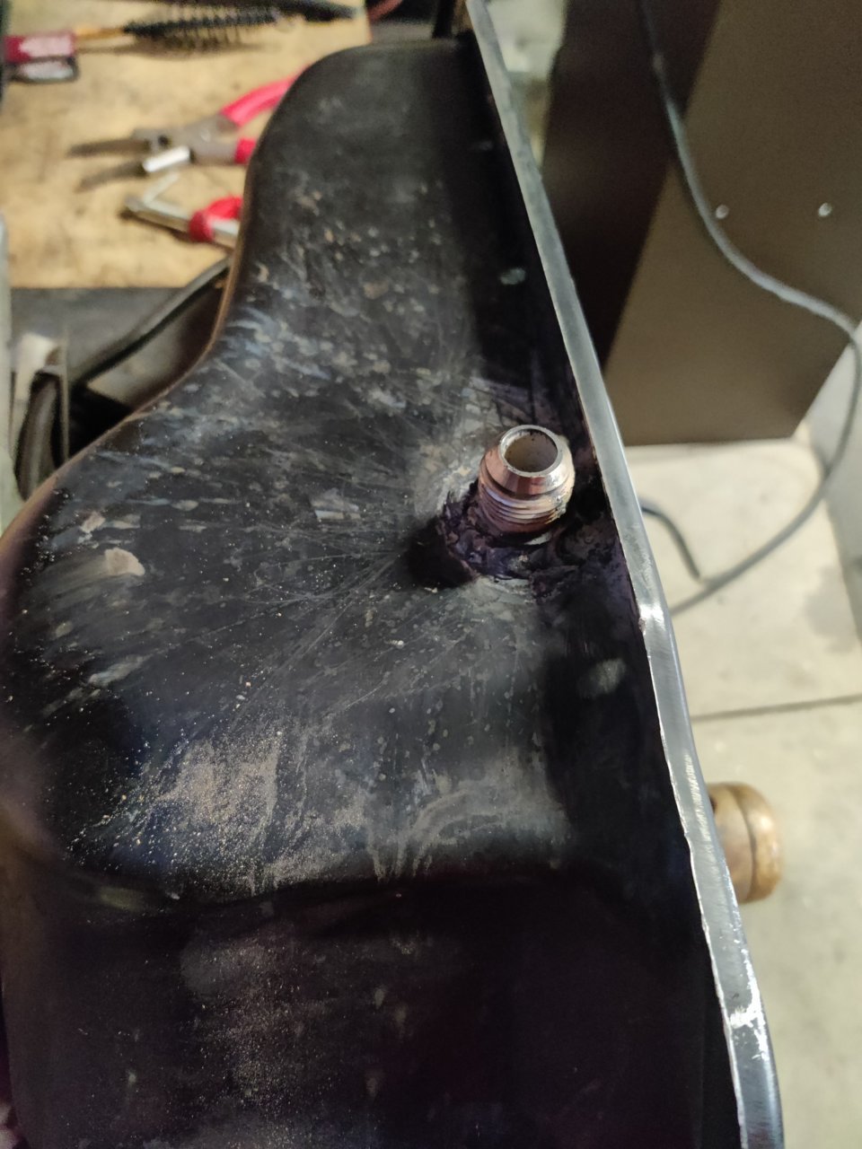

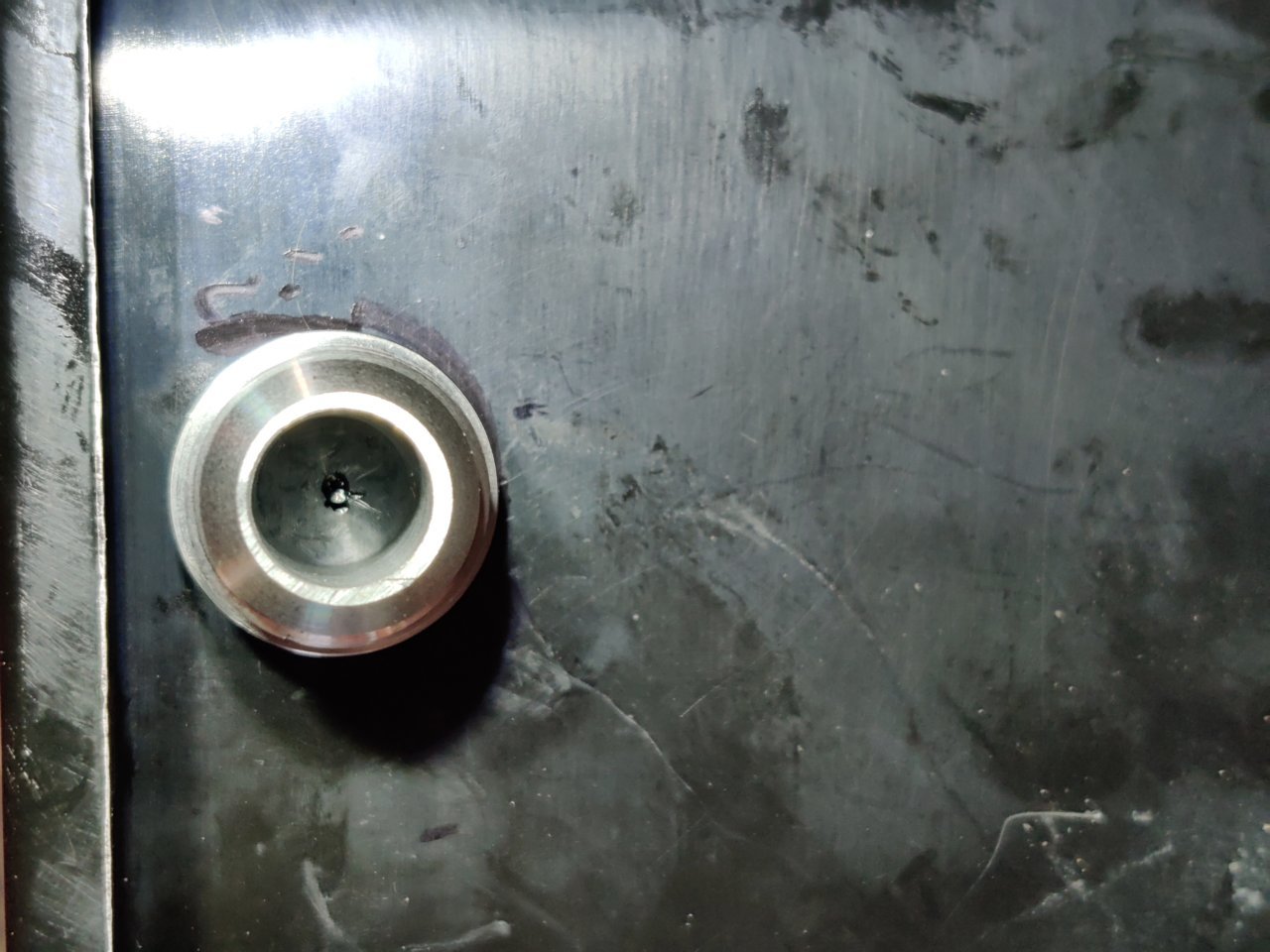

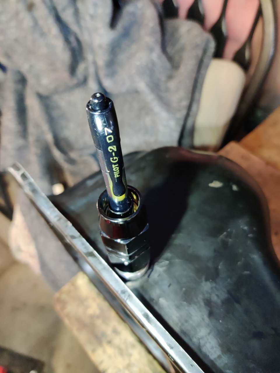

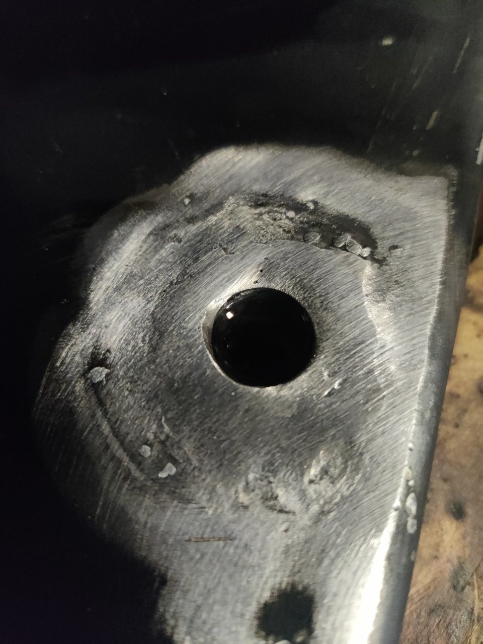

    Oil pan is welded up and we're back on track.
    My pen fit perfectly inside the AN10 fitting for a center punch mark
    Drilled a pilot hole and then used a step bit to finish of the hole
    Might not be Perdy but so far it seems to be doing the trick and it means more to me when I can do it myself

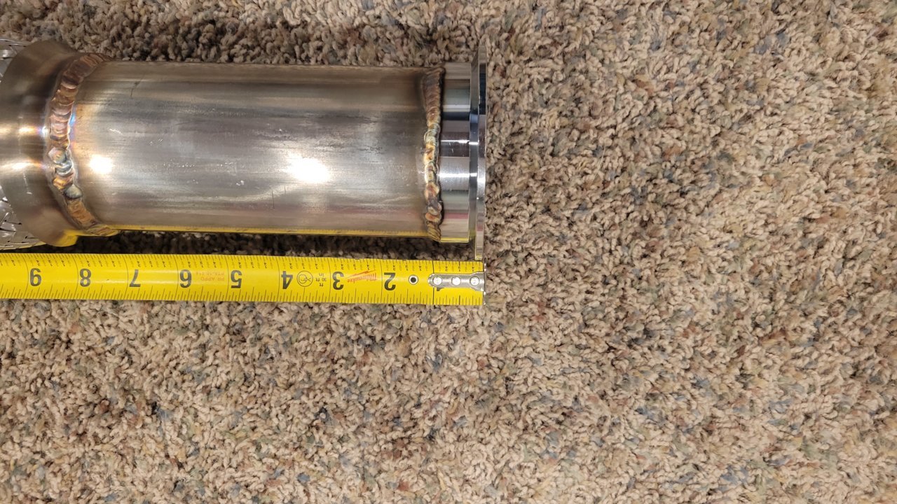

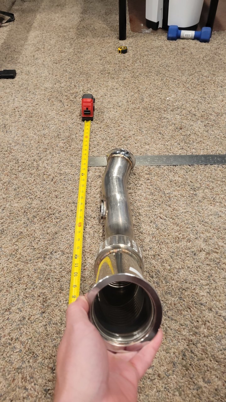

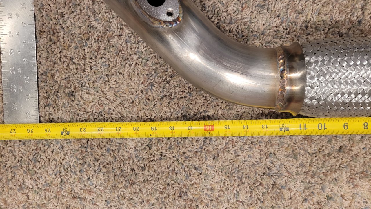

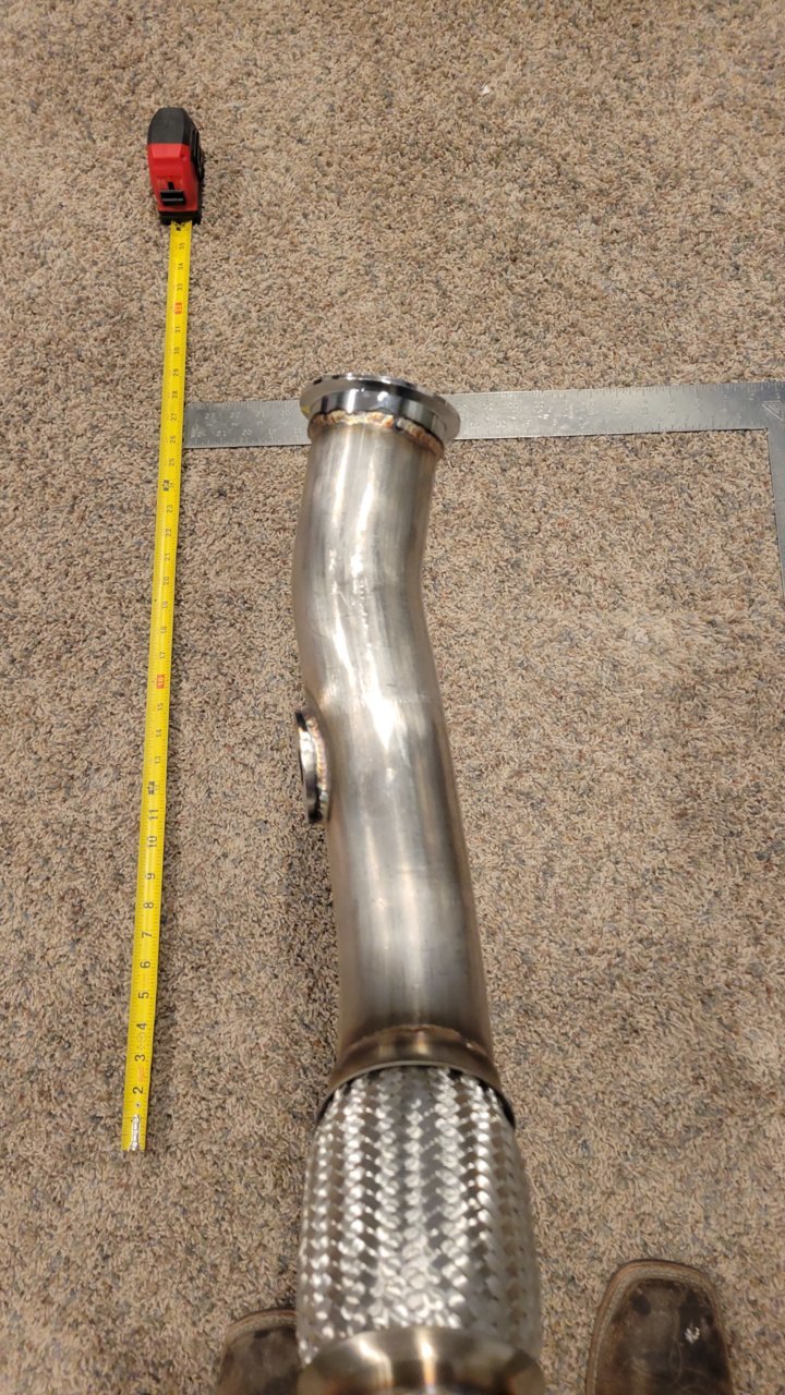

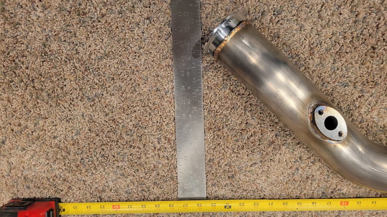

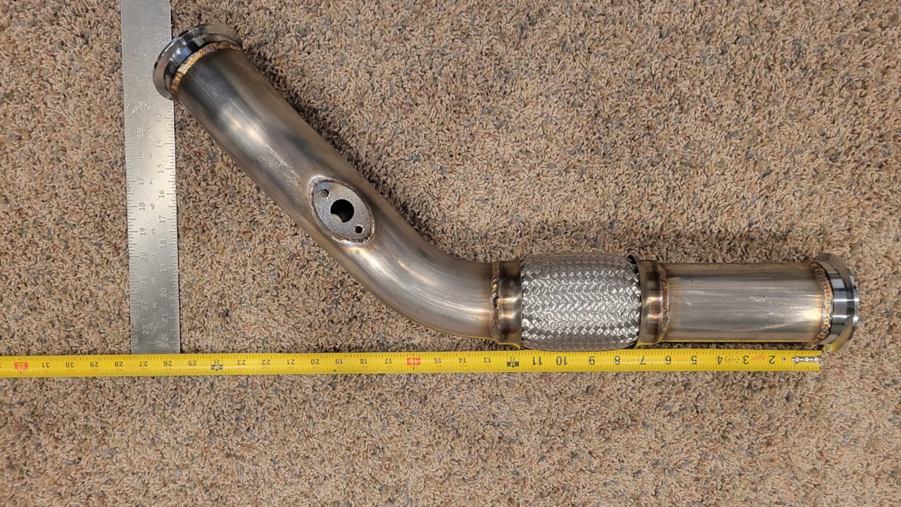

    @GoJo would it be possible to get some measurements and pictures of that CX down pipe?

    These help? Let me know if you need more specifics

    Beautiful thanks a bunch. If you were closer I'd just steel it from you so they could clone it
