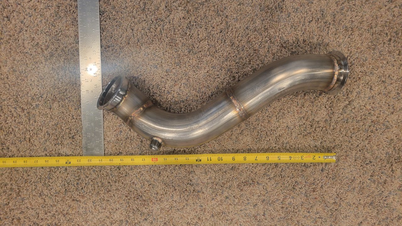

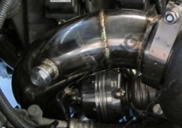

    I just realized that I didn't take pictures of the other portion of the DP (the one that actually attached to the turbo first) seen here:
    its all sorts of custom curved but let me know if you need more pictures

    I'm pretty sure ill end up with a mandrel bent piece of pipe it's just good to know what to expect before hand. I just want to slap it together already

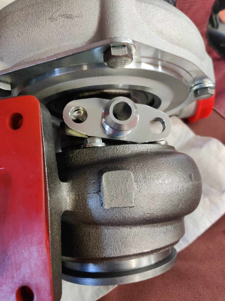

    Did your 10an oil return flange you got from siliconintakes fit your turbo? Mine doesn't, turbo mounting holes are narrower than that t3/t4 oil return flange, im going to drill out new holes and see if that will work or just use the one that came with the turbo and run a short bit of hose to then connect up to the PTFE line.

    Yea, the oil return flange holes on my turbo were 1.5 inch on center, the flange fitting from siliconintakes was 2 inch. I found another one that will work, or ill just drill more holes.

    Sucks about the AN fitting, there's probably something else out there to fit correctly. I'll have to bust out the caliper and take some measurements

    I looked all over for that an fitting for the oil drain line and couldn't figure out where the hell I put it and then found it in a bag of hardware I planned on not using so I guess I noticed it was a bad fit at some point IMG_20230428_170912.jpg
    That thing is too big and too small at the same time

    haha right! Isn't the diameter too small as well? I think could make it work drilling mounting holes the right 1.5 apart, but the diameter of the drain was also questionable

    It was bad all around I'd trust the supplied barb fitting over that ANy day
