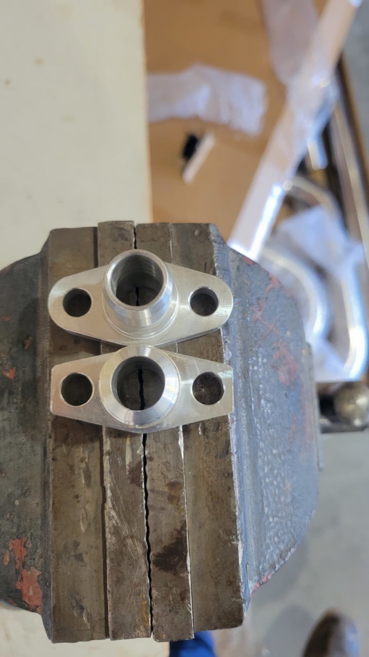

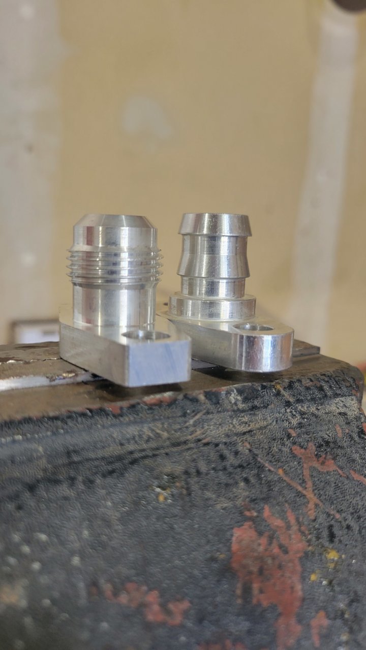

    Yea, I worry about the mount bolts interference with the an threads, preventing seal.
    I found this, which seems to possibly solve that issue... maybe
    CXRacing Oil Drain Flange AN 10 AN10 GT35 https://www.amazon.com/dp/B00H96BZAW
    Which begs the question of why it didn't come with the kit...

    That should do it, and it definitely should have been with the kit.
    After shipping it's cheaper than what I found and it's expected delivery would be faster too.

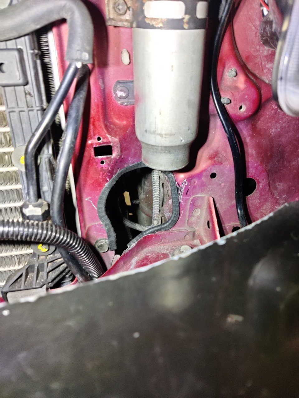

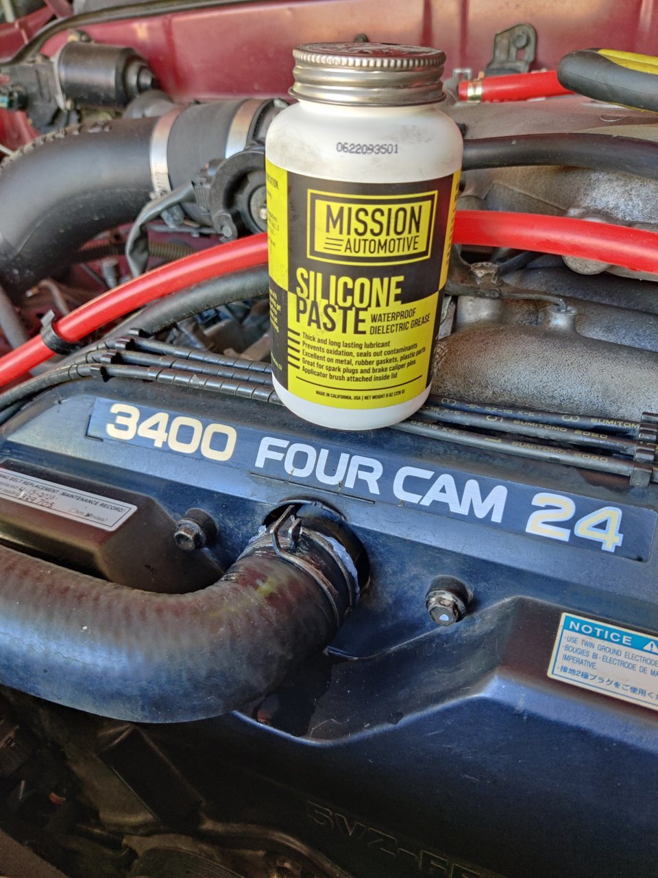

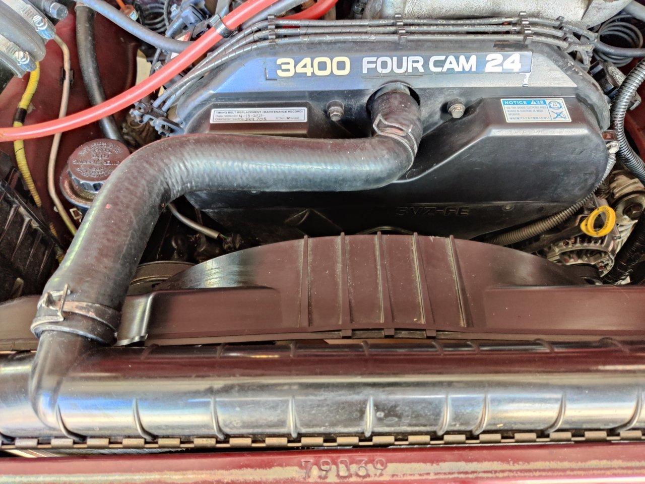

    Swapped out my leaky upper radiator hose. Couldn't get the exact hose I wanted. apparently it's on back order but this will work for now.
    This hose must be slightly thicker, I had to fight the constant tension clamps to get them back on.
    A little Silicone grease made a big difference
    It's already starting to feel hot in the garage during the day. I would like to get this turbo situated before it gets much worse

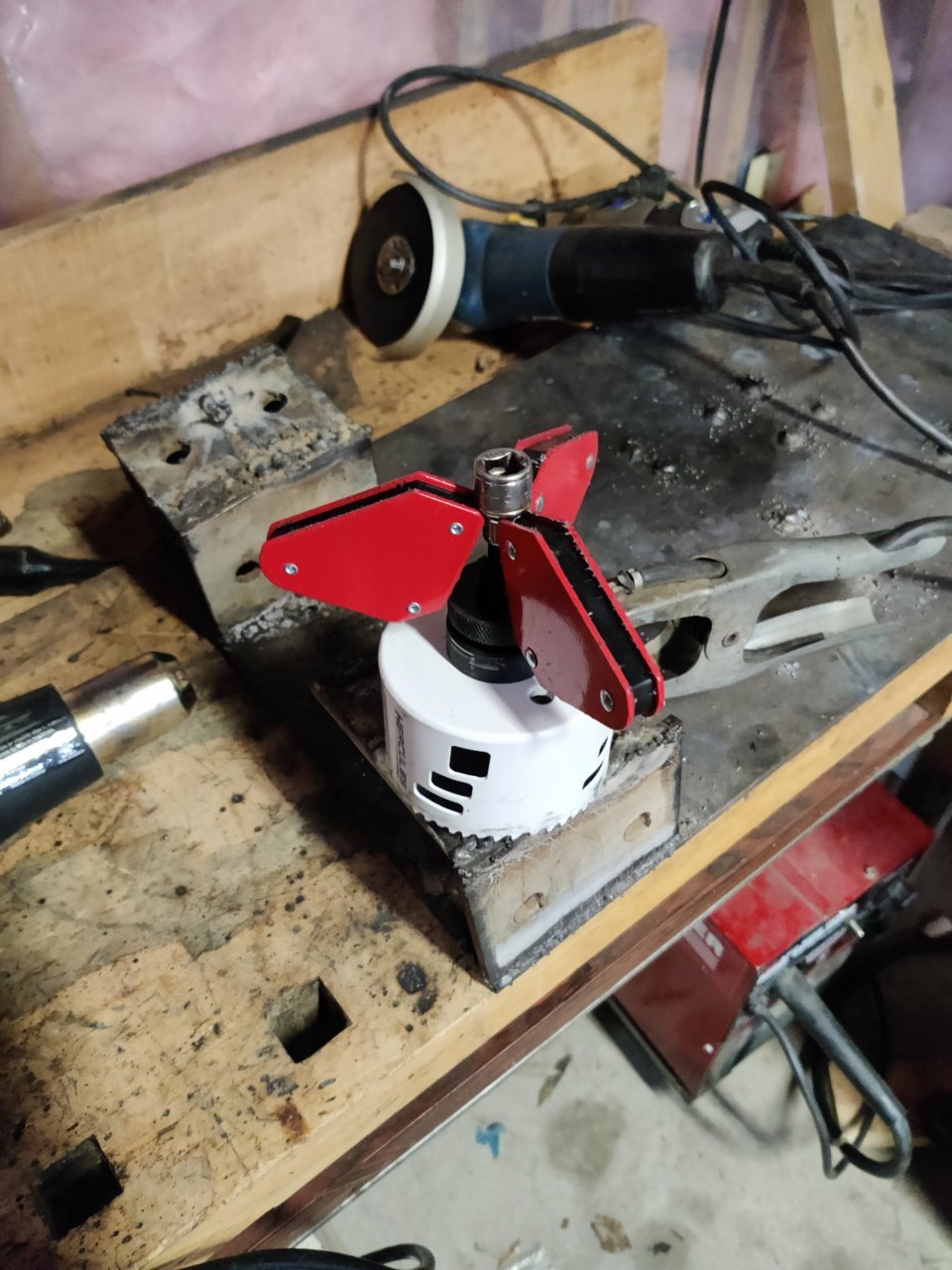

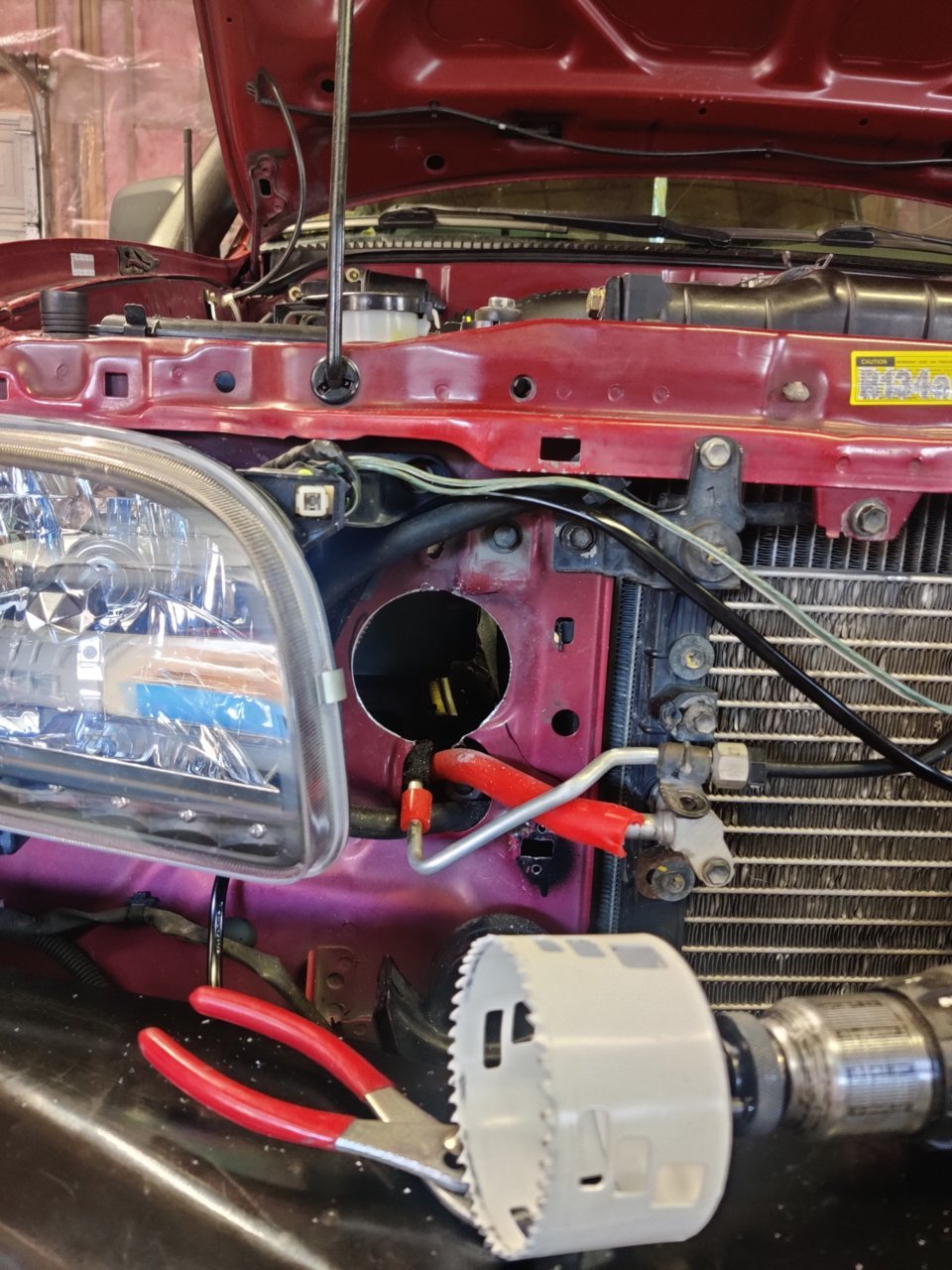

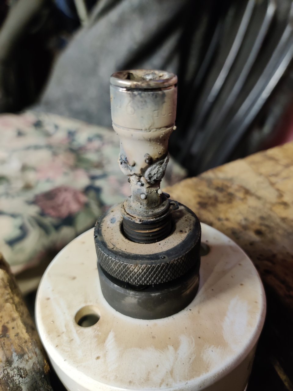

    I made another baby step of progress last night
    Sure was a PITA getting the drivers side hole for the charge pipe. Ended up using a dremel, Sawzall, and a couple files after giving up on the 3¼ hole saw.
    I really didn't want to drop the bumper and winch or it would have been much easier
    I attempted to use the ratchet with the hole saw a couple times but it wasn't very fruitful
    The 9mm socket was a little too loose so I wrapped the bit with some electrical tape for a better fit and that helped a little but was still not great so I tried for a little more permanent solution
    This also wasn't great and didn't end up very straight so it was even more all over the place but it was fun playing with the welder regardless
    This is when I got the Sawzall out haha
    MarX and Speedytech7[QUOTED] like this.

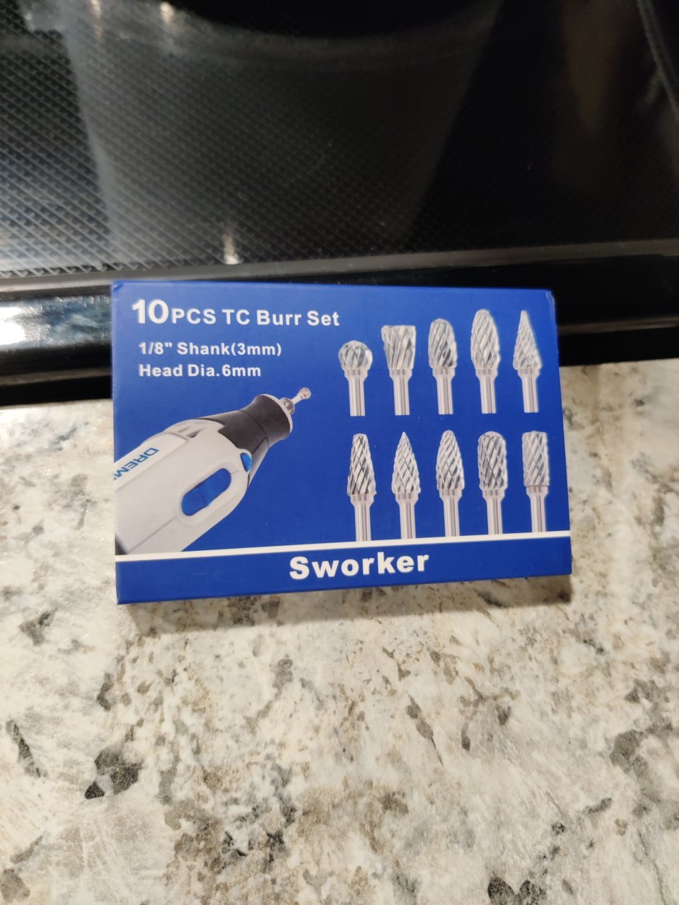

    These would have made my job a lot easier last night
    Planning on using these on the internals of the CX manifolds
    MarX and Speedytech7 like this.
  19. May 17, 2023 at 8:57 PM
    #359
    GoJo
    GoJo Well-Known Member
    Mar 6, 2014
    #124740
    546
    Utah
    Same ones I got, they worked nicely, tiny little metal shavings EVERYWHERE!
    Wulf, MarX and unstpible[QUOTED][OP] like this.
