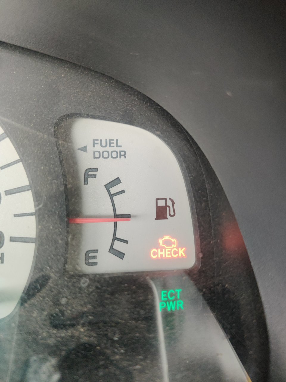

    I've been wondering how long it would take for the P0420 code to pop back up (leaking DT header crossover pipe) apparently today was the day
    now the turbo install can be considered
    "required maintenance"
    :evil::yes:

    Haha nice. I popped that pending fault today too.... hopefully tighten up them cross overs today gets rid of it..

    Yea, pending p0420 popped up the other day for me when I scanned. No CEL light though

    The 420 code is a fickle beast

    Yea, it was the only incomplete on my emissions page... so technically would still pass :)
    I assume its likely due to the high flow cat, and larger than stock diameter pipe the o2 sits in now. May mess around with some o2 spacers at some point but we'll see.

    Yeah most likely, the emissions monitors are pretty strict with expectations for post cat readings. None of the high flow cats have enough media to satisfy them or a sniffer reading, but they're good for reducing the smell for sure.
