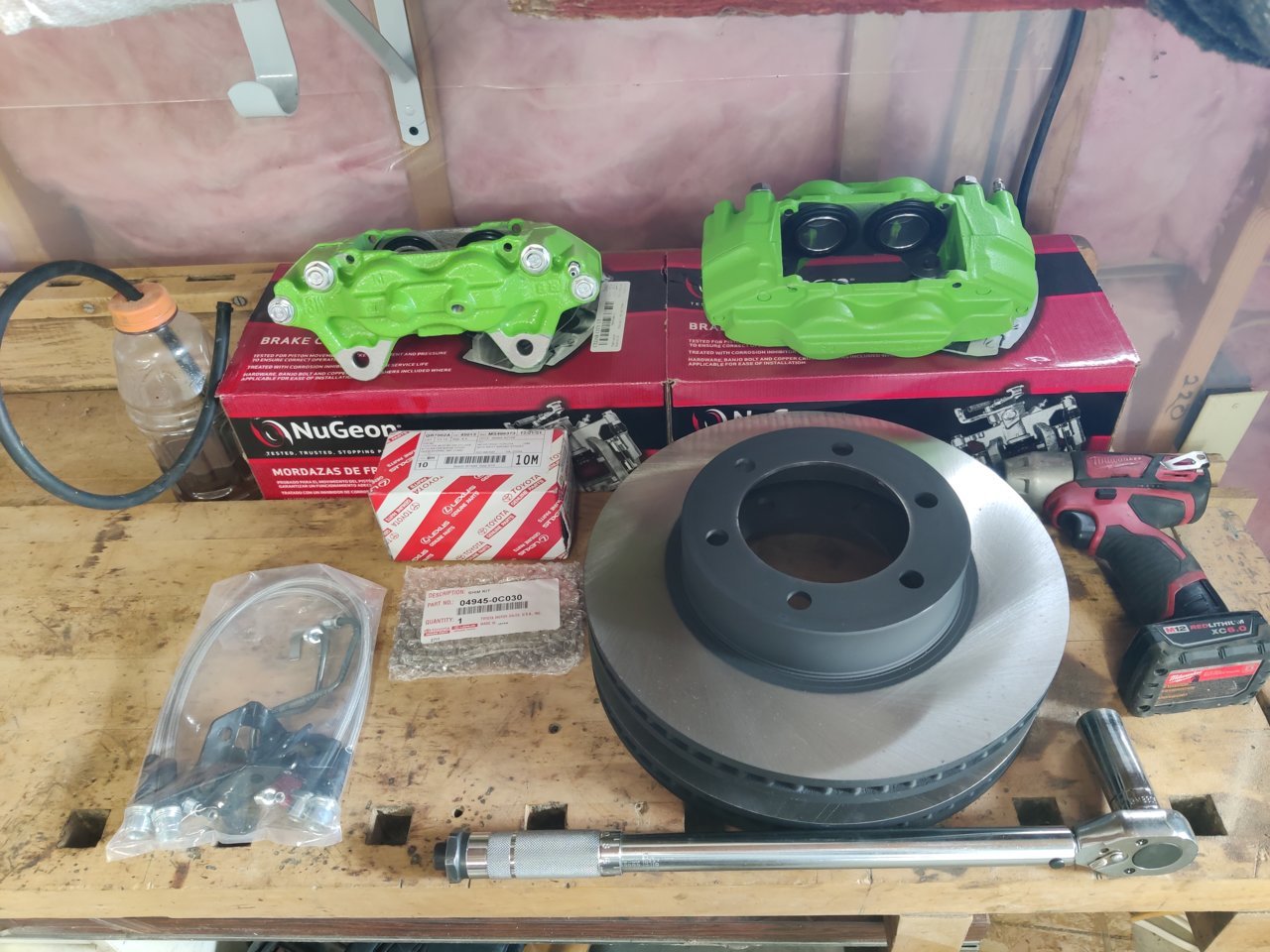

    I just finished piecing together everything I need for the 13WL brake swap so that's my next plan of attack

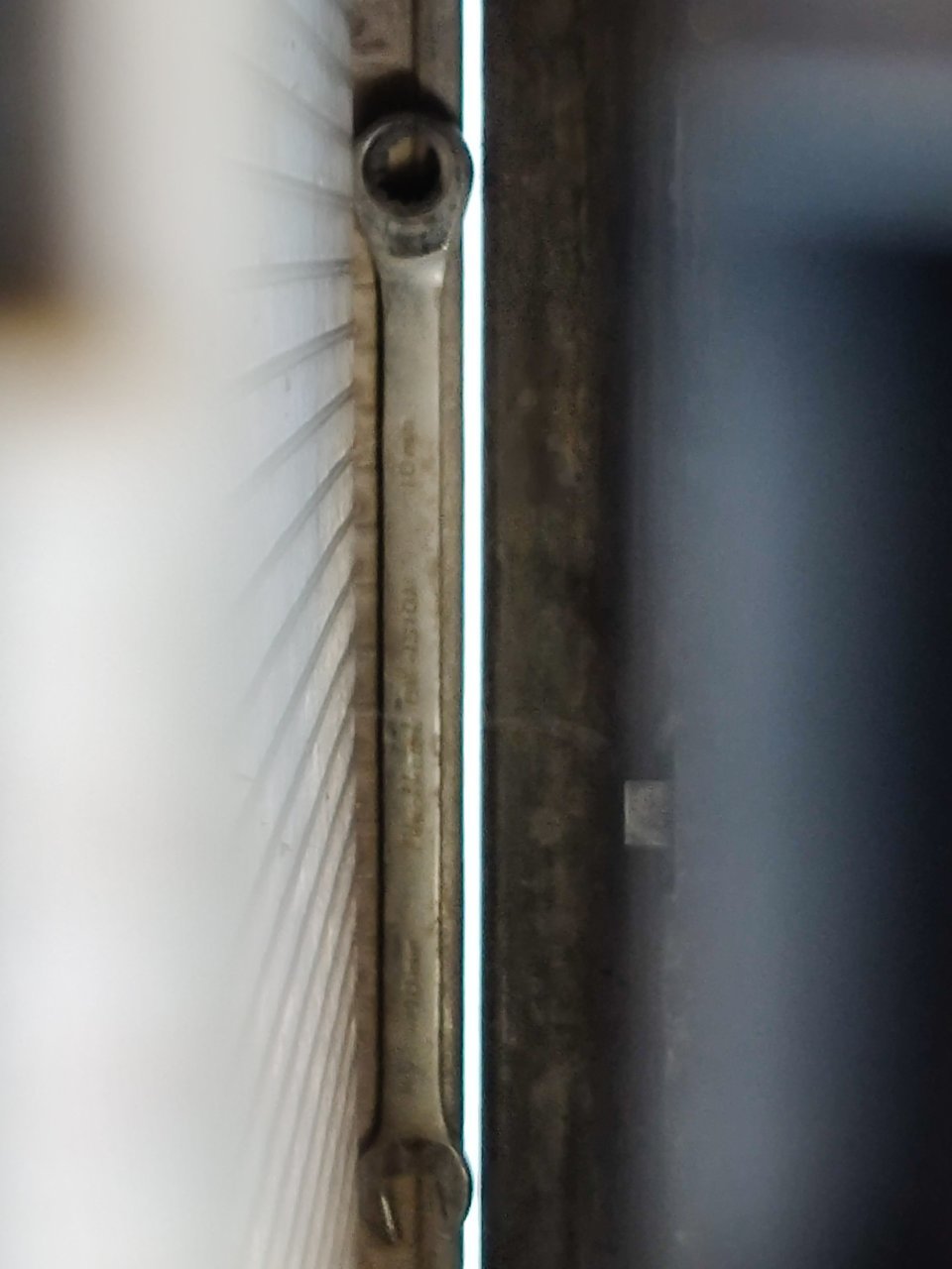

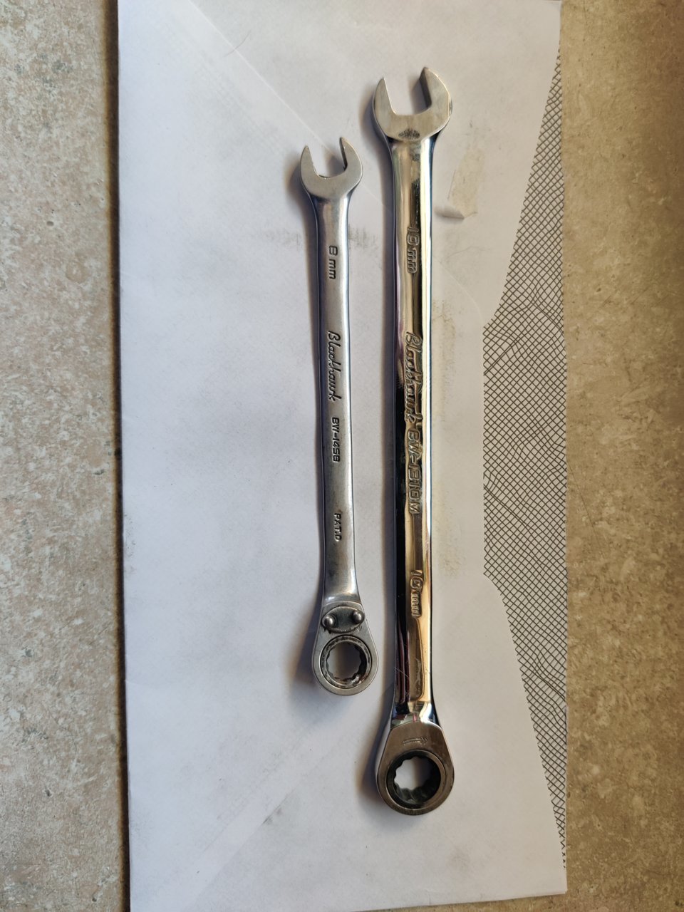

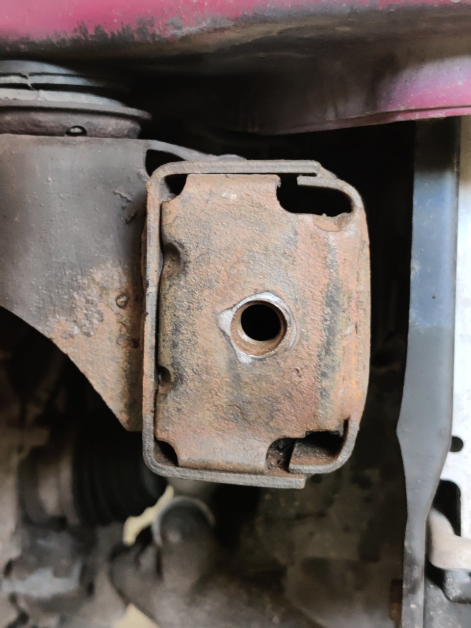

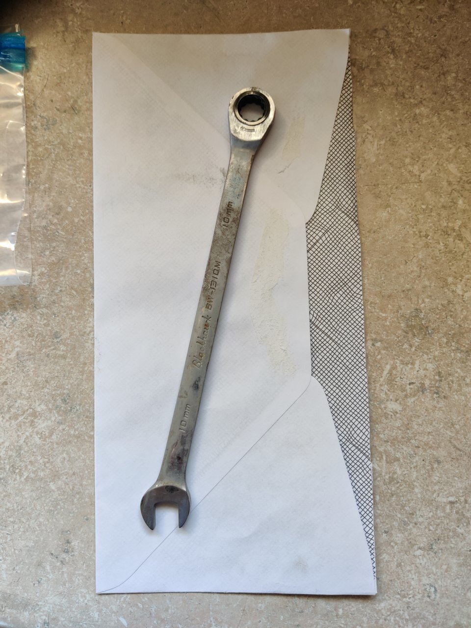

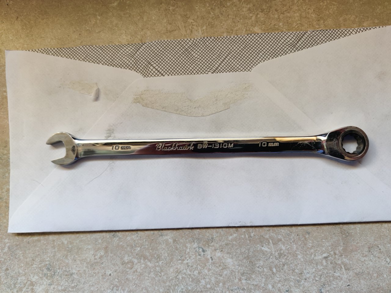

    Sometimes just inspecting under the hood and doing a little cleaning pays off.
    Little game of I spy
    Well hot damn
    Cleaned up nicely, gears are smooth and it matches the 8mm I found on the side of the road in 2010

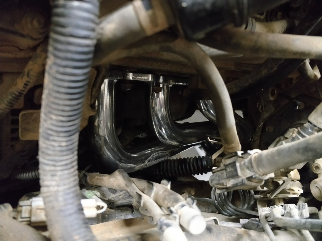

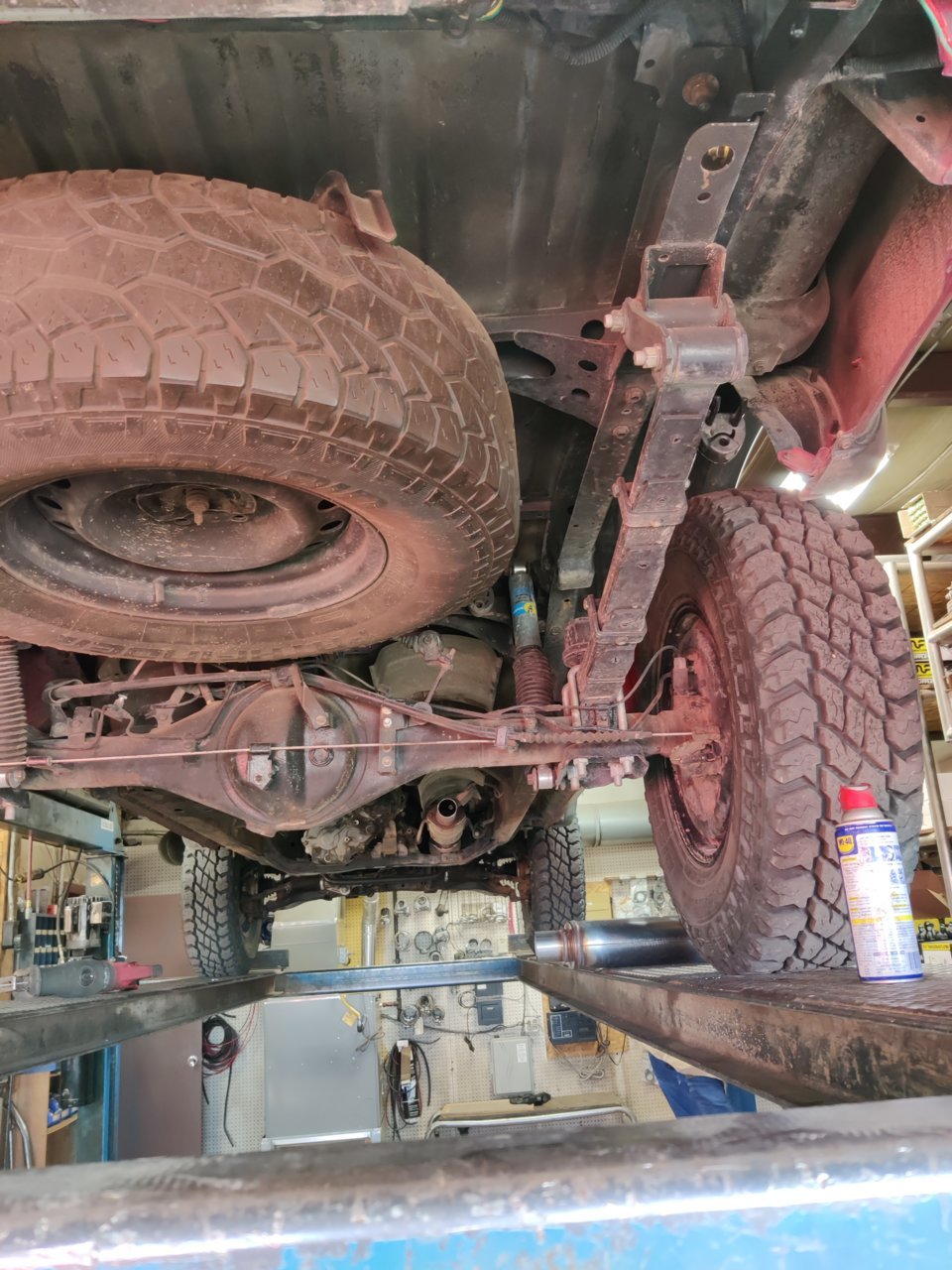

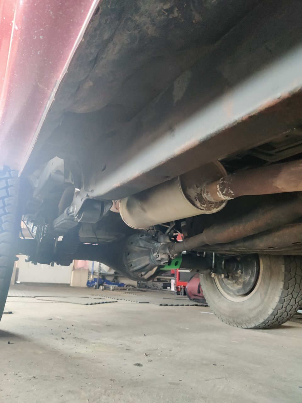

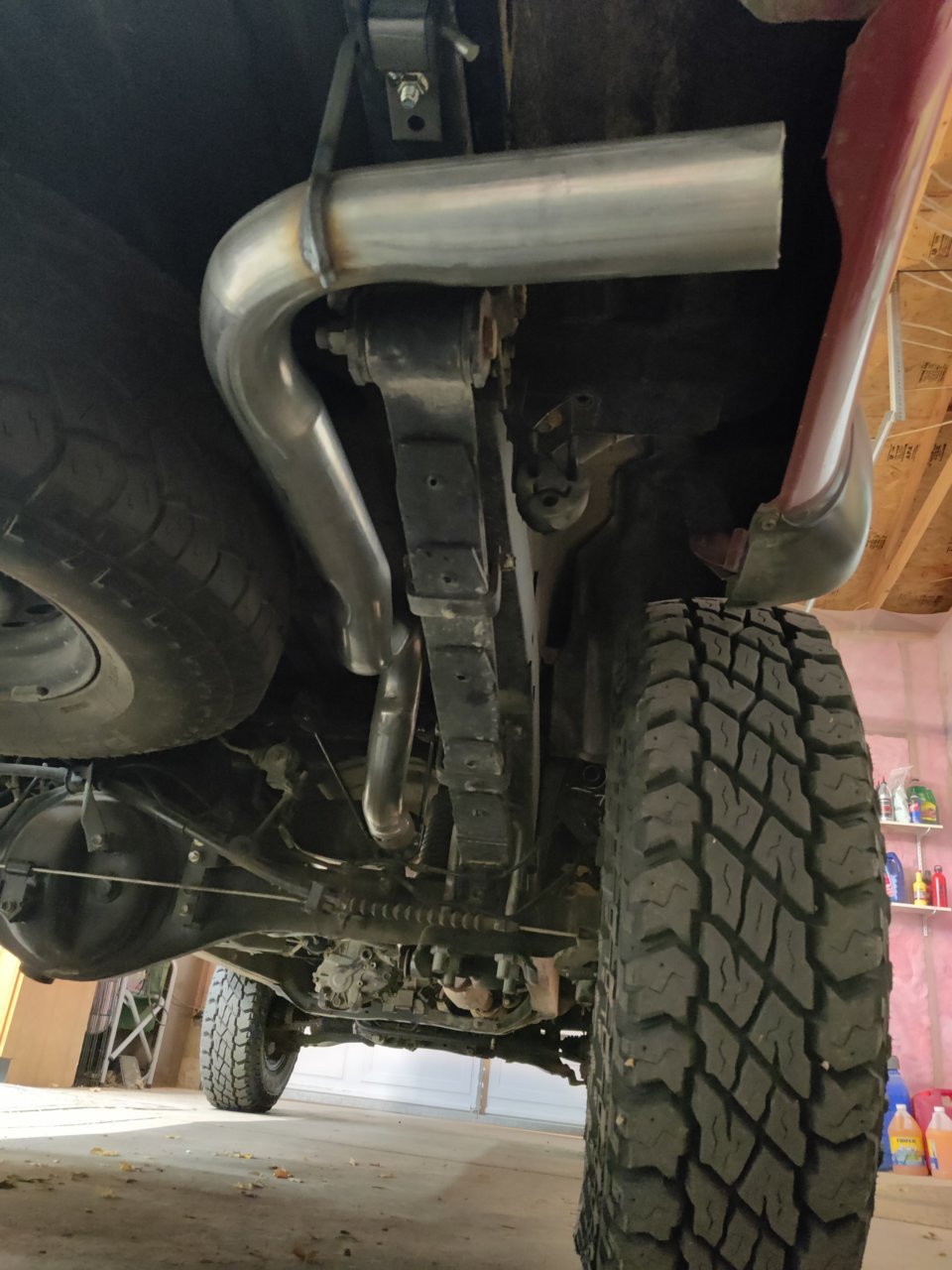

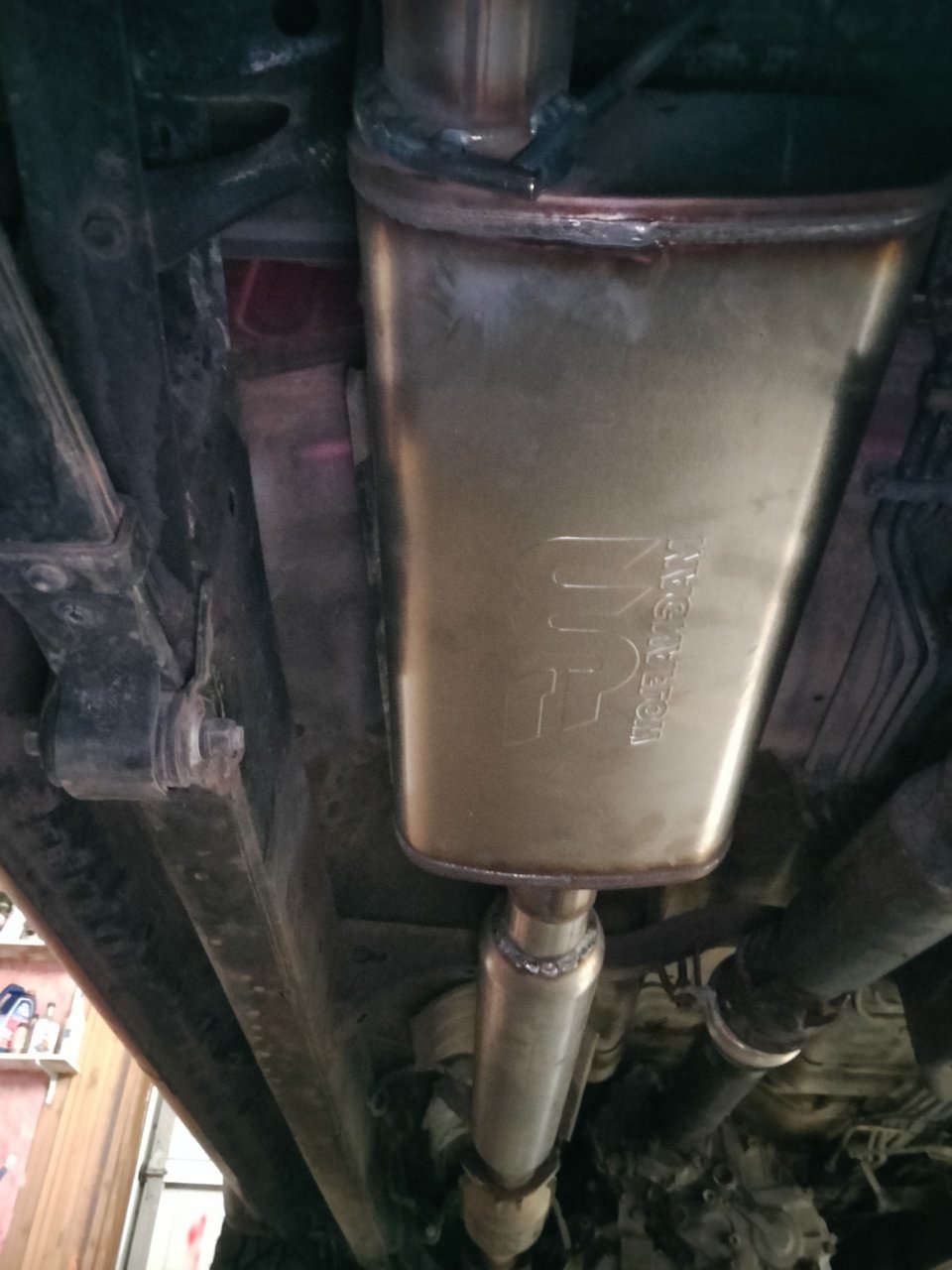

    Yucky stock exhaust, can't have that
    :spending:

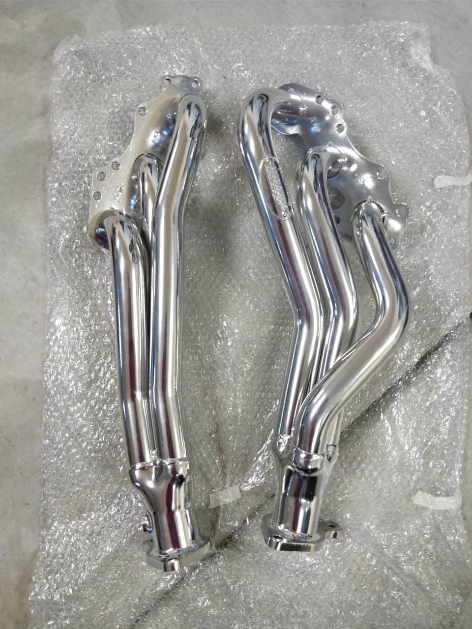

    Stopped by the local exhaust shop that I've worked with over the years and I remembered seeing some Doug Thorley swag and I loved the long tube headers I installed on my 09 but have heard a few issues about fitment on the 3.4's and as it turns out Doug was personal friends with the shop owners. He's actually buried less than a mile away from the shop.
    Ended up ordering a set of Doug headers and will have them installed at the shop when they get here.
    But since I was already there

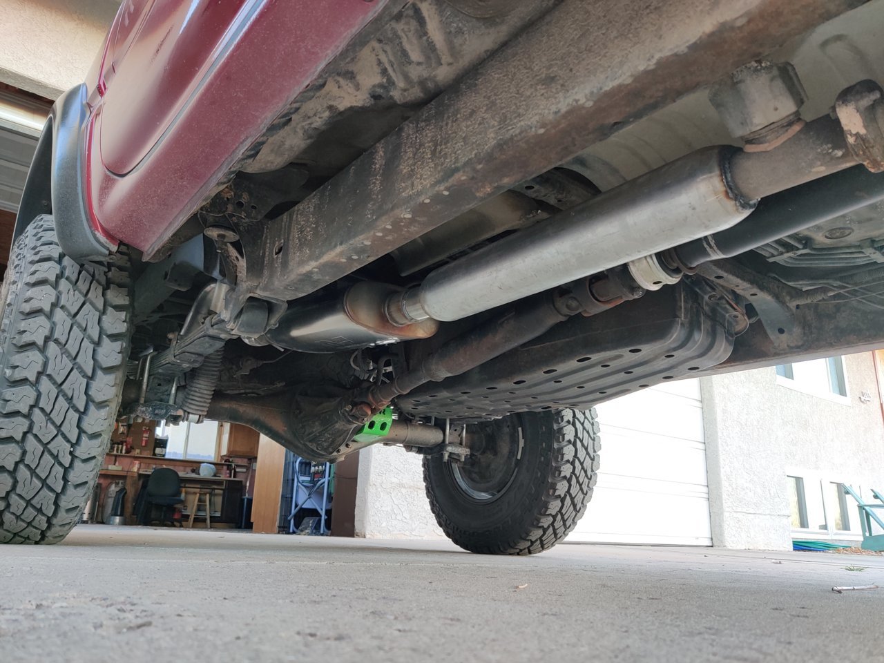

    IMG_20211117_151840.jpgWe worked up a custom MagnaFlow catback with a resonator
    I installed MagnaFlow bolt on cat backs on both of my 2nd Gens but this is the first time I've had a resonator and I am extremely happy with the tone quality and can't wait to see what the headers add to it.

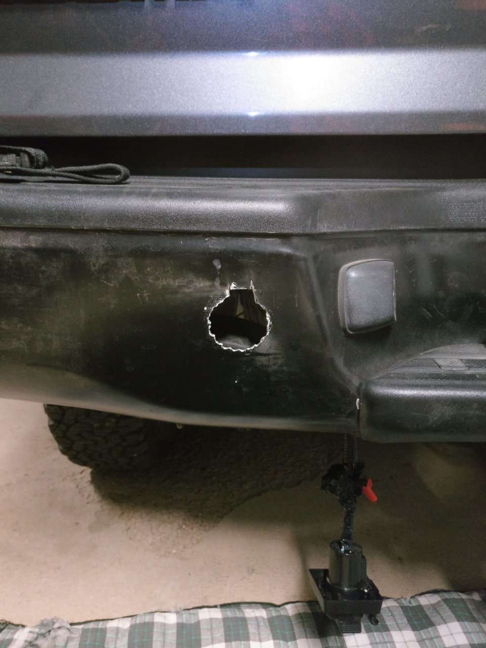

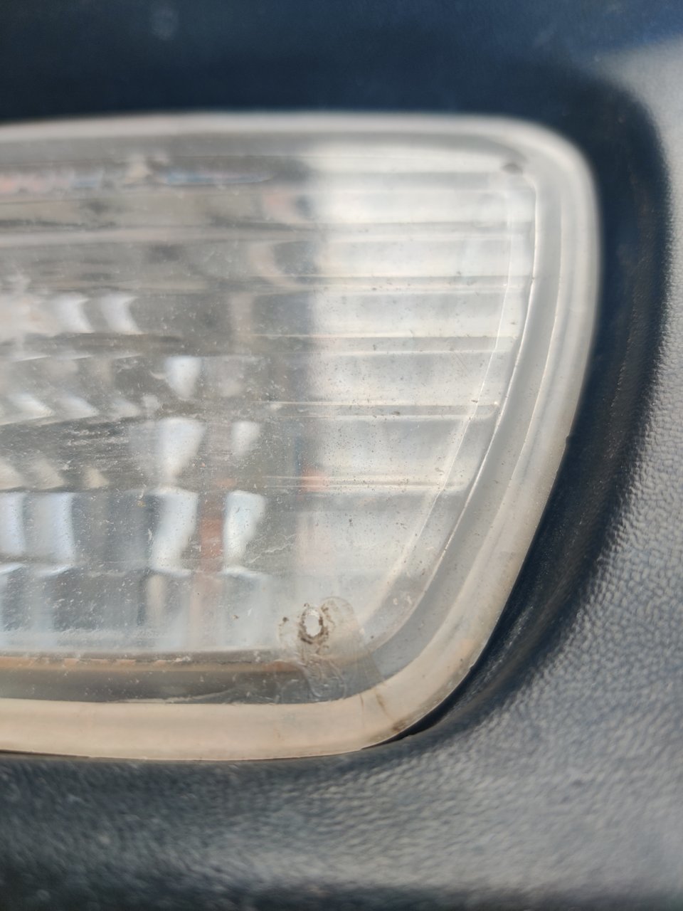

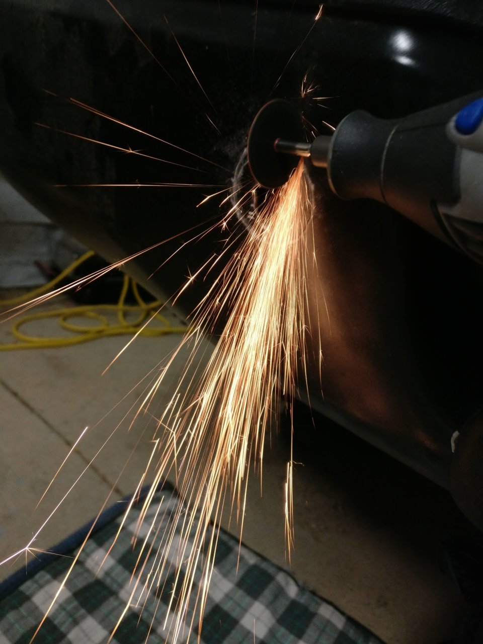

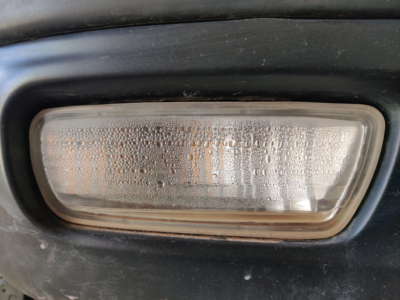

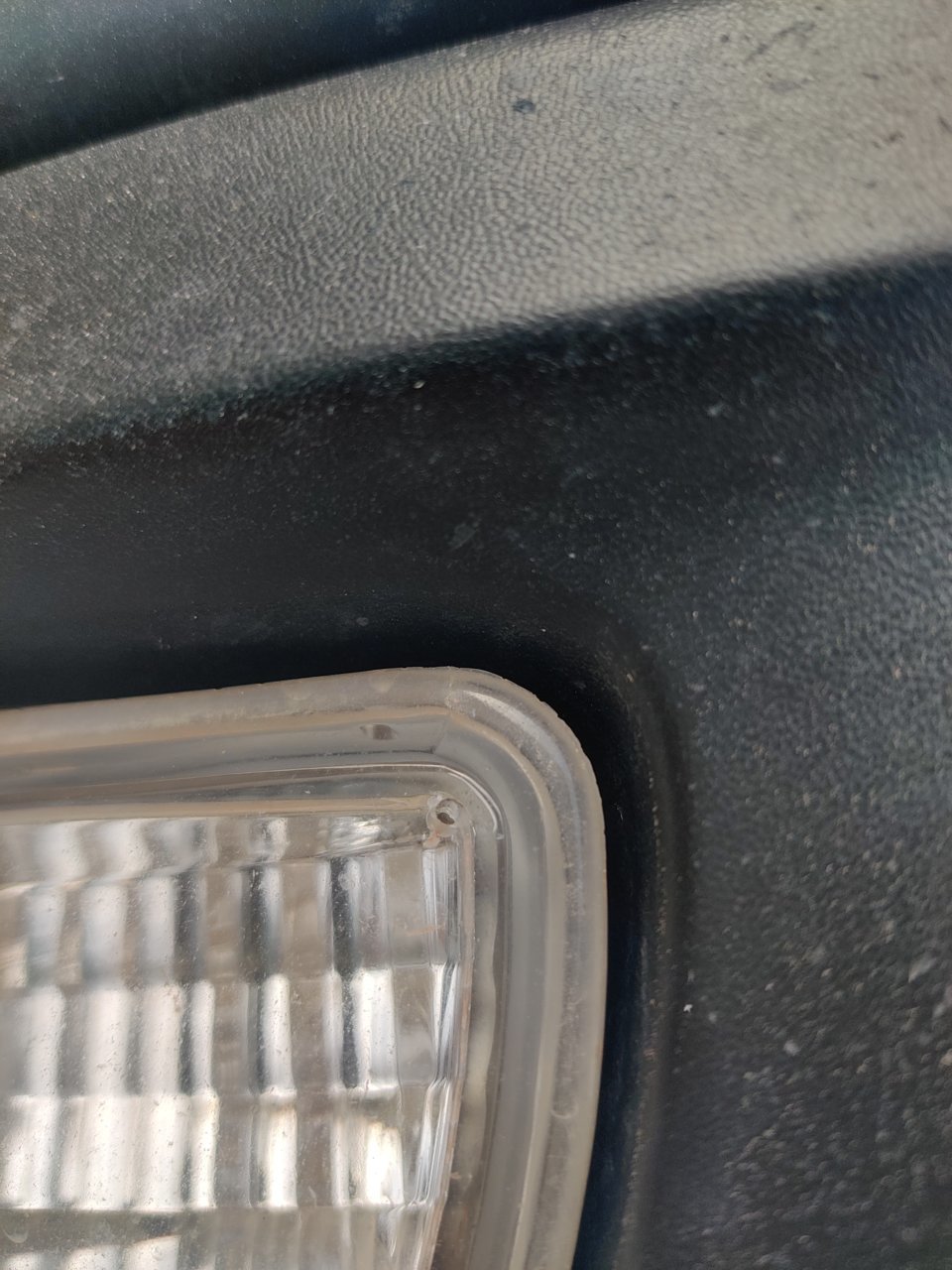

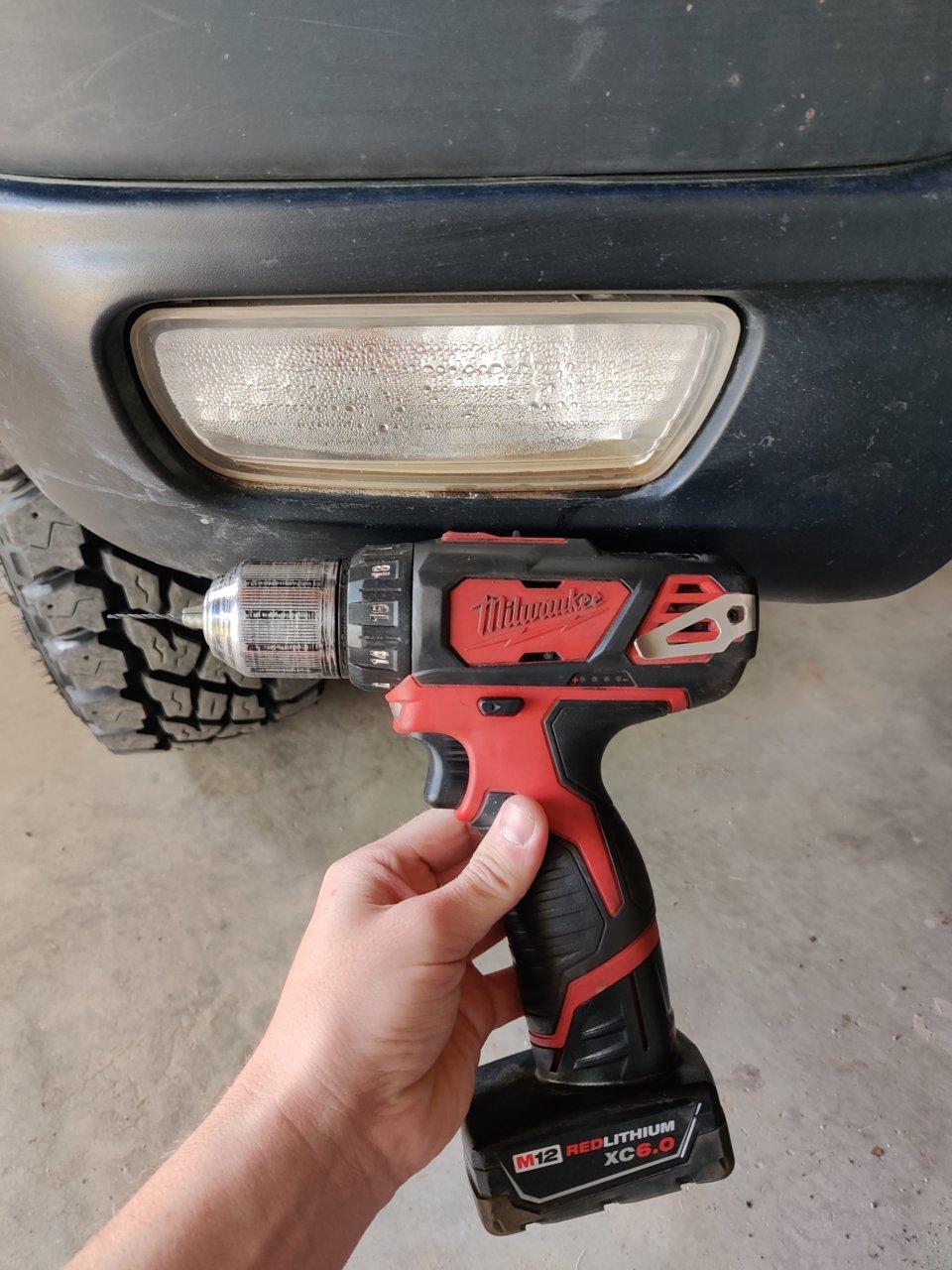

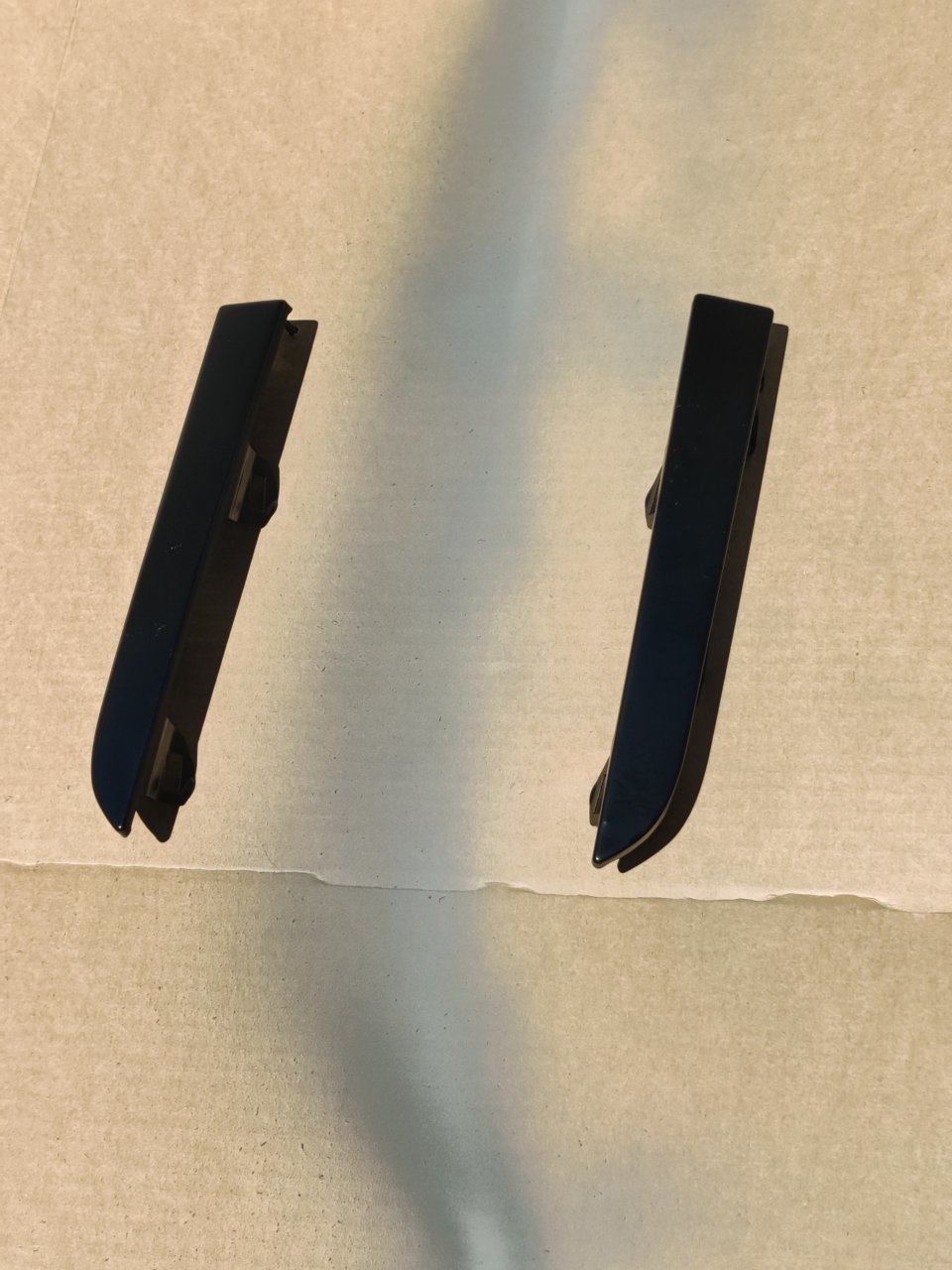

    I don't like it when water gets into the lights
    Bust out the drill and a small drill bit. Slowly drill out the very lowest spot you can and let it drain.
    I also drilled a second hole in the top of the light to allow air to get in easier and the water drains faster.
    I did this same thing with my 1st Tacoma blinker light and a few Honda taillights
    Some say it makes your lights burn out faster but I've never felt like it gave me issues and bulbs are easily replaced for the most part.
    It wouldn't be difficult to seal off with a plug or even just a small piece of clear tape

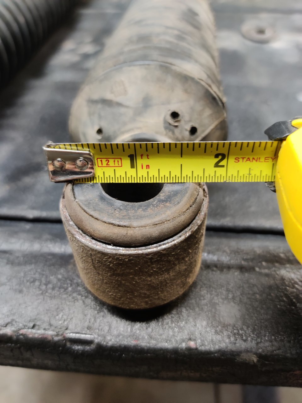

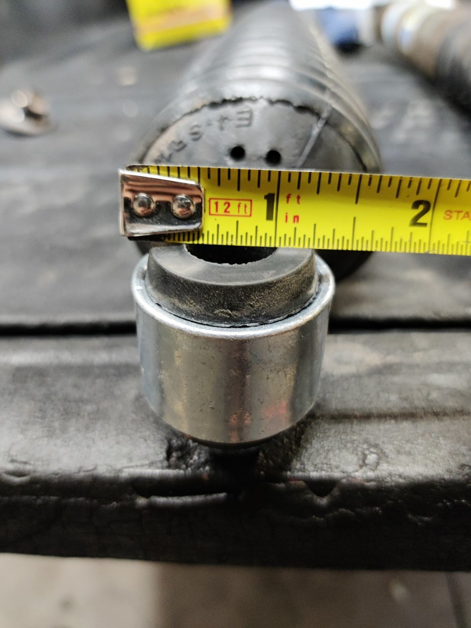

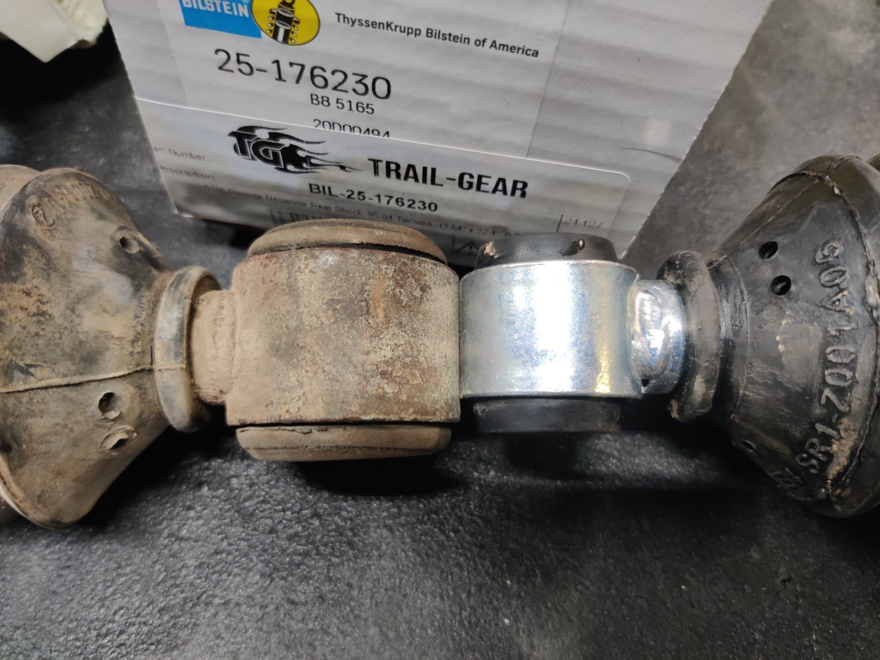

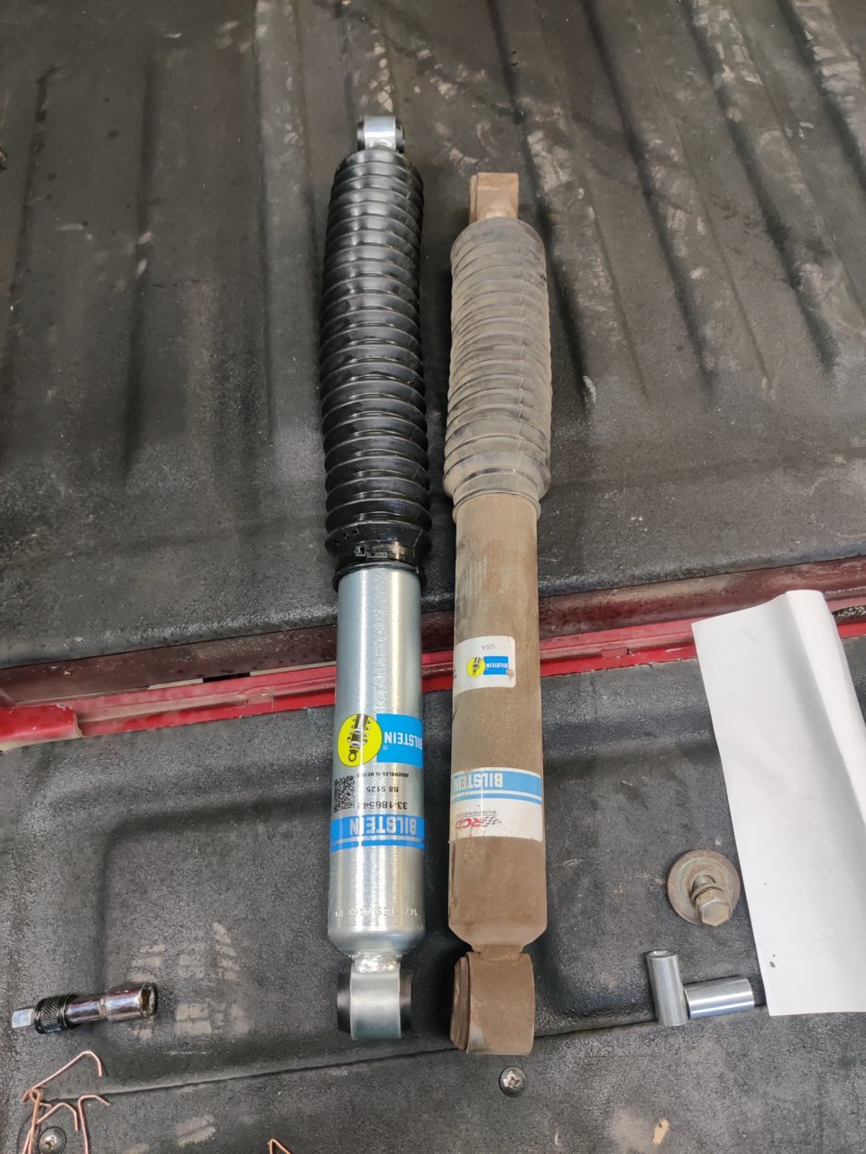

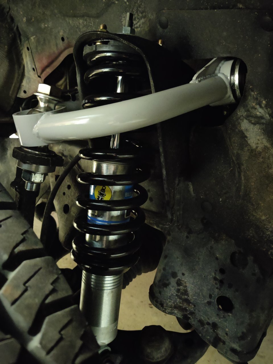

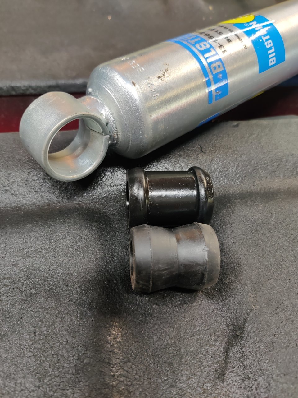

    Here's a couple pictures comparing the Bilstein 5100's I took off and the Bilstein 5125's I put back on... once they gave me the correct bushings.
    It also might be worth noting that a set of 5165's I ordered around the same time came with the smaller size eyelets and incorrect bushings.
    One set came from Low Range Off-road and the other set came from Wheelers. I contacted both business and got completely different results.
    Low Range gave me a part number for the correct bushings and told me to order them.
    Wheelers next day aired me a set of the correct bushings free of charge and apologize for the inconvenience.

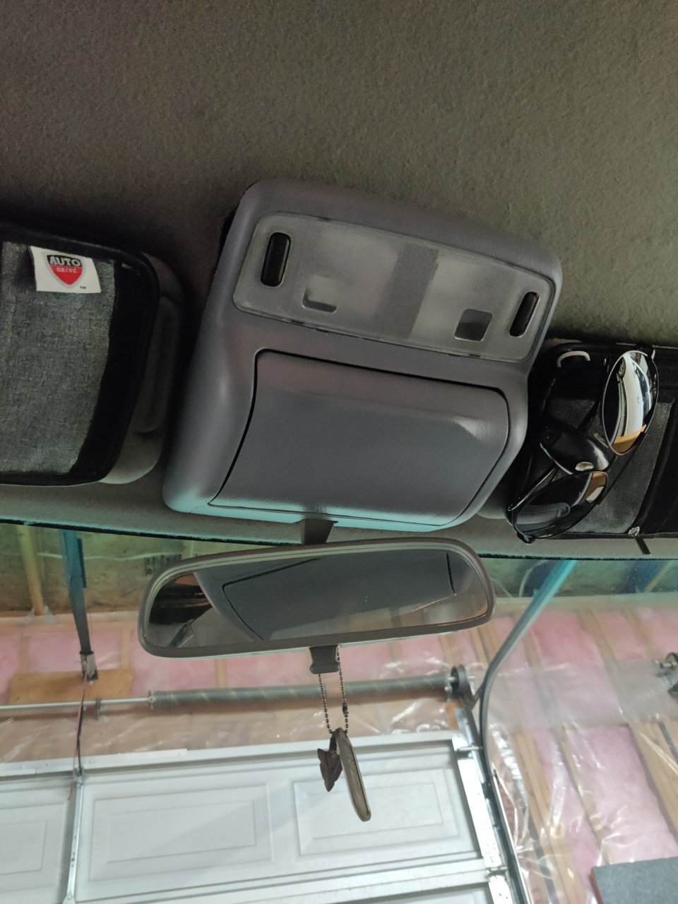

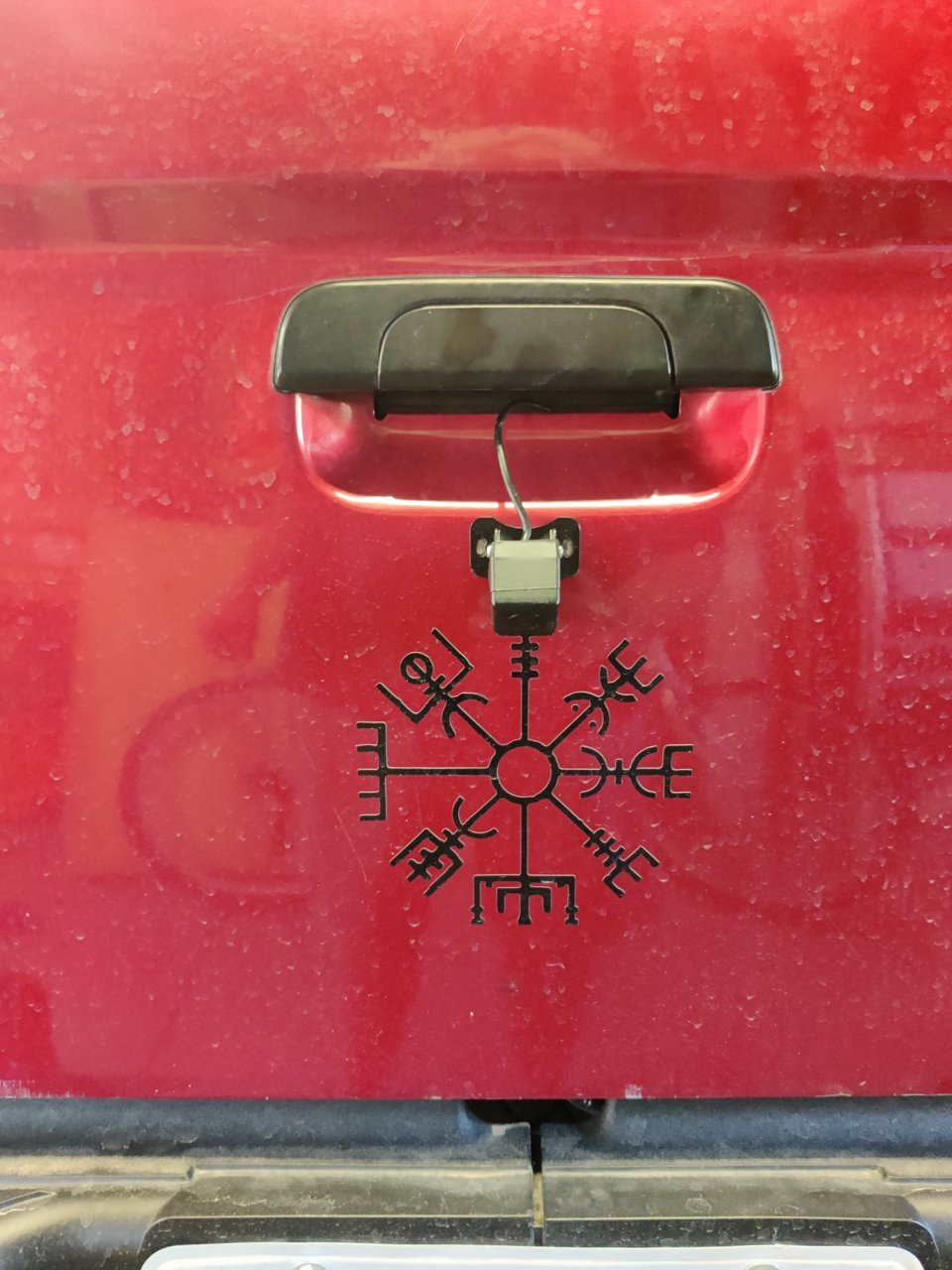

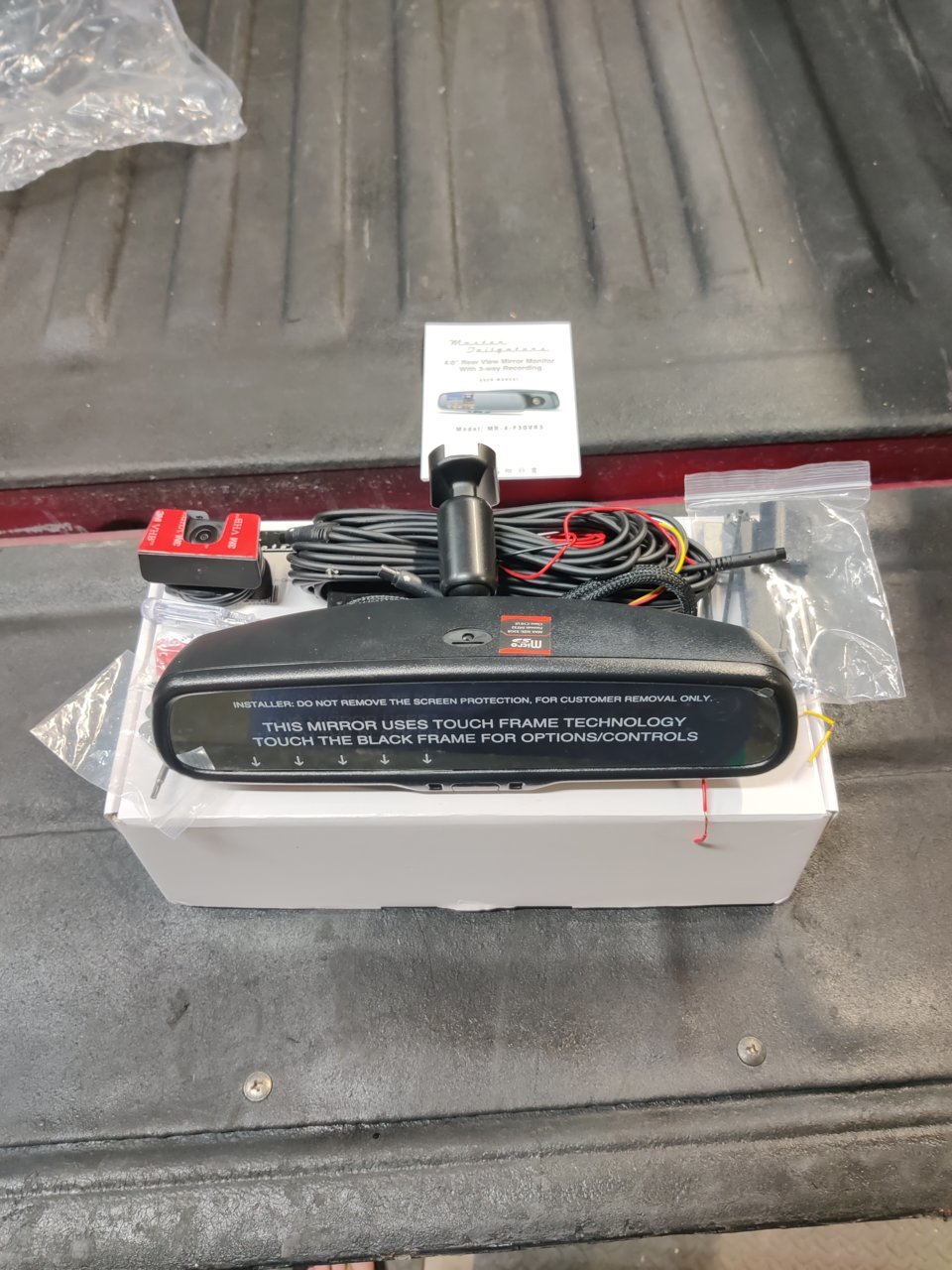

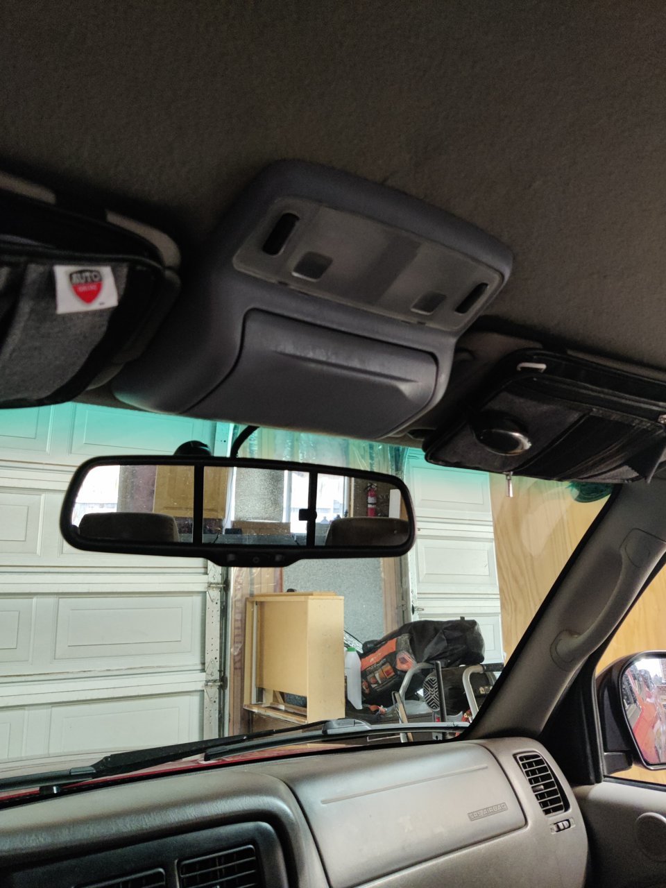

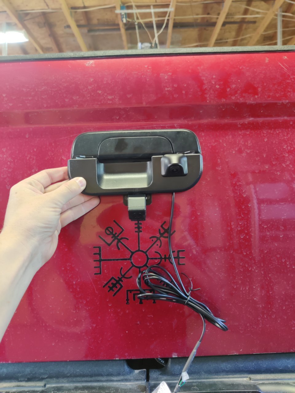

    Having a backup camera in the 2nd Gens was nice and I wanted to have that back
    :spending:
    Master Tailgaters 4" LCD Rear View Mirror.
    This was done before I installed the the Anzo tail lights and the same shop that told me the tail lights wouldn't work did the installation for me.
    Paying someone else to crawl under the truck was a birthday gift to myself and I was hoping to have the tail lights and mirror all done that day.
    I also had them install some Memphis audio speakers with tweeters in the front doors that day.
    I ended up having to drive to a different shop to have the mirror glued to the windshield. The kit didn't come with glue and the audio shop didn't have any on hand but the automotive glass shop just down the road glued it up for free
    :hattip:
    Before
    After
    I don't love this mirror, in fact I told my wife I wanted to fill the box it came in with dog scat and return it
    They are obviously not made in the US and whoever translated the programming must not speak English.
    There are lots of things it's supposed to do but I can't even get it to turn off and on correctly let alone read a memory chip.
    Of course the car wash ripped the camera in two the first time I went through but surprisingly its still functional (when the mirror is working) a little electrical tape is holding in together now.
    I did try and order a fancy US made handle cameras but the mirror doesn't receive any signal from it at all.
    I think there is supposed to be a way to adjust the frequency or something in the mirror settings but it's not very user friendly I'm not sure if the setting needs to be "Left or Up"
    Or maybe it's the "Small/Medium/Good" option I'm getting confused on.

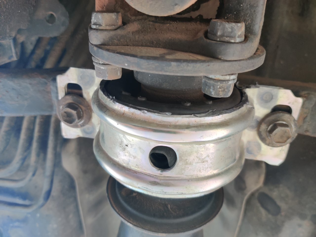

    Ever wonder what would happen if you went wheeling with a carrier bearing that's installed upside down and backwards?
    Not much really.
    It's still backwards but I did spin it so it's half right
    :anonymous:
    It still vibrates less than the old one did

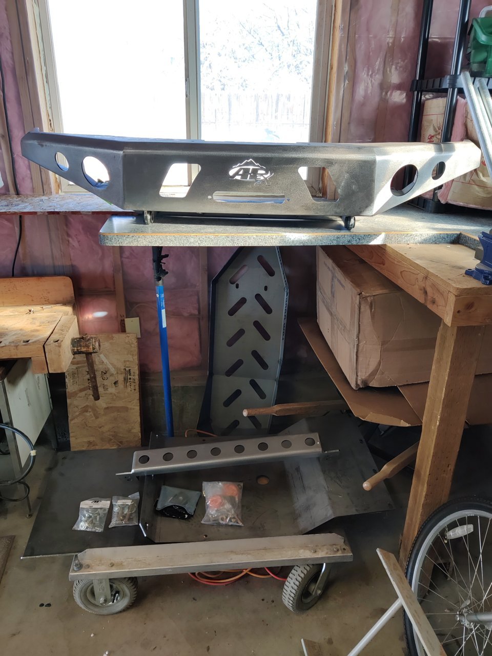

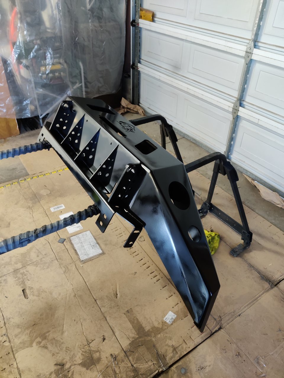

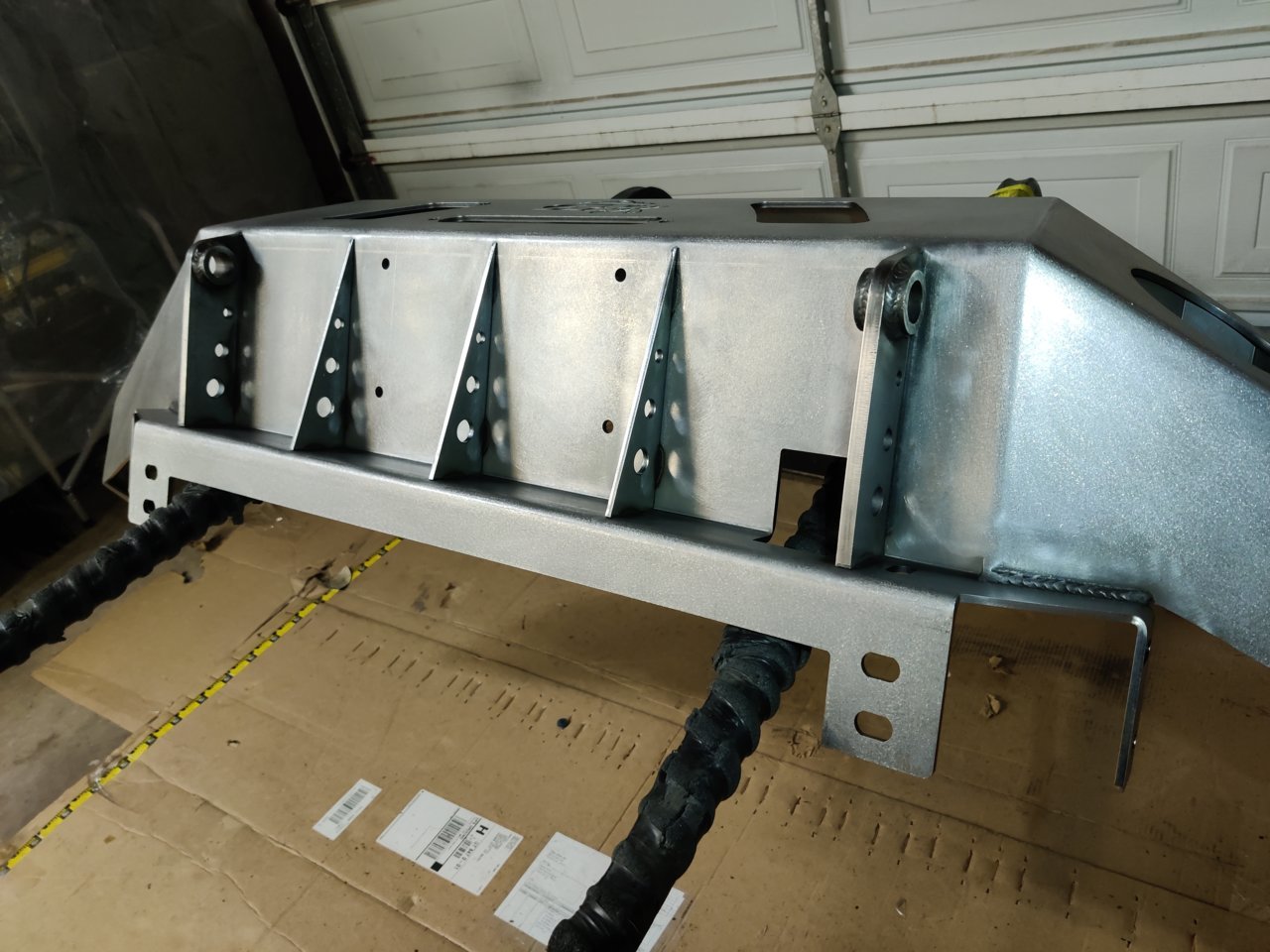

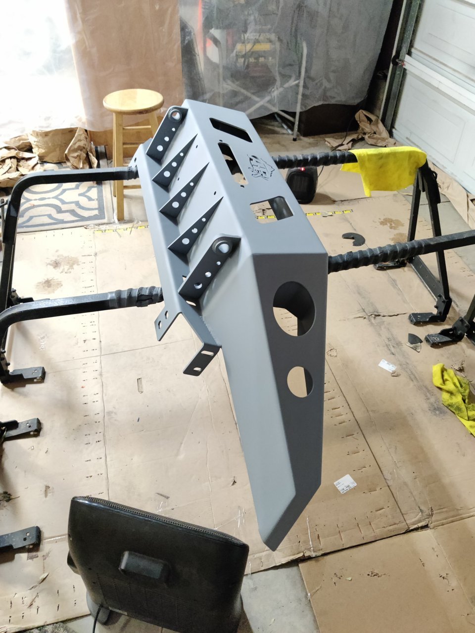

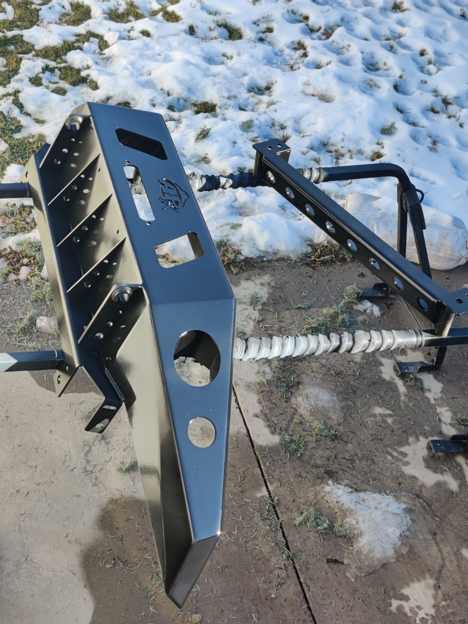

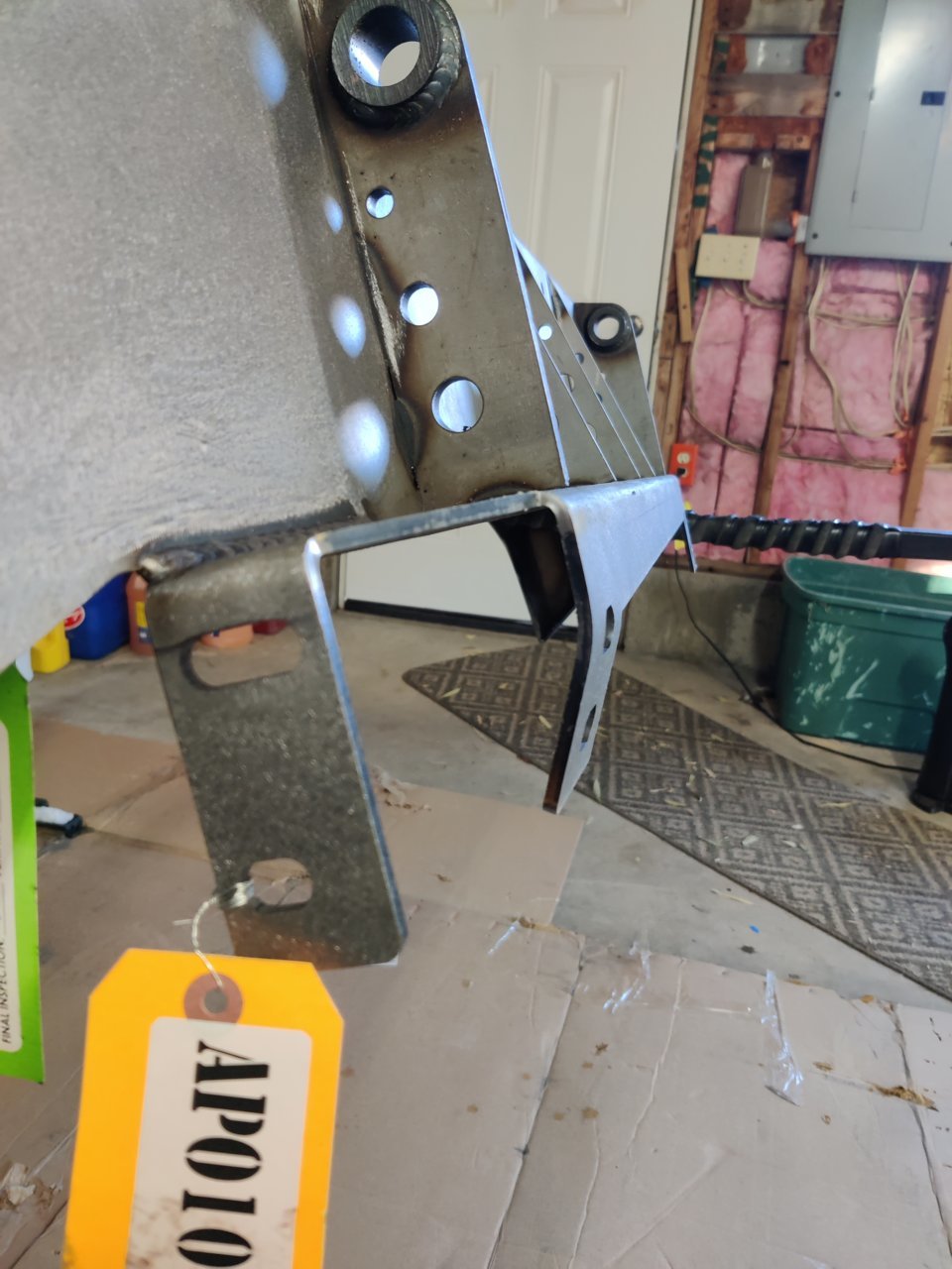

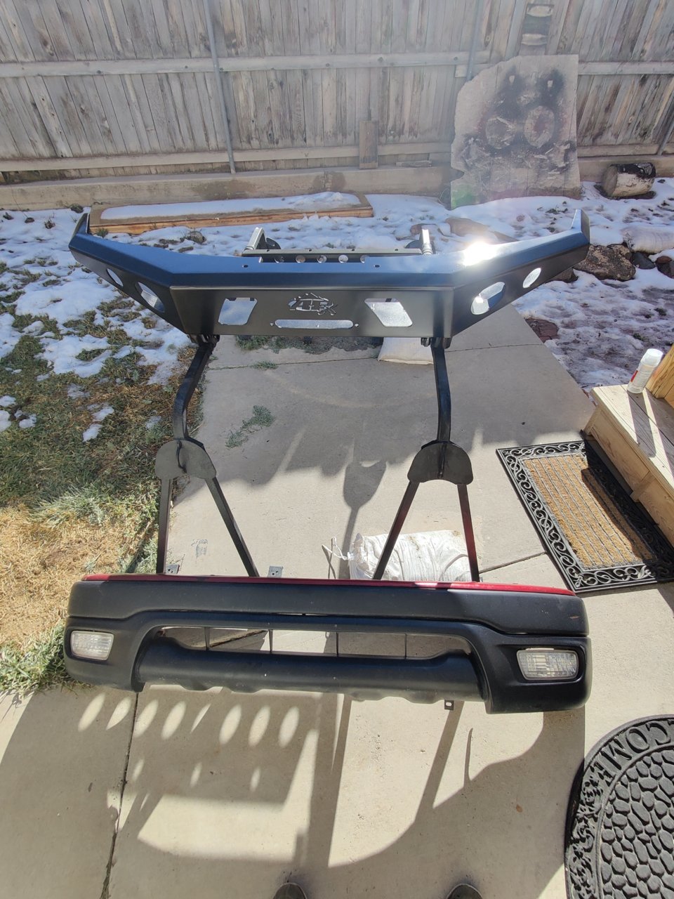

    A plate bumper is something I've wanted for a long time so I took advantage of some Black Friday deals
    :spending:
    All-Pro Apex bumper with IFS, and T case skids and the gas tank cover from Low Range
    It took me a while to get the bumper painted but I finally did.
    I notice a mounting bracket was bent during shipment
    a quick smack with a dead blow took care of no big deal
    Cleaned with rubbing alcohol
    Primer
    Gloss black acrylic enamel.
    I will say it was difficult to get a good even coat on the bumper without over spray everywhere. There are soo many different angles it just made it complicated. I kicked myself a few times for not shelling out the extra cheddar to get the bumper powder coated but I it turned out alright eventually

  12. Jan 15, 2022 at 8:44 PM
    #52
    unstpible
    unstpible [OP] Well-Known Member
    Aug 16, 2012
    #84909
    3,877
    Derek
    Cedar City, Utah

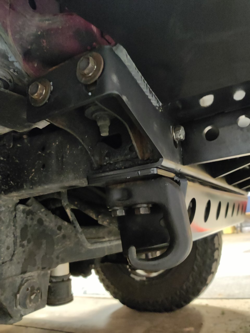

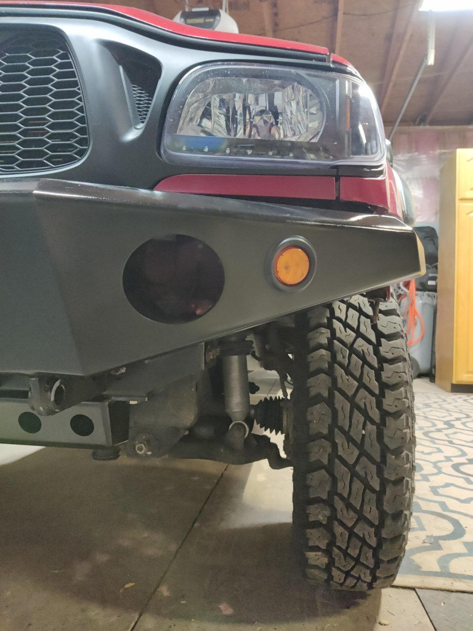

    03 4x4 boosted V6 Auto 341k miles
    CX Racing Turbo kit. TransGo shift kit. All Pro Apex bumper and skids. Smittybilt XRC 9.5 winch. All Pro Upper control arm's. Bilstein 6112's with 600lb coils. Eimkeith's lower control arm reinforcement plates. Perry Parts bump stops. All Pro spindle gussets and alignment cam tabs. All Pro standard 3" leaf springs. Bilstein 5125's rear. Extended rear brake lines. Rear diff breather relocation. MagnaFlow catback with resonator. Bluetooth stereo. Memphis 6x9 door speakers. Diode Dynamics SS3 Pro Amber fog lights. Single piece headlights. aftermarket grille. Anzo taillights. LED 3rd brake light. 4runner sunglass holder and dome lights. Master Tailgaters rear view mirror with 3 directional cameras, G shock sensors, and anti theft system. Honda windshield washer nozzles. Stubby antenna. Scan Guage II. 2nd Gen Snowflake wheels powder coated black. Cooper Discoverer ST Maxx 235-75/16 Denso 210-0461 105 amp alternator. Speedytech7's big wire harness upgrade. Aeromotive 340 fuel pump. Haltech Elite 2500. Tacomaworld sticker. Tundra brakes with Adventure Taco's hardline kit
    Little shot on the way to see my pop's for Christmas.
    (first time in over 10 years) :anonymous:

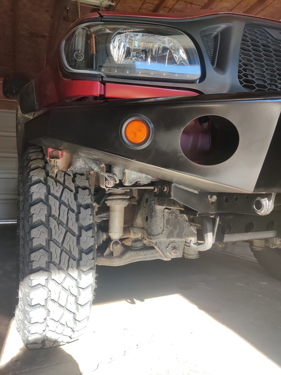

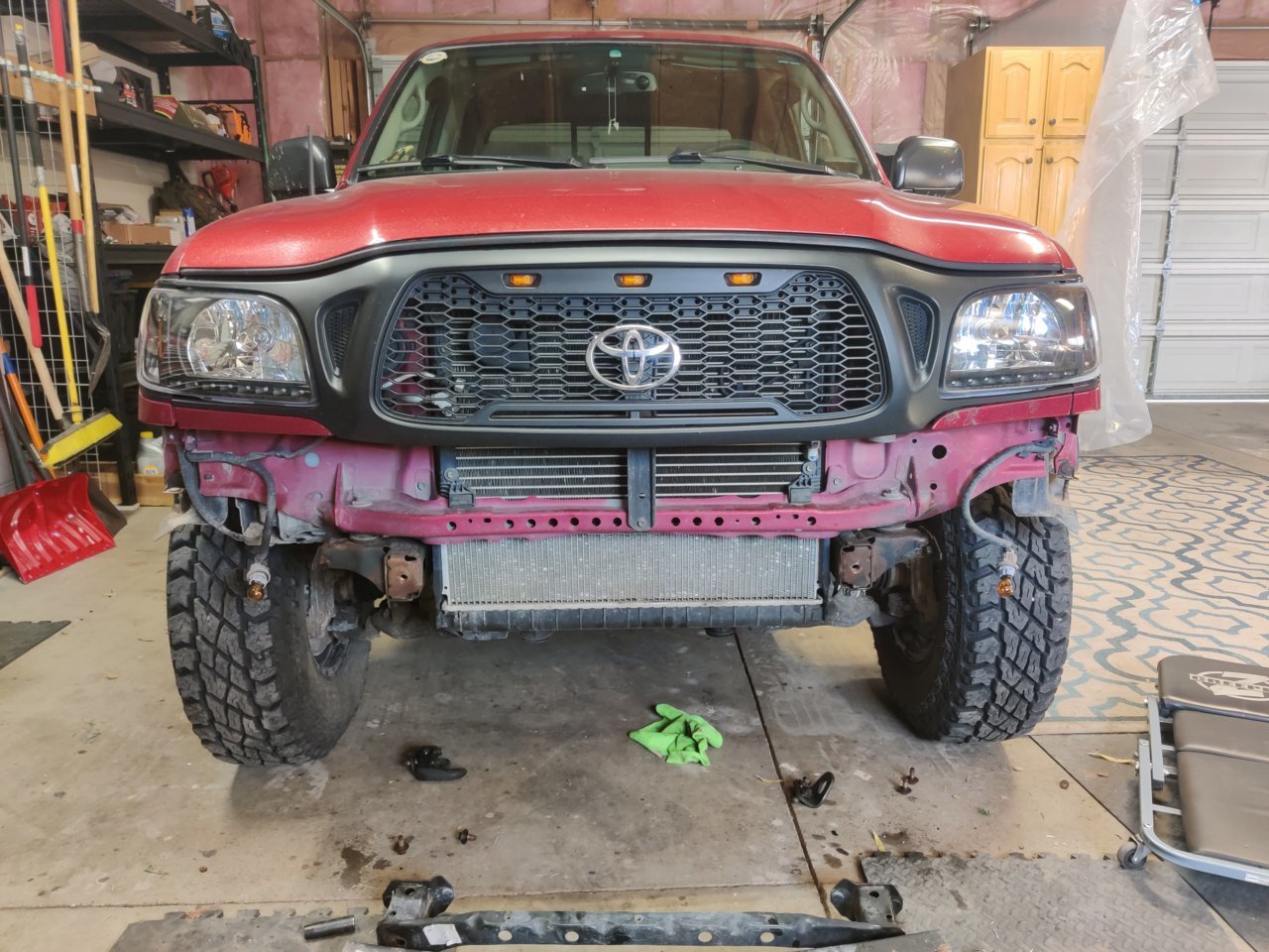

    Now it's bumper time!
    Knowing there was a history of front end damage I was a little worried about what I might find.
    The frame end cap on the passenger side looked like it was bent just a smidge to me and I figured it might give me a little trouble
    And it did. The bolt stripped so I filed the threads some to help it get started and sent her home
    Also how ugly is this grille filler, these things are a pain in the ass on 1st and 2nd gens
    Can't have that
    Chipped the paint a little getting it installed, a second set of hands would have made this a hell of a lot easier.
    I'm a little partial to the hook under the truck so I chose to reinstall that with the original hardware
    Just having something to cover the bottom of the radiator makes me feel more comfortable

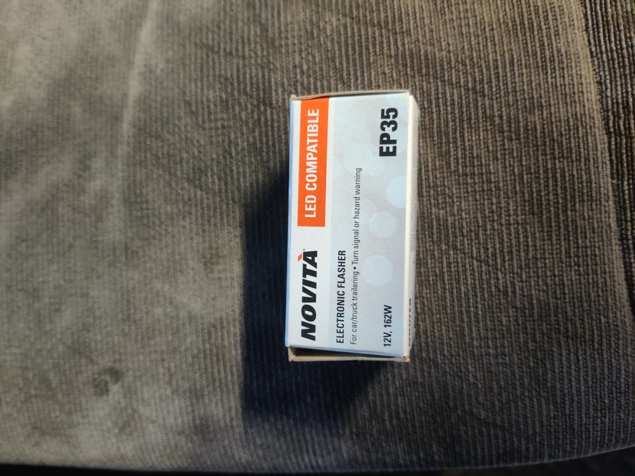

    I had a feeling these 3" led blinkers were going to mess with the flasher relay and they did but that's a simple fix
    EP35 LED Relay for the win.
    Thanks @eon_blue for the quick response and knowing what relay i needed

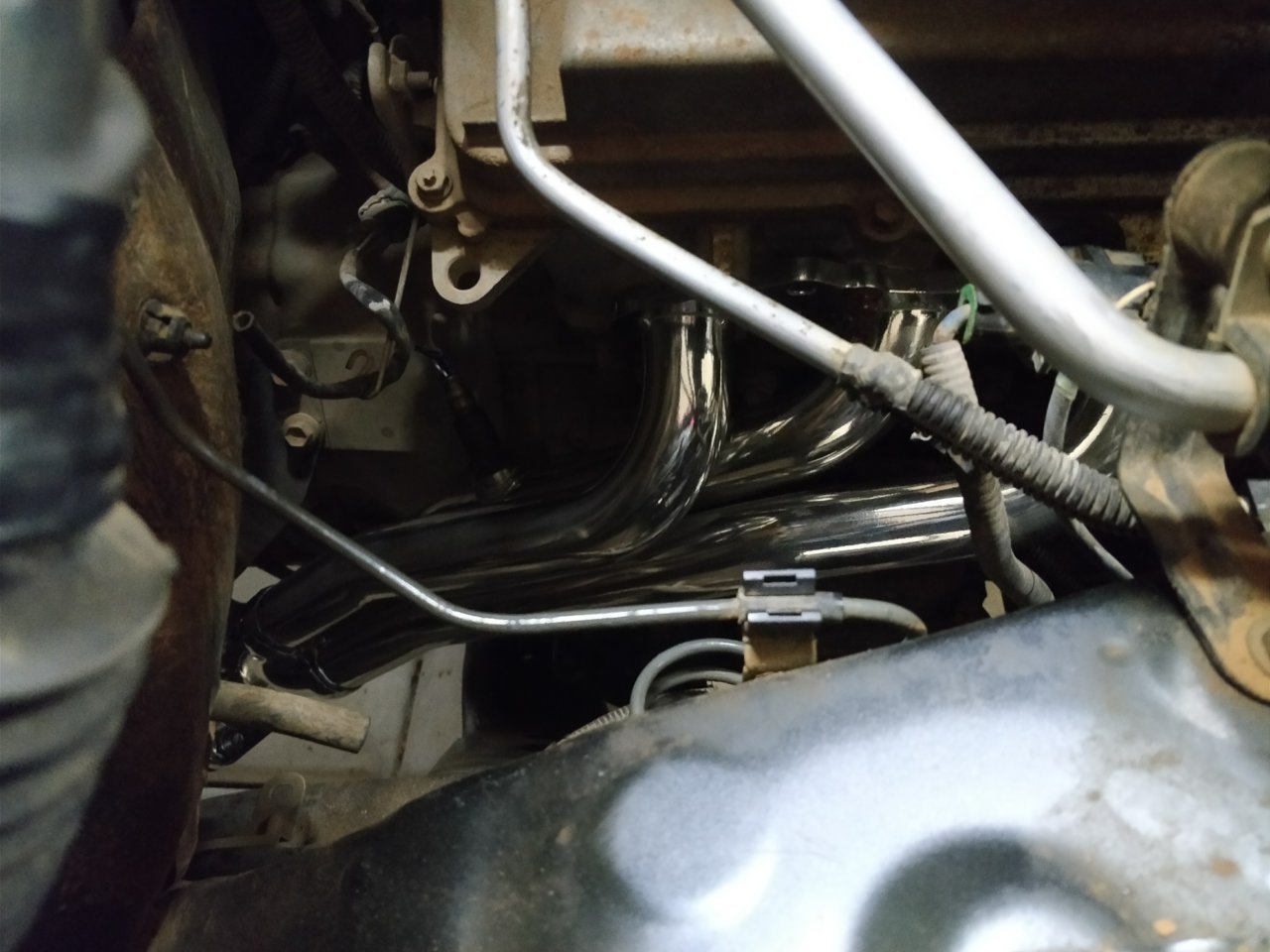

    Here's a little throw back

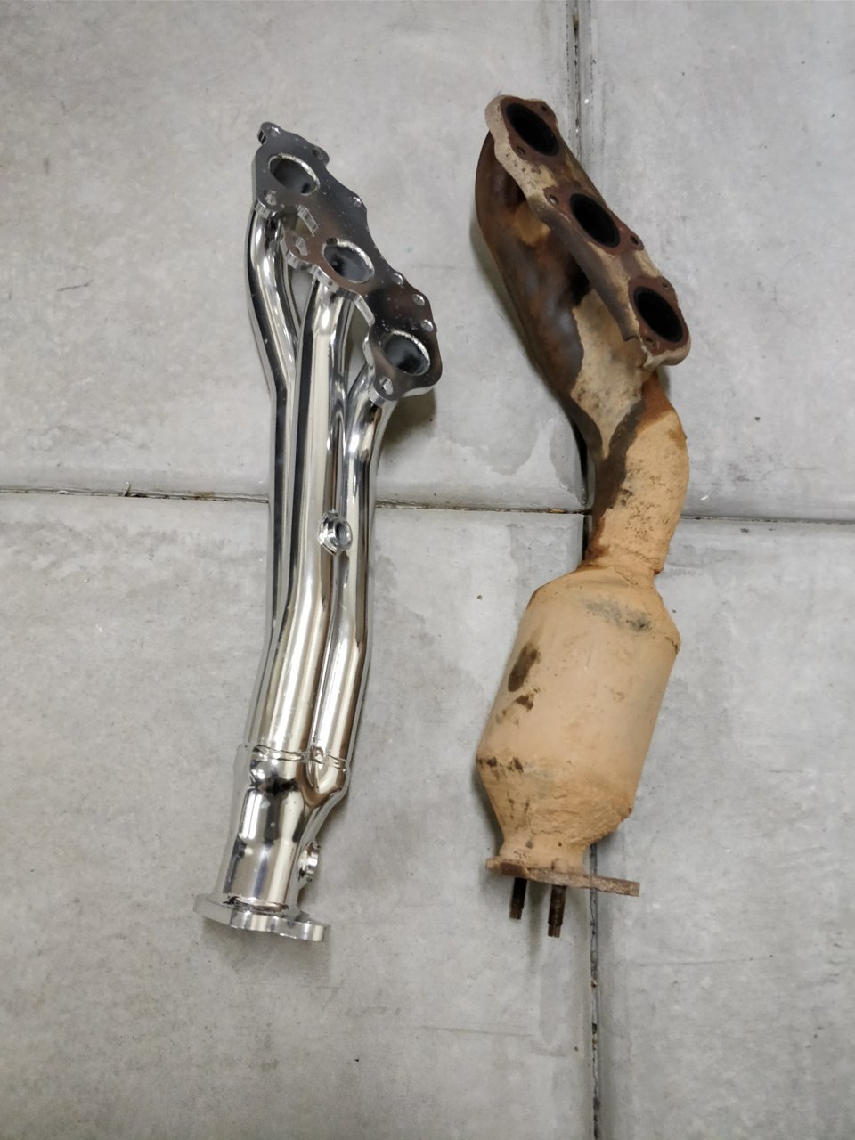

    First time ever installing headers, It only took me 11 hours. I don't think my mom knew what she was doing when she gave me the clicker to her 3rd bay garage door.
    I should also mention I completely forgot the recycle value of cats and threw the manifolds away :anonymous:

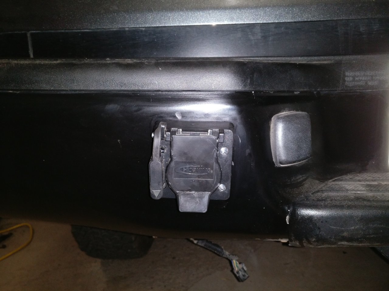

    Here's another mod I did on the 09 that could be replicated on a 1st gen
    I did this after smashing the trailer plug for the second time

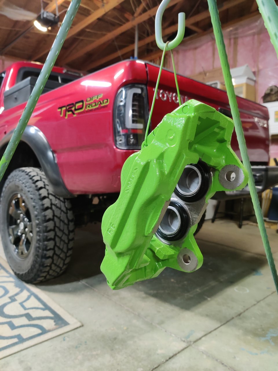

    Back to 1st Gen things.
    Made a little progress on the Tundra brakes today.
