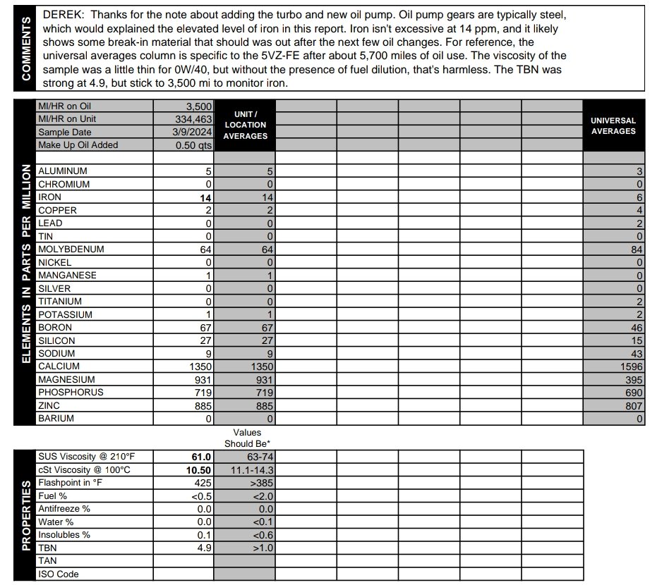

    My first Blackstone oil analysis came back today.
    They said the oil was a little thin and that very well could have been from me topping the oil off with about half a quart or so of 5w30 when it was still leaking plus whatever 5w30 was still left over from when I made the change to 0w40 :notsure:
    Aluminum is up a little, hopefully that was just from cutting and fitting the charge pipes and inner cooler or something that's possible right:notsure:
    Now we just need to drive it another 3,500m and test it again

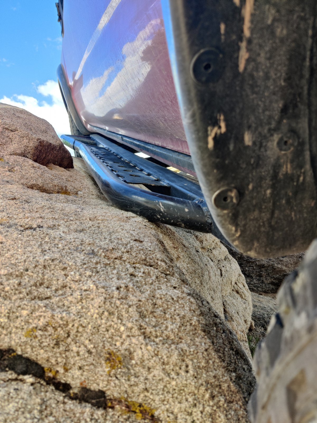

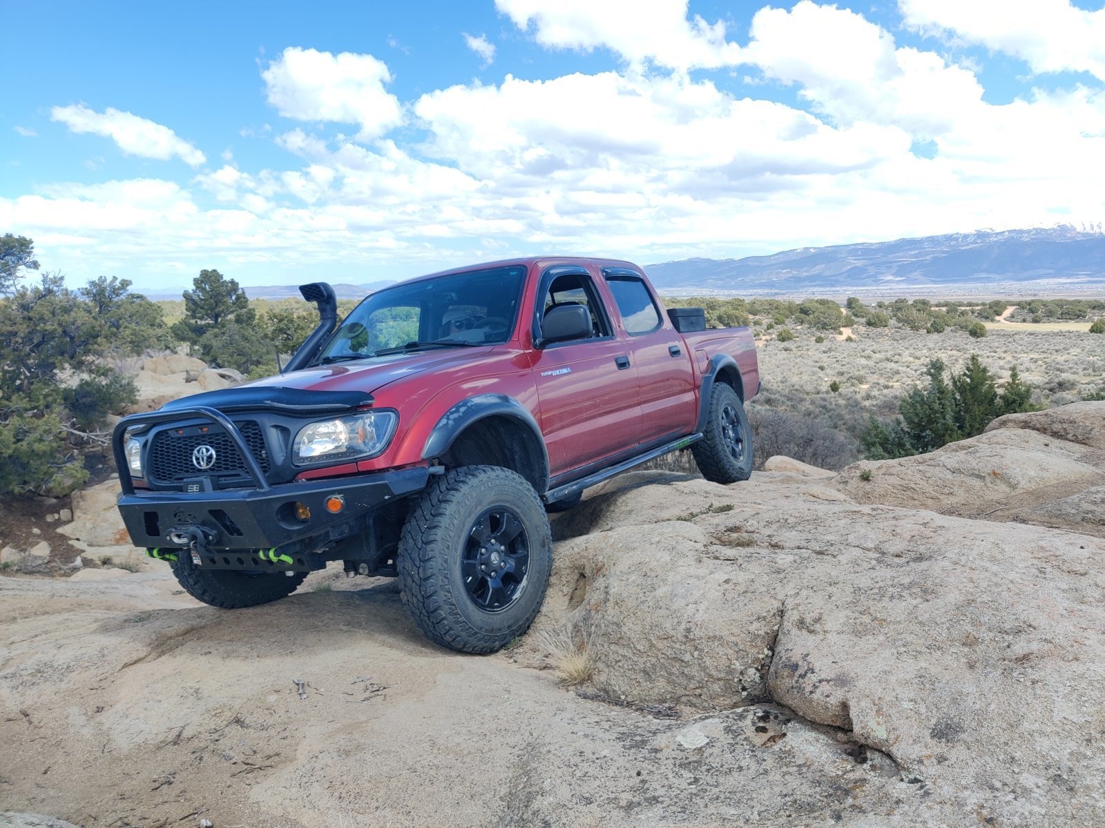

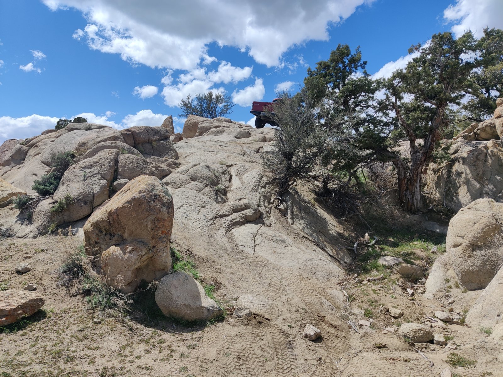

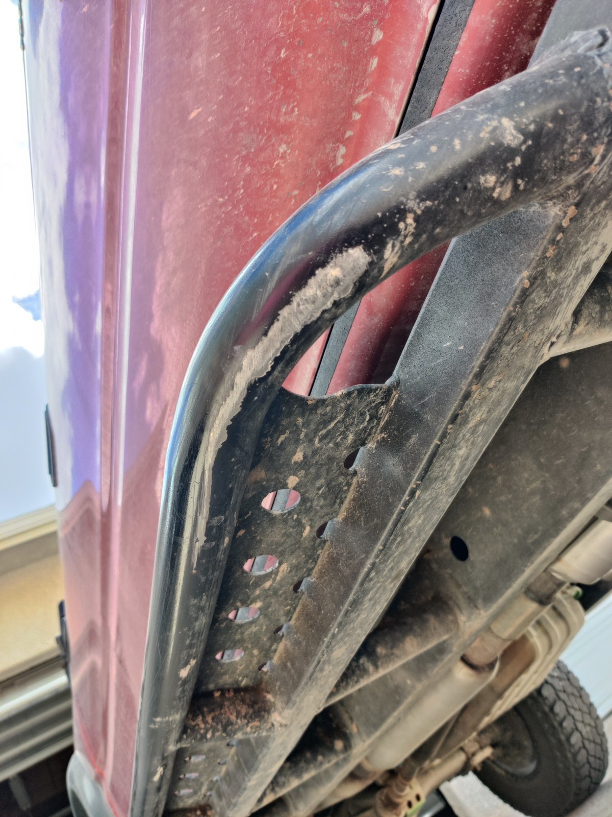

    I haven't posted much in here lately, the truck is still running great and working as my daily driver.
    With W.E. Rock Live coming to town in a couple of weeks I decided to get a Jumpstart on the excitement by playing around in the slick rocks without the crowds and hot dog ventors.
    It got a little tippy and reminded me that I want a roll cage at some point but that'll wait for now
    Oh and I have officially broken in the rock sliders (well at least the passenger side).
    With out the sliders I probably wouldn't have hit that spot anyway but I had to take a moment and capture the sliders first kiss.
    Intake temperatures stayed in the low 70's and the motor stayed below 185°f :thumbsup:

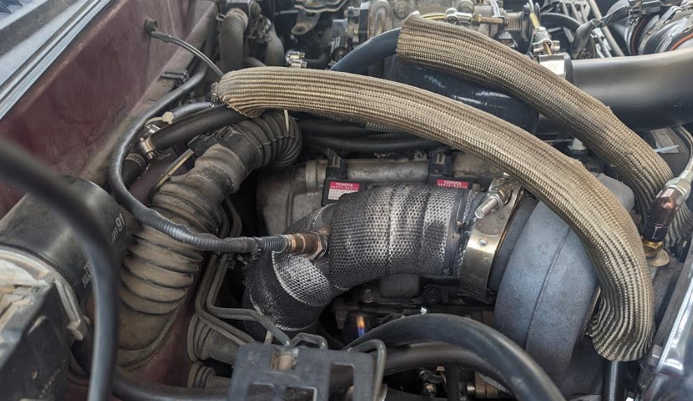

    Which brand and grade of oil are you using? I'm switching to one with a higher zinc and moly content, see if my wideband ends up hating it or not.

    That O2 bung was pretty close to the turbo with the CX down pipe right? I guess that's the only benefit of having to build my own.
    You mentioned in the Turbo BS Thread that the AFR's are hunting a little bit. I'm guessing it's probably fairly similar to mine where it bounces between low 14's and 15's

    yup exactly, its pretty much just behind and a bit above the turbo, so seeing a lot of heat. Your running the innovate to though right? Where did you locate your bung?
    Yea mine bounce around those, but level out after some driving and getting warmed up.

    Is your guys' factory O2 really close to the turbo, that can mess with them.
    Can see mine is at the recommended 18" away. I don't have a narrowband anymore, but the general advice follows for wideband too.

    Yea its pretty close, ill grab a picture once home. I think I measured at the time and it is the 'recommended' distance away if you measure how far downstream in the pipe it is, but its location respective of the turbo is shorter distance. Not sure on Derek's location as he had a custom DP made and I'm using the cxracing provided one

    Sorry, im talking about the wideband location. My factory upstream o2 is further downstream from that down by the firewall just before it bends to the rest of the exhaust out the back

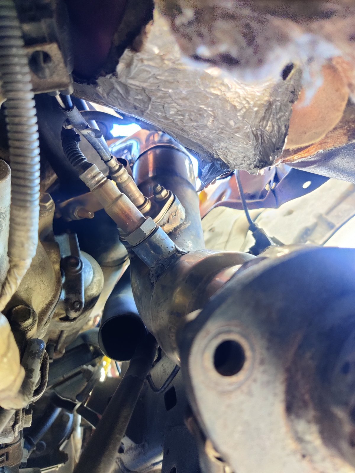

    My guage shuts on and off periodically sometimes several times in a single minute and some times it's good for an hour but every time it does it starts the O2 heater cycle over again and resets the memory. it also doesn't register any boost pressure until 1.2psi
    Here's where I've got my O2's
    Not really the best photos but that's what I can get in the work parking right now.

    oh yea you are much further downstream...
    I was severely off, definitely not 18" from turbo here... maybe 18" of pipe (with all the bends and what not) from the manifold, which is if I recall, wording from CXRacing documentation.. but clearly not 18" from turbo... relocation it is at some point.
    You possibly have some wiring gremlins with your setup? Mine resets maybe once or twice a month, definitely not as much as your experiencing.
