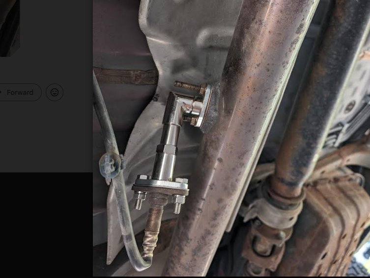

    Welp, I put the o2 extender in and have driven about 90 miles now. P0420 has gone away, but now pending P0136....

    It's less Tacoma and more mod
    Might need to make a tiny leak like a 1/8" hole so there's a tiny bit of gas flow
  5. Jun 16, 2024 at 12:55 PM
    #685
    GoJo
    GoJo Well-Known Member
    Mar 6, 2014
    #124740
    546
    Utah
    in the extension?

    Maybe just flip that thing 180° so it's pointed up a bit first.

    ok ill see if I can, will need to massage the heat shield up and out the way I just flipped it down that way as it was the easiest and further away from the cat

    The extender should work, it's whole basis of operation is to slow the response and make the value hover around .5V but sometimes due to placement or flow characteristics it'll get nothing and then the value will be around .05-.1 and the computer will see that as a failed sensor. That's why you may need to make the tiniest hole so there is just a little exhaust gas flow in that pipe, but try reclocking it first

    Angling it 180 from what it was isn't happening. There just isn't enough room with the length of that extension and how high and tight I mounted that exhaust/position of the o2 flange, I even removed the rear exhaust mounts to maybe get it but even with that there just isn't enough room. Best I could do is cut down the mounting stud towards the cat and make it parallel.
    Where about would I drill a hole you think, about where the o2 sensor sits within it?
    For now I have just moved it 90 degrees the other direction, so its angled toward the cat now instead of away...

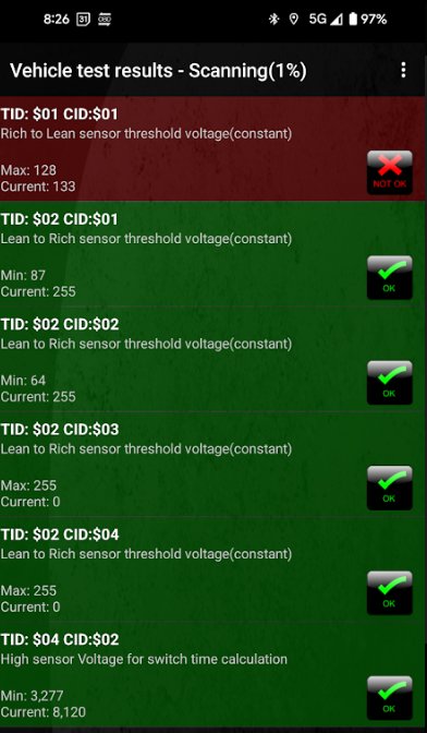

    Well within 50 miles I am already back to the P0420 again, with the stock dual cat test pipe... I'm at a loss now. I figured for sure the dual 2 cat stock set up would pull me under the max value below, as with the high flow set up I am running it was returning a 158 value.

    Well it looks like it at least brought the number closer at 133 (I have no idea what the numbers mean)

    yea I have no idea what those units are either. Going to check for exhaust leaks again tomorrow by hooking the shop vac up to the tail pipe and some soapy water. Hoping I find something that is enough to get those units down below the threshold...
