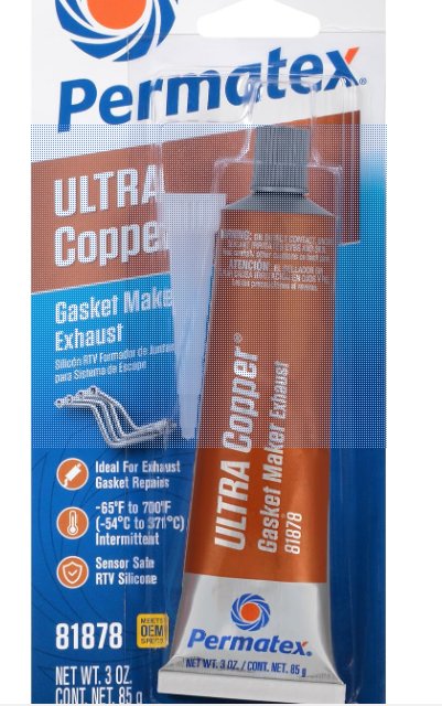

    Yea, had a pretty bad one on that driver side crossover connection. Through some cooper gasket in there to hopefully make it better... also had leaks at both sensors so gasketed them up as well. Haven't driven it yet since that but will hopefully have better numbers tomorrow! :)

    I hope you see improvement.
    Getting those to seal is probably going to be the key to the P0420.
    The CX Pipes are definitely not ready to install out of the box. I spent forever on the drivers side flanges and that was the "easy side"
    What type of copper gasket did you go with. I was just thinking about the spray can stuff I bought and never used
    I tried to use different C clamps on the crossover pipe but none of the ones I bought seemed to fit very well compared to what came in the box. Keeping them in place while tightening it down is a pain with the (not so) flat flanges.

    I used this: upload_2024-6-23_18-24-55.png
    I have the spray too but figured the sttuff pictured would be better to apply heavier coat.
    As for the CX stuff, yea I should have been better about getting them sured up but working with the limited space we have it was hard. Definetaly have thought about pulling the engine at some point in the future to possibly weld it all together to make sure there is no leaks :). My wastegate flange also has a bit of a leak as well, but letting that one ride for now as I only have those 5 units more to get under the threshold.

    The flanges are nice and thick so it would be easy to weld that shut, was one of the first thought I had when the Doug Thorley headers were leaking. how often do they need to come off anyways

    Welp, no dice on my emissions. Failed again this morning, sealing up those joints didn't do anything... 137 units of 125 now so got worse essentially... bit at a lose now.
    Still have a bit of a leak at the wastegate, which makes me wonder if that is why I get some AFR hunting at the beginning of each drive... but maybe its enough to cause the P0420 I'm getting as well. The sensor was known good last year when I passed stock, so I don't think its a sensor issue. Just too many variables and anything im trying doesn't seem to do much at all...
